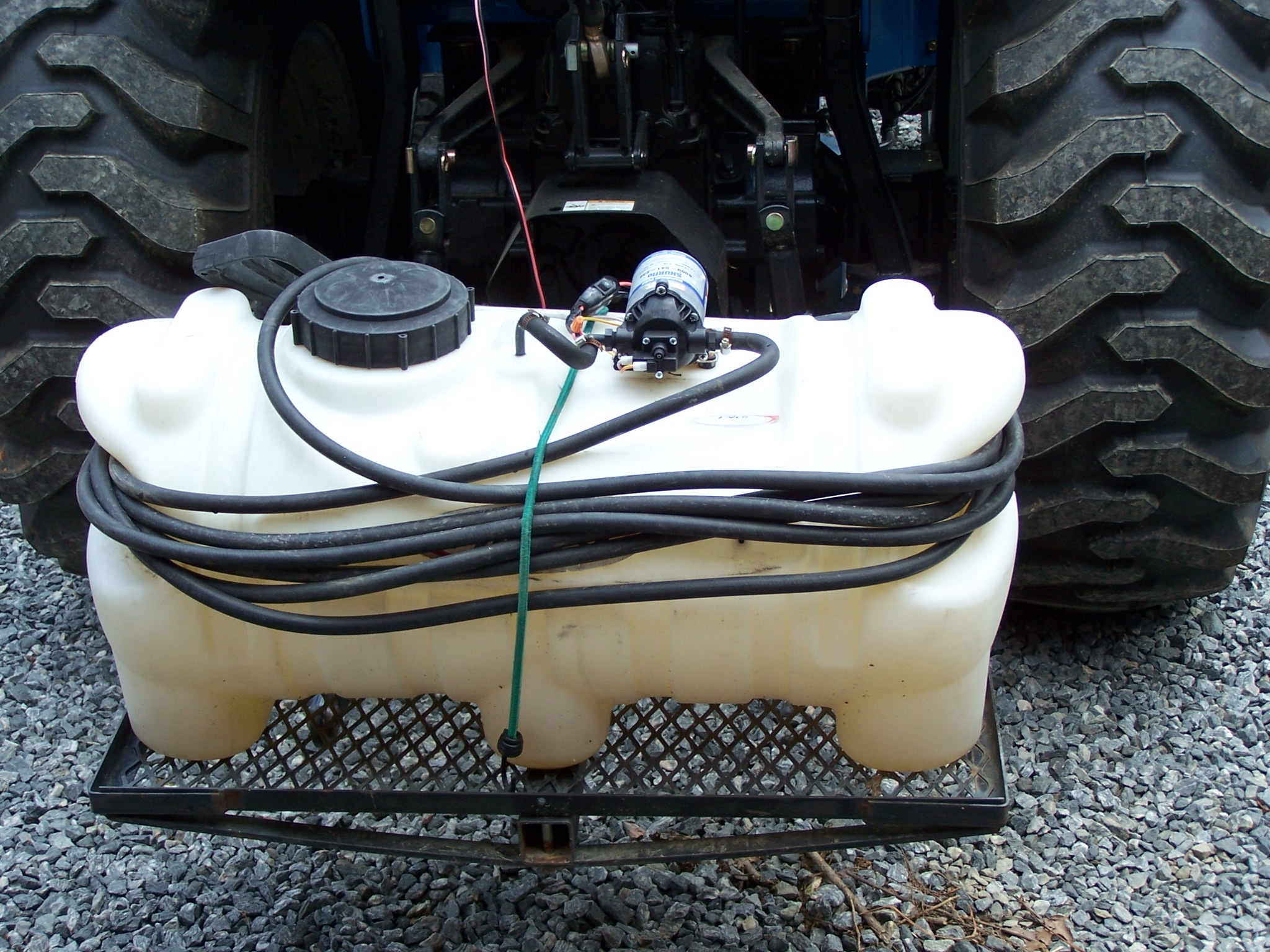

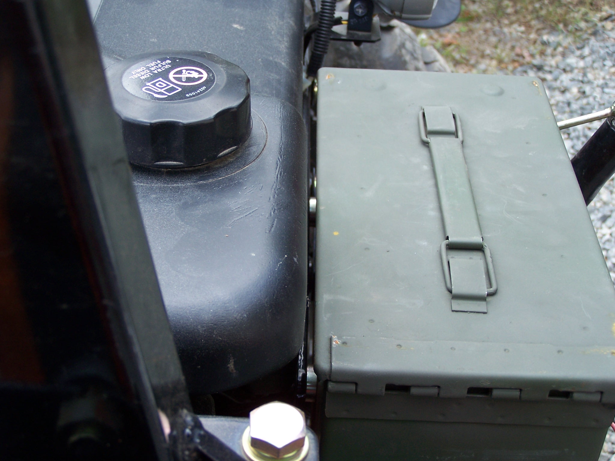

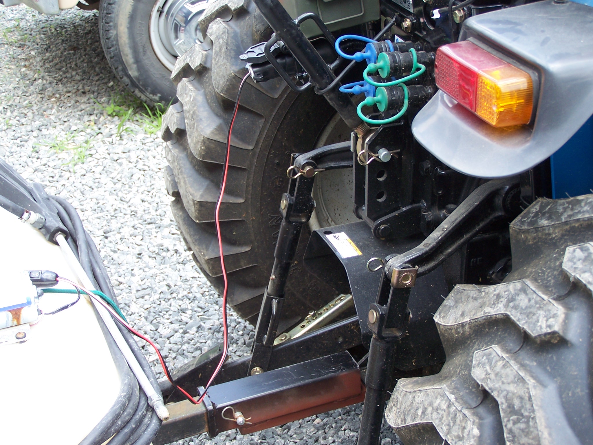

I found a place for a toolbox. A 50 caliber ammo box is perfect. I used existing bolts in the rear. Placed 1/4" spacers between the rear plate and the box for lid clearance. I also attached my 25 gallon sprayer mounted on a cut down auxillary carrier for a receiver hitch. I welded a 2" tube to the drawbar. I also change the trailer connector from the round pin to the flat pins using the existing harness. Now that everything fits I'll take it back off and paint everything and weld up the holes in the box that I drilled on the wrong side.:eek:
   / Some customizing
I wanted to mount mine with the opening towards the outside but the latch didn't clear the fender. That's how I ended up with the holes in the wrong side.

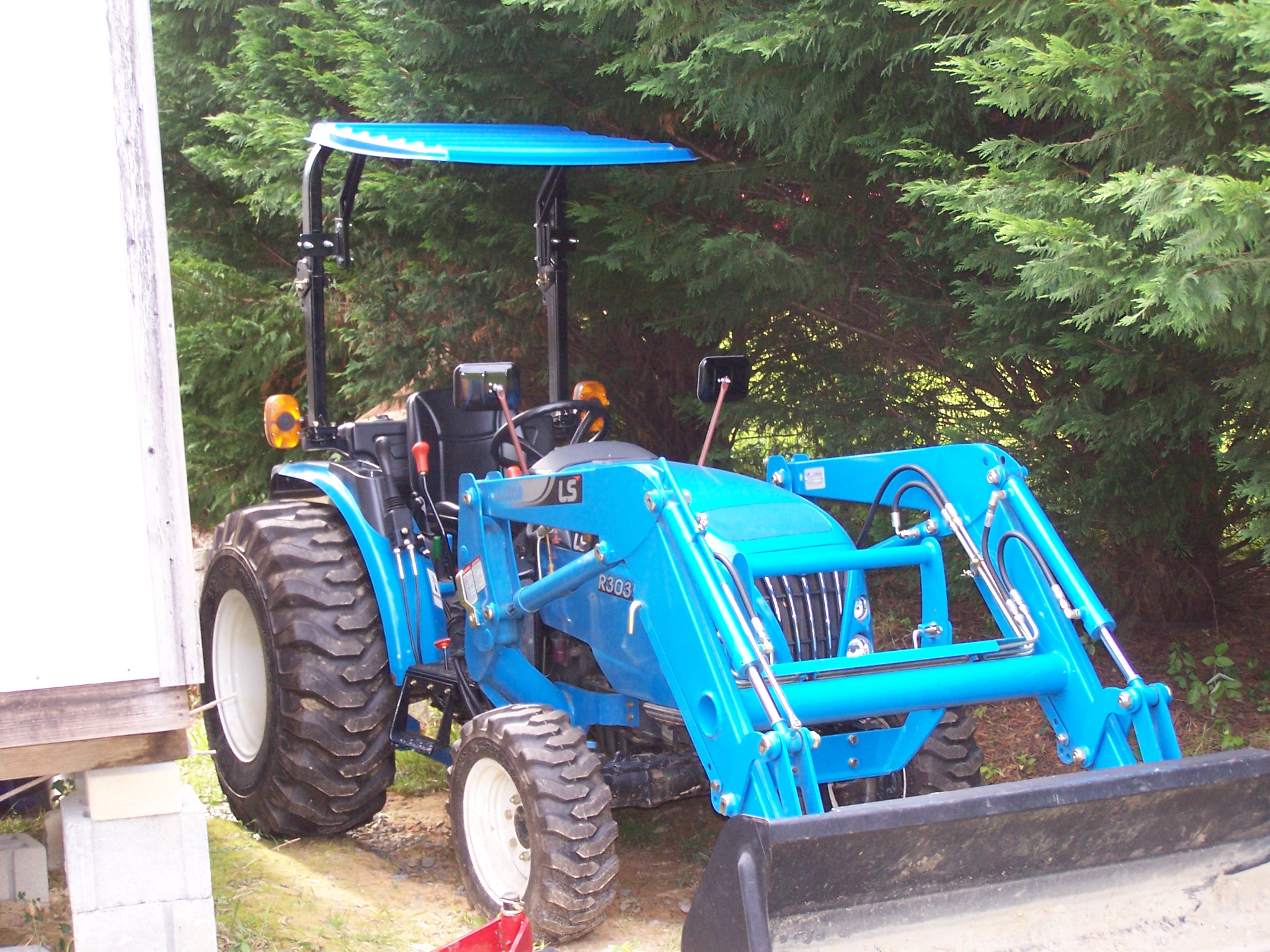

Added a canopy and some mirrors.
