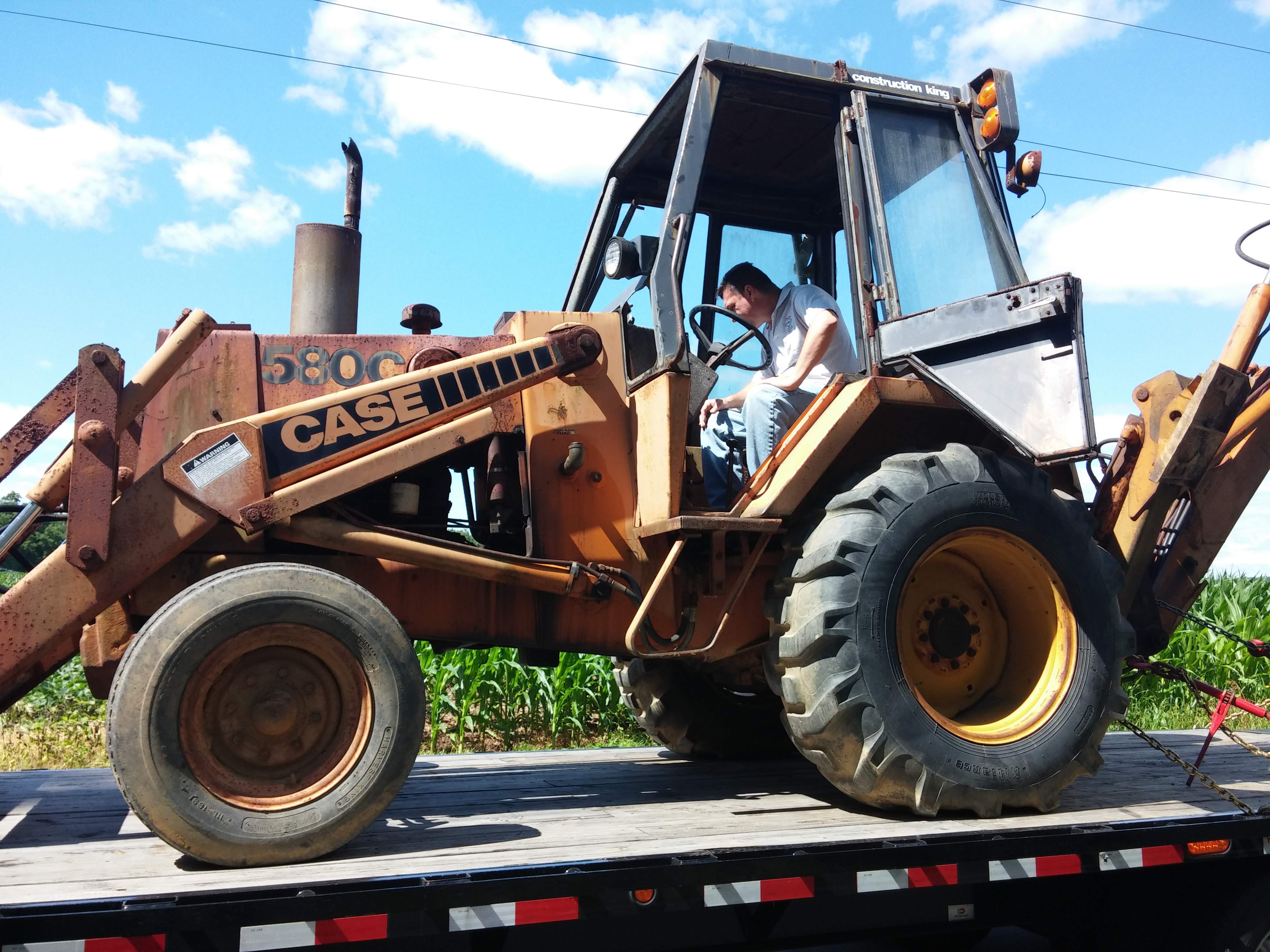

I have a (new to me) case 580C Backhoe / Loader Serial Number: 8984780
Several questions for you guys as I rebuild stuff that was abused or broken on my new baby. 2014_0704_154202.jpg2014_0704_154122.jpg2014_0704_154012.jpg
1. My power steering cap does not have a dipstick on it. To buy a new one just for the dipstick is crazy. I will have to make a little tool and go fishing for it, but in the meantime if someone could please measure theirs for me and tell me at what length the marks are on the dipstick; I would be most grateful. With the information I'm hoping someone can give me, I can make a dipstick for myself if mine is truly gone and not just loose in the reservoir.
2. My power shuttle button on the floor is not working. It won't press. I assume this is OK until I get a chance to fix it. My tractor moves properly with the hydrostatic drive handle on the left of the steering wheel, so this button would only really be needed if I was traveling on the road or something and wanted to shift gears while moving. At least that's my understanding. So if you guys could confirm that it's OK to leave this item go for now that's great.
3. I don't appear to have any Diff button or switch near my gas peddle. Did some models just not have one of these? If I did have a button and it's gone now, can I tell which "mode" my tractor is in right now? Like if I lift the back tires off the ground and try spinning one tire by hand will the other go the same way if it's in DIFF mode "ON"? I will try to remember to do this test tonight. Also is it bad to leave it in a certain mode for extended use?
4. I have rust (yes rust) flaking off of the inside of my fuel tank spout. This thing must have sat around for quite some time without being stored properly. The rust isn't too bad and I'm hoping it's just up on the neck of the gas tank and not all over inside on the walls where it had condensation over the years. I was going to take a "narrow space cleaner" nozzle and carefully suck the loose flakes off of the inside of the neck but there's no good way I know of to get the loose rust flakes out of the tank. My only thoughts were to fill the tank and siphon it out filtering it repeatedly to try to remove as much as possible. Thoughts or suggestions here are welcome.
5. If you look at my 3rd pic you will see that the backhoe bucket is set up right now with the link pin in what I believe to be the more "powerful" digging position (the lower hole). Am I right in this assumption that the lower hole will provide less swing radius of the bucket but be the more powerful setting? If I swap it to the upper pin position I should be able to nearly close the bucket against the dipper arm but I believe it would then be less powerful for digging and break-out force. If someone can clarify this for me I would appreciate it.
I'm sure I'll have a lot more questions as I rebuild my new baby. So I will post here as I go along. My first task is replacing the master cylinders. They are both shot and I have ZERO brakes. No emergency break either. So I have to fix that after the hydraulic brakes are fixed.

Congrats on the new toy! I grew up running a 580C so its been a few years but I think I can help a bit.
2. The handle on the left side of the steering wheel is not a hydro-static drive. Its a direction shuttle. It only controls forwards and backwards directions. I'm thinking the button on the floor is actually the diff lock. I'm stretching my memory a bit here though. The only way to change gears is to stop the tractor and shift the floor stick into 1-2-3-4 then stand on the throttle.
5. I believe that the pin placement in the bucket has less to do with digging power and more to do with the intended use. I.E. Trying to dig a vertical wall or trying to load into a truck. Each would require the pin in a different position.
If there were several variations, disregard my comments about the difflock. You should get handy at running the hoe with one hand and steering with the brakes or front tires with the other while you push your self out. If you have never ran a 3 stick hoe (in this case 4 with the e-stick) your in for a learning curve. Its not that difficult when you get onto it, but making it look fluid is challenging.
BTW, we love seeing people's projects sitting at our computer!

The dipstick on my 480C, which should be the same, is 5-1/2" long, from where it rivets on, inside the cap. Low/add mark is @ 5". Full @ 4-1/2".
If you're meaning differential lock, mine is a, approx. 1" diameter pedal near the foot throttle. If the diffy lock is engaged, you'll not be able to steer well. If it turns easy, then it's unlocked. Mine was frozen up where the linkage underneath the floor pan goes into the housing. Took it off, and used some solvent to get it freed up, then removed, and coated well with never seize, and put it back together.
If that one has been frozen up, possibly a PO just removed the pedal when doing some work under the floor panel. There is only like a 1/4" bolt through the yoke to hold it on to the linkage below. You should be able to look underneath on the right side setting on the hoe, forward of the brake housing to see the diff lock. You'll see a bell crank attached to a 1/2" or so shaft going into the diff lock housing.
Might be an idea to find an OEM repair manual for it. I found mine, a near new one on ebay. They are very detailed, and take you through repairs step by step, with actual pictures.
You can find parts at Case Construction: CASE Construction Equipment | Heavy Equipment | Case Construction. Click on parts in top menu, and do a search by model number. Select which 580 you're looking for. Select your model, then look for parts by section of the machine. If you select a dealer near you when getting started on those pages, it will give you the price of said part. You can copy and paste the number to a search engine, such as Google, and check pricing on aftermarket parts.
I bought most of my aftermarket parts from here: Remanufactured Transmissions, Torque Converters, Engines - Joseph Industries Quality parts, & friendly, knowledgeable, person you'll be talking with.

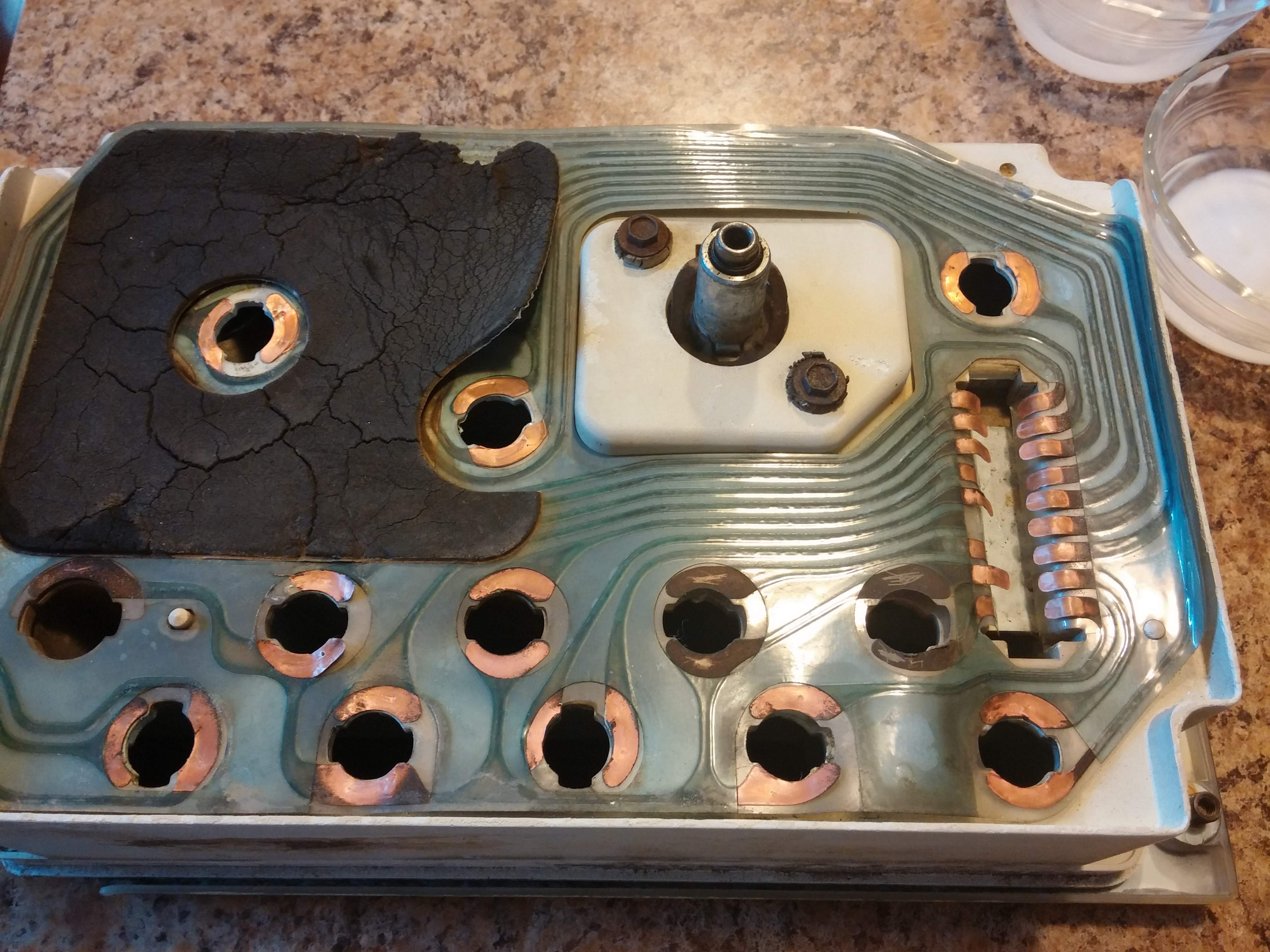

OK so here's a techie question for you ...I took my old dashboard console out and stripped it down, cleaned all contacts and checked all gauges. I was quite surprised (and pleased) that everything still worked. All lights, all gauges, EVERYTHING. The biggest problem is that the old (paper thin) printed circuit "board" (if you can even call it that?) on the back of the panel is becoming embrittled. I've already broken off 2 of the little tabs where the 18-pin connector plugs in.
The only thing that I can think to do here is re-route everything with manual wires but that seems painful. I may consider clipping the wires at the connector head so that it can stay plugged in permanently from here forward; thereby preserving the fragile state of the circuit board. I could then attach one side of a new 18-pin connector to all of those loose wires and obviously connect the other end of the cut wires to the partner of the new 18-pin connector, being sure to make all of the original pathways available. Then I would just de-couple at the new 18-pin connector if I ever need to work on things and the old connection would stay installed and safe. Seems like some tedious and careful work but I'm not sure what else to do. Suggestions are most welcome here!

fiddling with a couple wires, ok, but redoing entire dash... i would see how much it would be for new circuit board.
those couple tabs you broke off, you might be able to remove the clear insulation of the wire, and then do a little bit of a soldering job. and by pass the 18 pin connector for those couple wires. granted i hate soldering myself. i can do it if i have to. but by no means a pro.
all the connections for lights and switches, looks like they are regular rear light on vehicle and trailer. were ya push in and twist... that there is the rough one.

Yeah I looked at buying the new circuit board and they don't sell it separately from what I can tell. When I called Messicks, a local dealer here, they quoted me $850 for that console as a unit. I was like OK NO Thank you! I will solder or run wire for the messed up tabs. I think my idea of running a few wires manually will solve most of my issues. But if I ever need to remove that main plug again I risk breaking even more tabs.
I will have to play around with more ideas for that. But no way I'm spending 850 bucks for the console!
