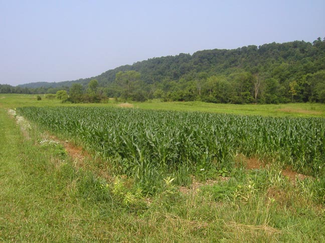

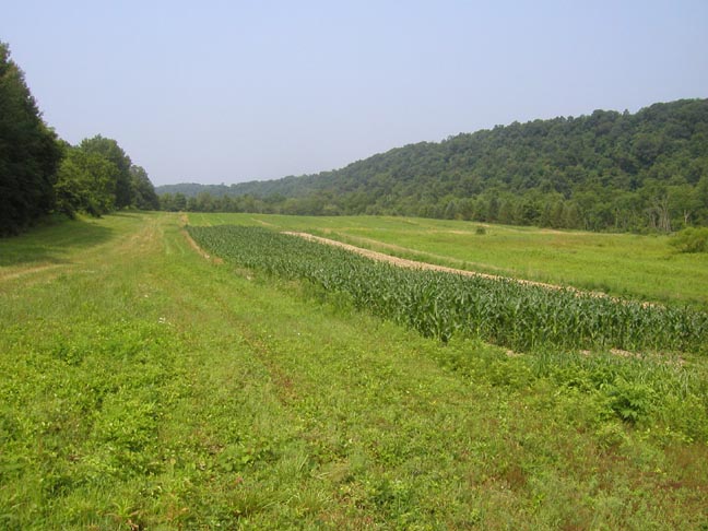

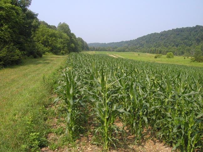

Corn is coming along nice, some starting to tassle, and if I can keep the deer and coons away might have some to sell.:) The planter that I use might not be the fanciest but it does a good job of getting the seed in the ground. The liquid pig manure didn't hurt either. I had to spray postemergence because of the very wet spring and hopefully can do pre again next year.
I planted Siver King, Incredible, and Ambrosia, all popular varities in this area. King is white, Incredible is yellow, and the Ambrosia is bicolor. They are all Se., which means 30 to 35% sugar content.
