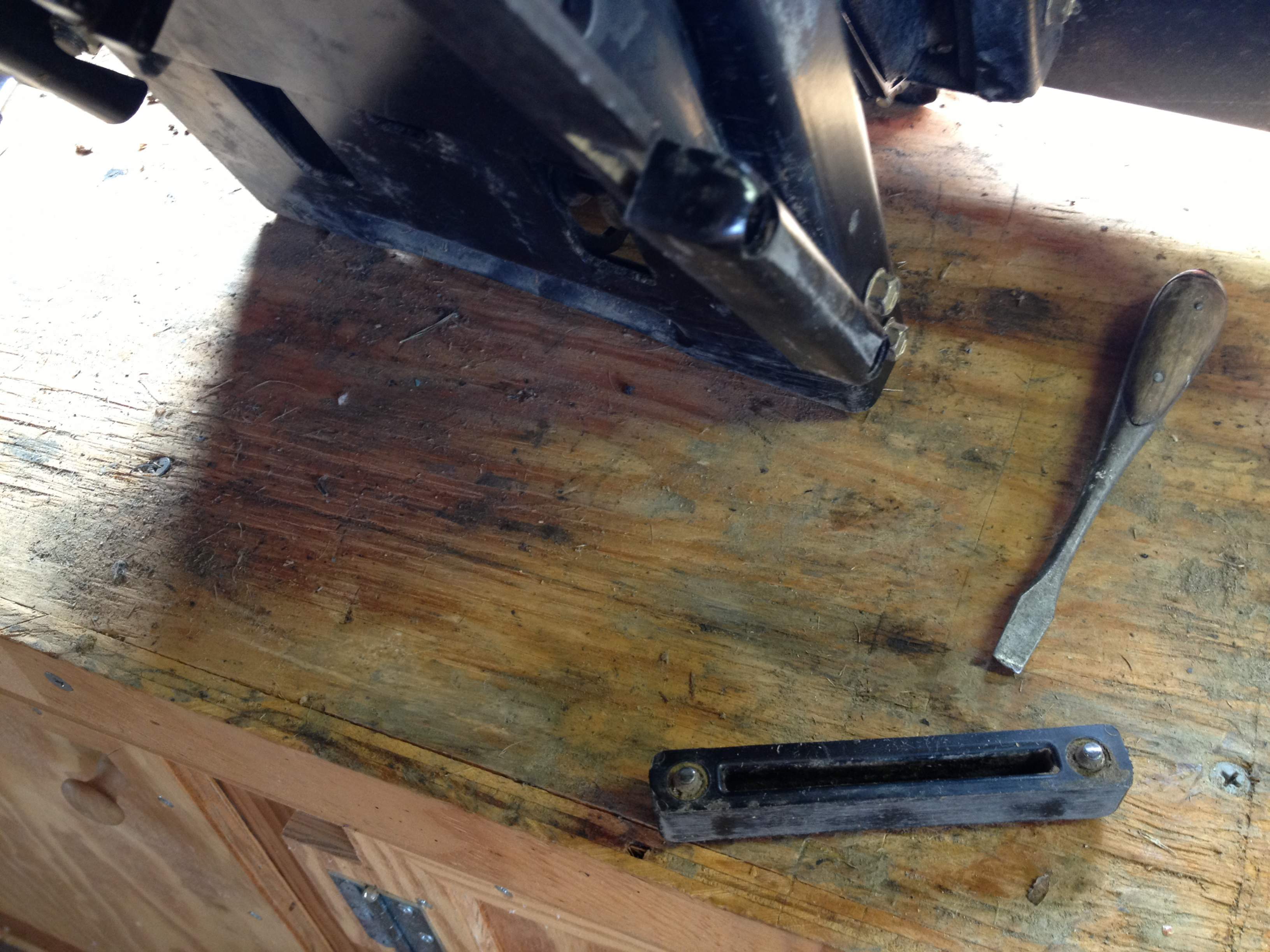

I've had my Class III Boomer (TC35D) for about 13 years now; I'm just shy of 1,500 hrs. Mostly I do mowing with a rear discharge mover but I also move heavy wood pallets with my loader, plow snow, grade our road, drag the fields, etc (the 16LA is a BEAST). Anyway, little things here and there have stopped working over the years and this past weekend I told myself to make her like she's brand new.
Problem 1 the seat.

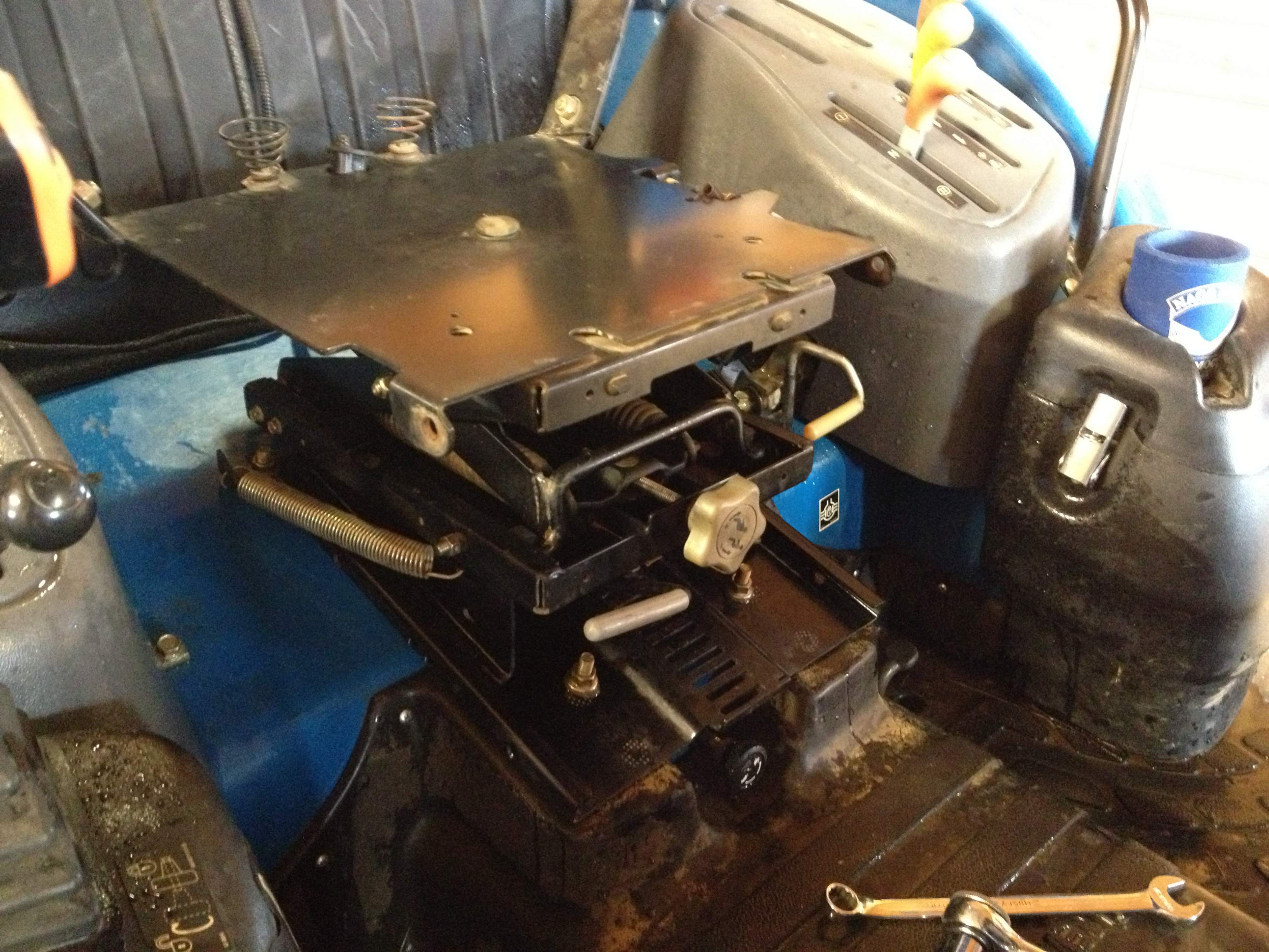

At the time (year ~2000) the Class III Boomer seats was one of the most comfy seats around; lots of travel up and down back and forth and it even swivels! But over the years mine felt more and more sticky (like it would compress to a position and just stay there) plus the fore and aft travel was binding. Time to take this puppy apart. One thing I noticed is that I had used white grease over the years to lube the seat. In retrospect this didn't seem to work so well. The white grease dried into a kind of "gum" and really bound up the seat travel and adjustments.
Pic #1 Notice these sliders (they allow forward backward travel of the seat). The one on the top has some pins where the lower one does not (there are a total of 4 sliders). The pins allow you to adjust the play from left to right. Be sure to use the pinned sliders on the same side otherwise you'll likely bind the seat. I cleaned everything with carb cleaner to remove all of the old grease.

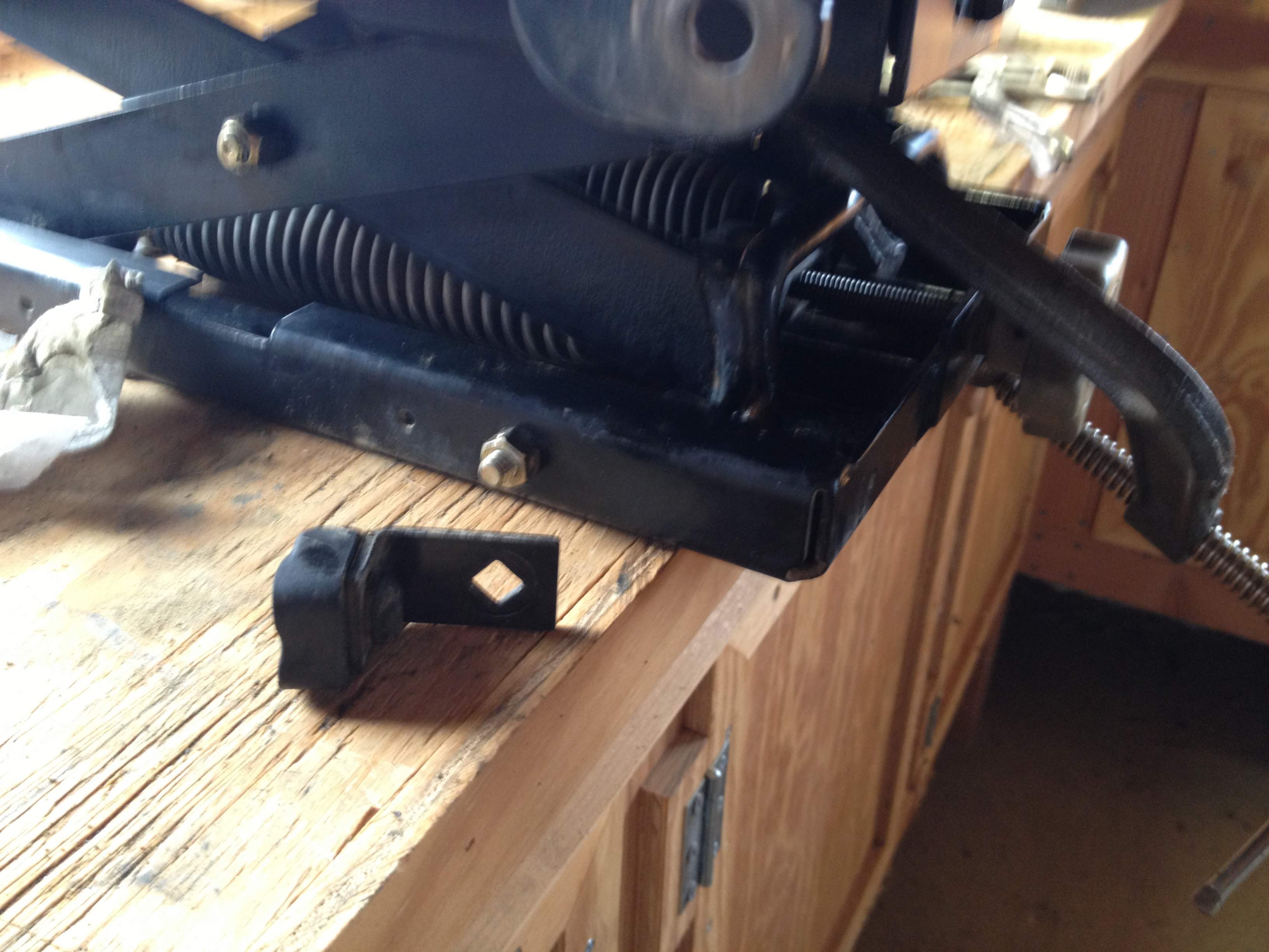

Pic #2 Even with light tension on the springs you'll still need a clamp to create enough room to reinstall the stoppers.
Pic #3 When I reinstalled my sliders I flipped them over so the smooth part is down; I figured this would make it easier to slide the seat fore-aft. I could have buffed or cleaned the scratched side too.

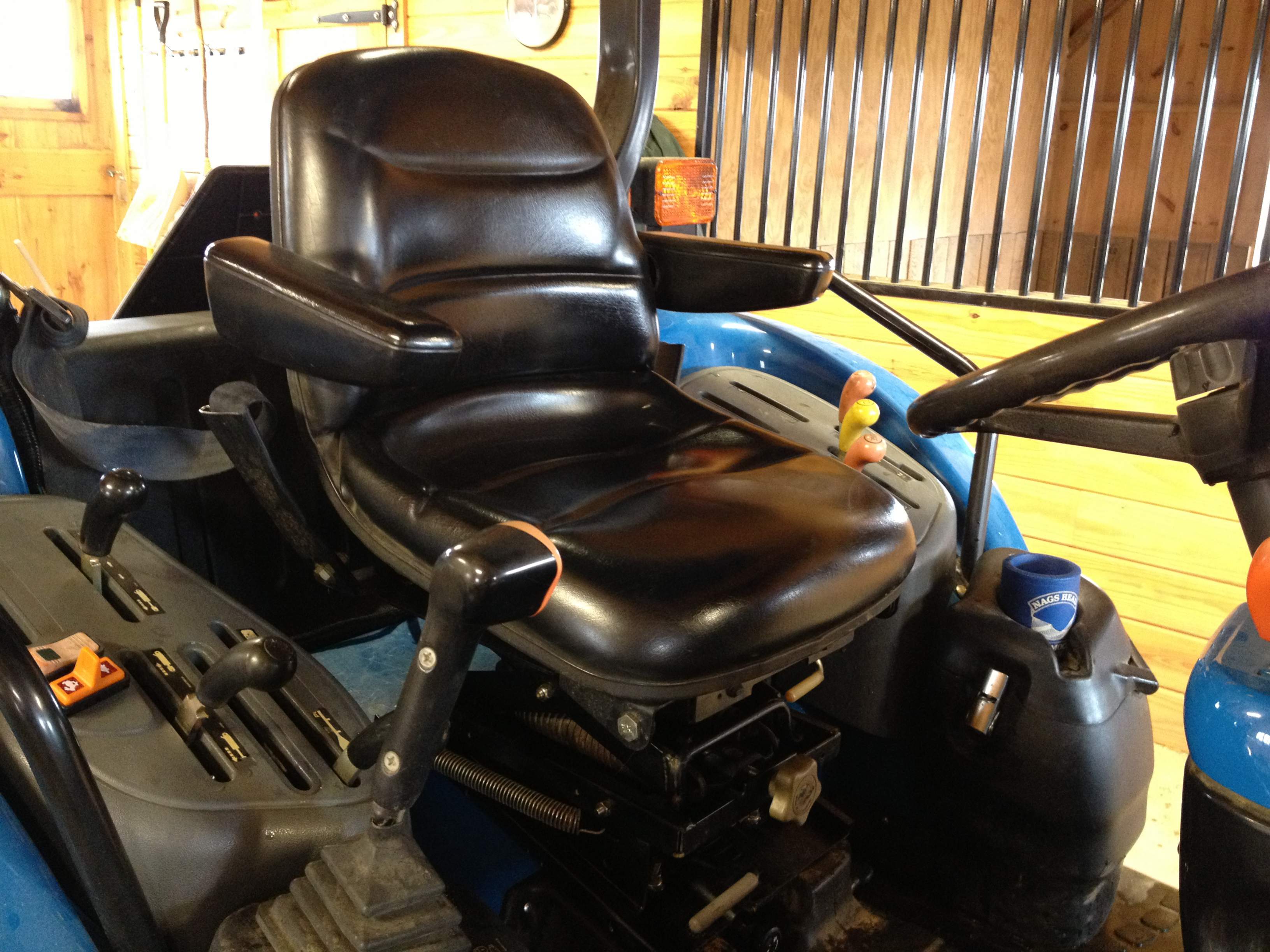

Pic #4 Installed back on the tractor. You'll have to lean forward so be careful not to tweak your back (the assembly is heavier than it looks). While the seat is removed maybe check the top of your transmission/rear diff for grease, loose bolts etc.
Pic #5 Fully installed. The seat is like new now. Very easy to adjust back and forth and the travel/shock absorption is back to new like.

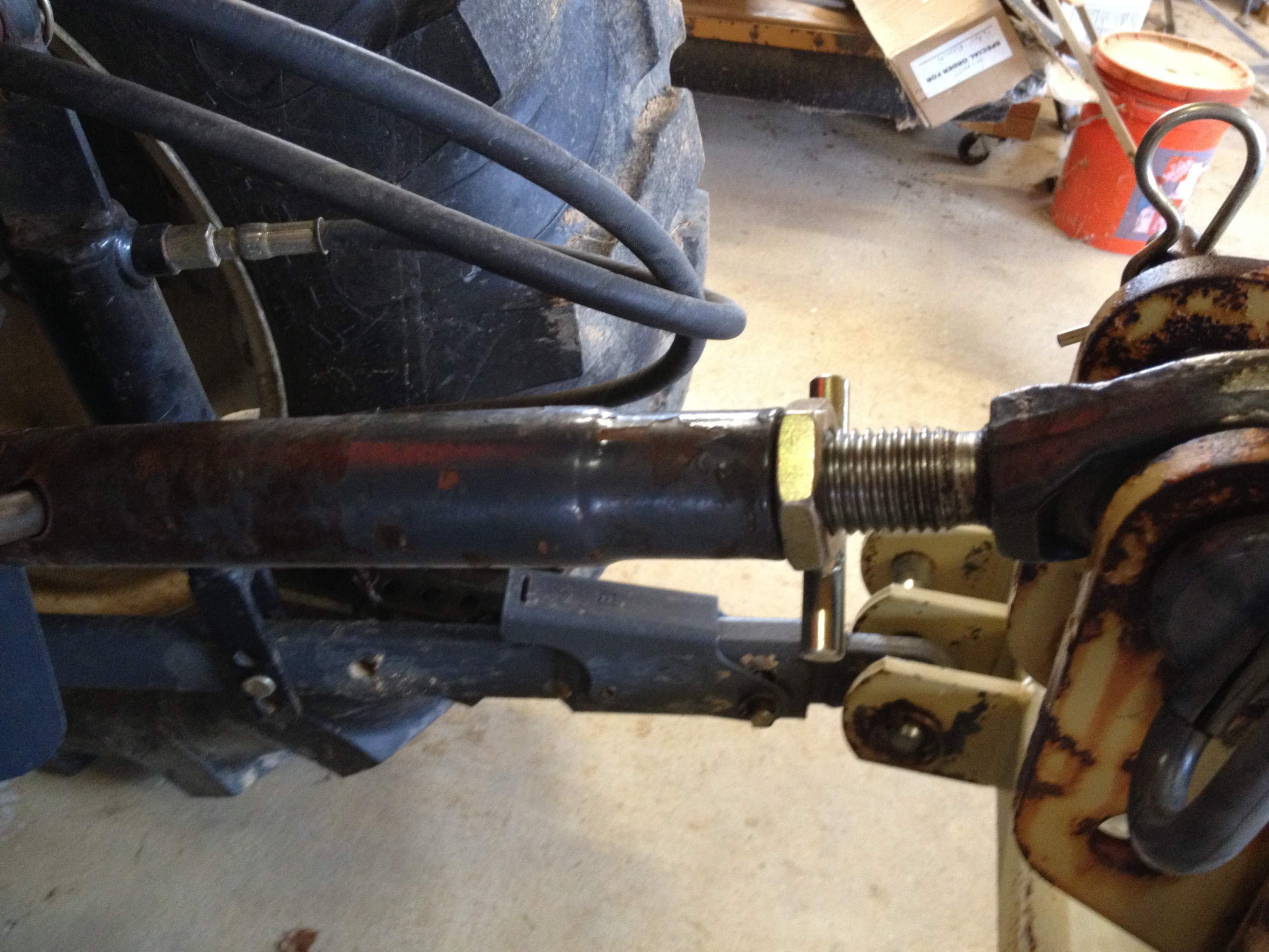

Pic #7 Long ago the tabs on my toplink locking ring got sheared off. This is a major PIA because I use the locking ring all the time and now I need a wrench to adjust the length of the top link (and I always forget the wrench when I'm out in the field). New one installed here; no more tools necessary. More carb cleaner to get off the old grease.

A few parting thoughts. I'll never grease the top link again. The old grease never gets expelled and it just hardens to a gum making it difficult to adjust the length of the top link. A little WD40 now and then should take care of any rust/lubrication. I'll also use WD40 on the seat vs white grease (no more gumming up the travel).

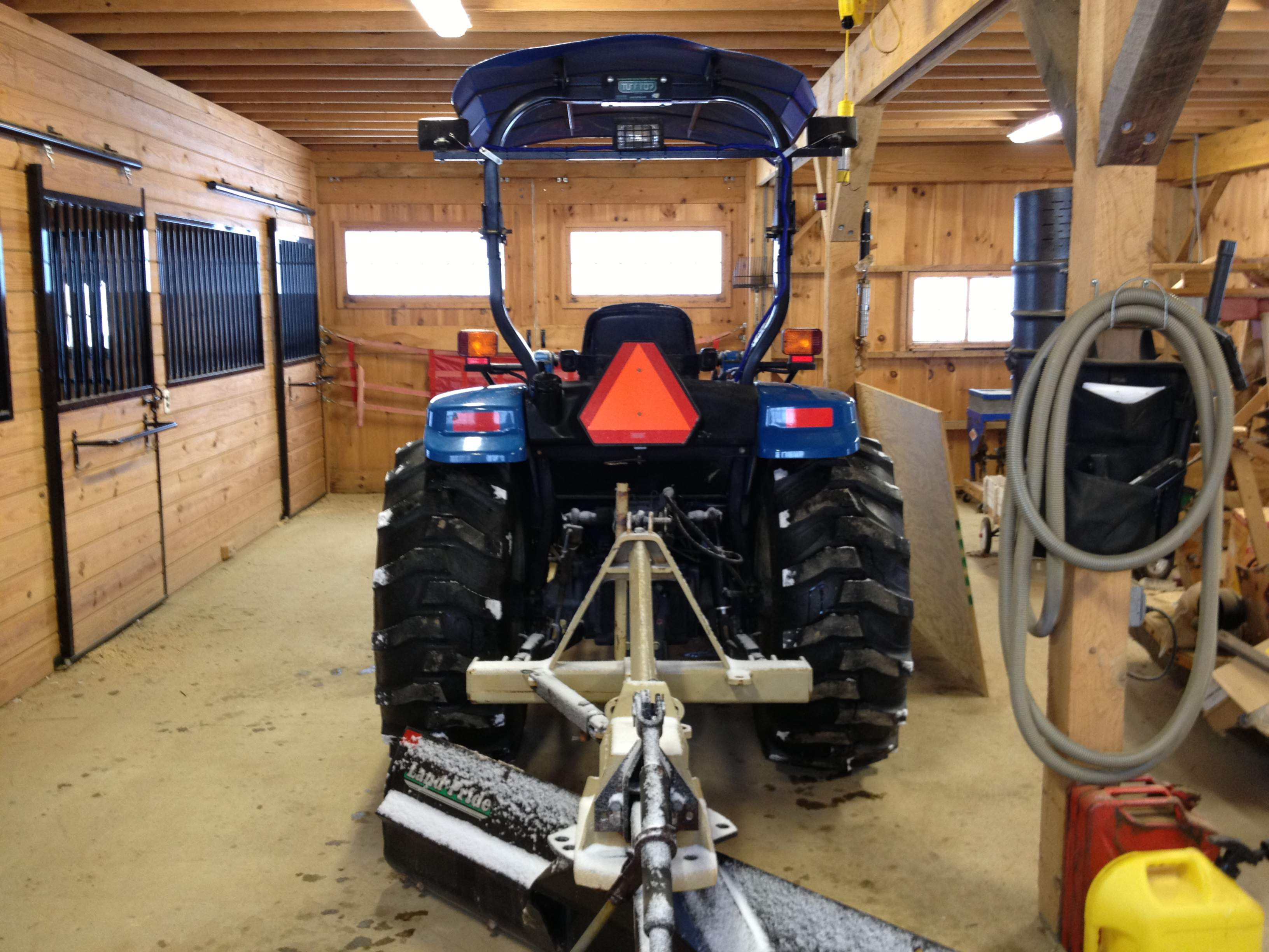

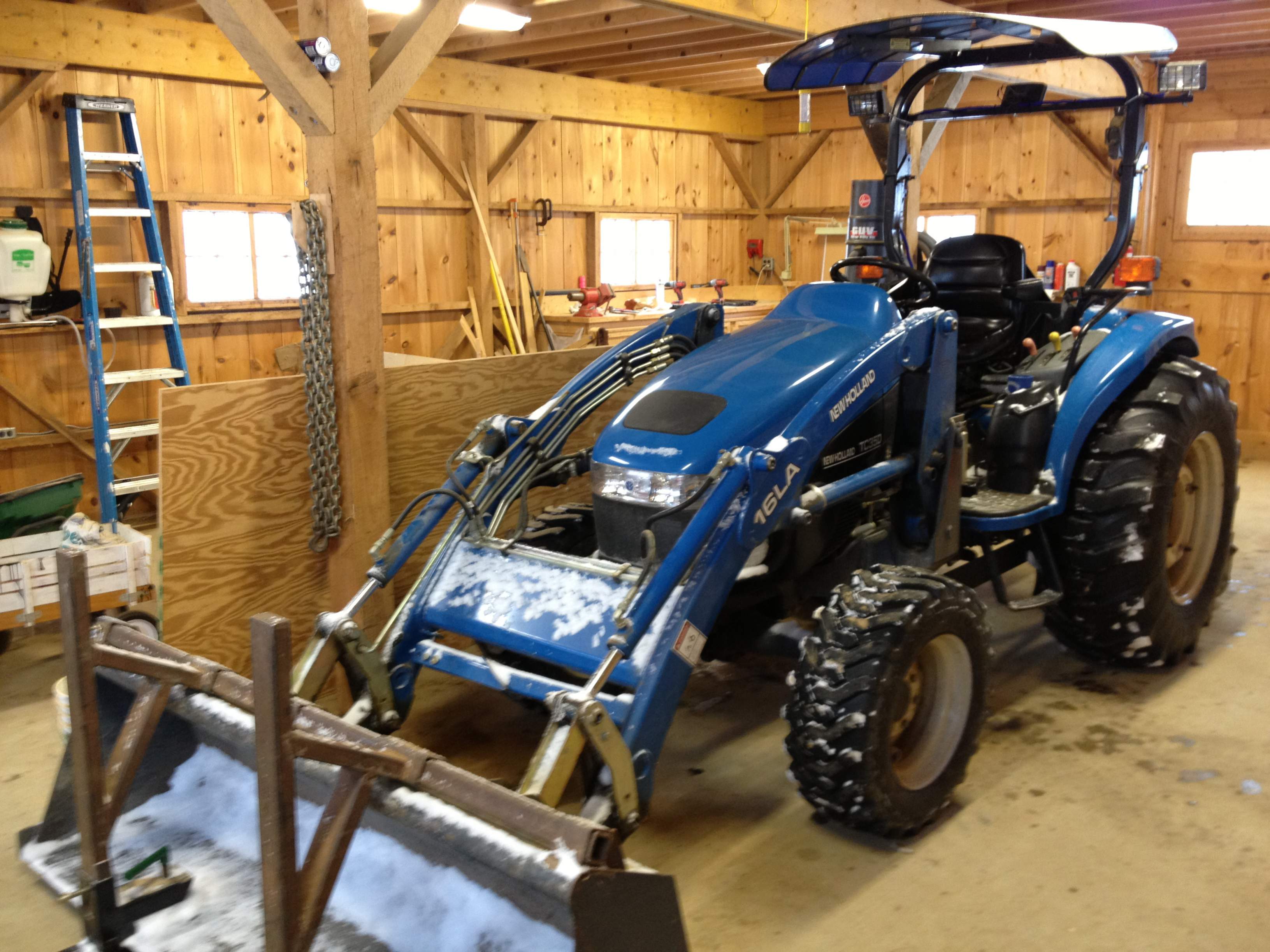

Good to see you again Jinman! I'm like a comet; my interests carry me all over the place but I always come back. Remember when you walked me thru that B plate repair some years ago in the middle of those huge snowstorms here in the east? What a PIA that was. You 'da man when it comes to the repairs/diagnosis. NH should call you for suggestions on the new models. BTW did you ever get your loader sleeved? I didn't but I still think about it. Recently I've been investigating composite PTFE bushings. Basically they are a self lubricating bushing that could be press fit into our loaders and should massively tighten up the loader. Depending on the manufacturer they have a compressive strength of around 20 kpsi (sliding) and 30 kpsi static. Here is one I'm looking at CJ Composite Bearings | FCJ Bearings | Precision Bearing. These come 1.25 ID and at 1/16 inch wall thickness are smaller than the NH sleeves so even if this didn't work I could have the loader machined for the larger NH bushing/sleeve.
How do you like the LB? That must be fun.
Did you notice my homemade loader fork mounts? (actually I just designed them; a very capable welder built them)

i like the roof and spot light set up. it has a curve does snow slide off if left outside? got a foot of snow here last night i just have trash bag covering seat and dash after i replace my starter thats next on my list to do. undecited if i going to buy one or make it

Thanks for the pics Peter. I need to do the same thing with mine.....fix up a few things. I really would like to have your roof and rear lights....WOW does that look slick & functional !! Sure would make blowing snow easier.
