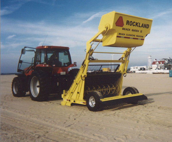

I live about 20 minutes from the beaches of Delaware and Maryland and have seen "beach gleaners" sifting sand in the morning before the tourists flop down for their daily dose of U.V. rays. These units are highly specialized, tow-hehind, and I don't recall ever seeing a manufacturer's emblem on the machines.
The ones I have seen working appear to be ground driven and pull in an 8" deep (?) by 72"-96" wide swath of sand that is filtered and laid back down. I first saw these contraptions at work back in the mid-80's/late-80's when medical waste was washing up on shore in New Jersey, which was the result of "Organized" solid waste disposal companies dumping garbage scows out at sea in the Mid-Atlantic. I suppose people wanted clean beaches before then, but that was the time frame in which I first began to see sand groomers. Here's a link to one such company that offers a tow-behind. From what I can tell, this is not a "personal use" unit. I suppose flotation tires on your tractor using a great-big-'ole landscape rake would pick up the big stuff, including cans and appendages (body parts in 'Jersey, only, of course).

Here's a pic of the "Beach Queen II" with debris bucket hoisted

I have seen units like the Beach Queen in South Carolina and they do a great job. The tractor they were using had the large turf tires on and it worked fine.
