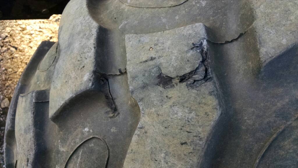

I had a dumb mistake this morning. In trying to set my box blade I had the toplink extended way out and when I raised the 3pt around a turn, one of the box shanks hit my tire. It's not losing air, but anything I need to do in order to keep the tire from suffering more damage? Is there a filler I can use to seal the rips? uploadfromtaptalk1477143011762.jpg

If its just the bar tread thats damaged, dont worry about it. If its cut between the tread bars in the casing area also, as it seems in your picture, that may be more of a concern. I would gently probe it with a dull pick or small bladed screw driver to see how deep it goes into the casing. If its shallow, no worries. If its in far enough to have cut the cords, more tgan perhaps 1/4" to 3/8" deep, just be careful what you run that tire thru that could find an easy way to finish the job of making a hole!
Tractor tires lead a tuff life, and often end up with battle scars. Sometimes the wounds are fatal, doesnt seem to be this time. Run it!

They make a weather check sealer that you brush on to keep water out and help prevent the tiire from rotting from the inside I have never used it but it got good reviews on another site. I think it was sold by Miller's Tire on the net

Contact heavy duty tire shop,almost willing to bet they have something.

I'm not sure if they even still do it but you used to be able to have damaged tires "vulcanized"...it's been a long, long time since the last time I had a tire repaired like that...might check with some tire places...
Good Luck...
