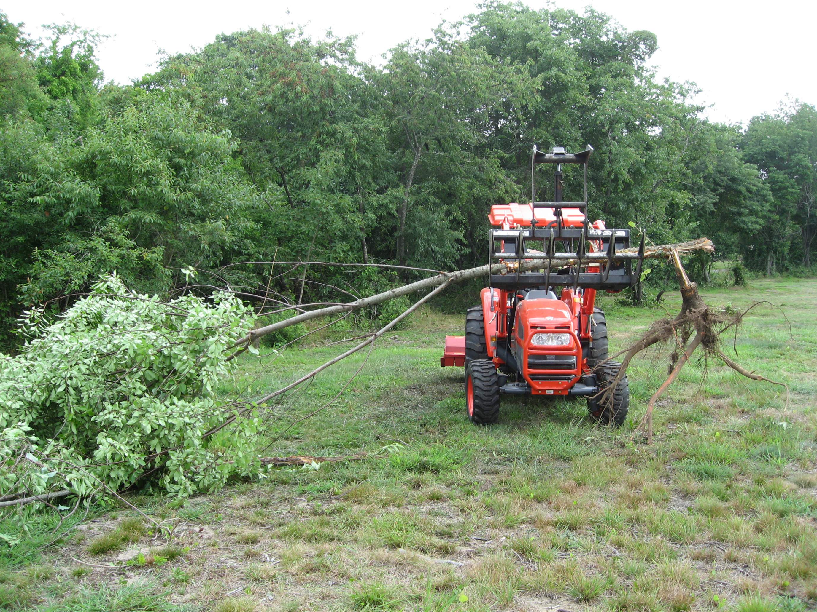

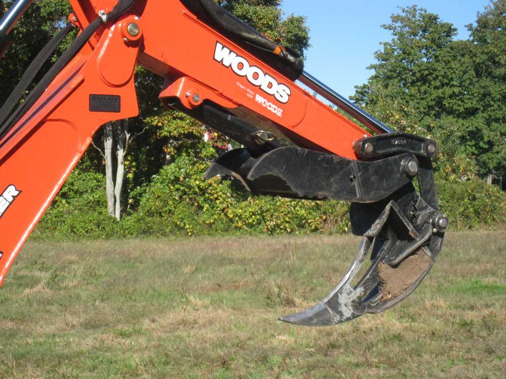

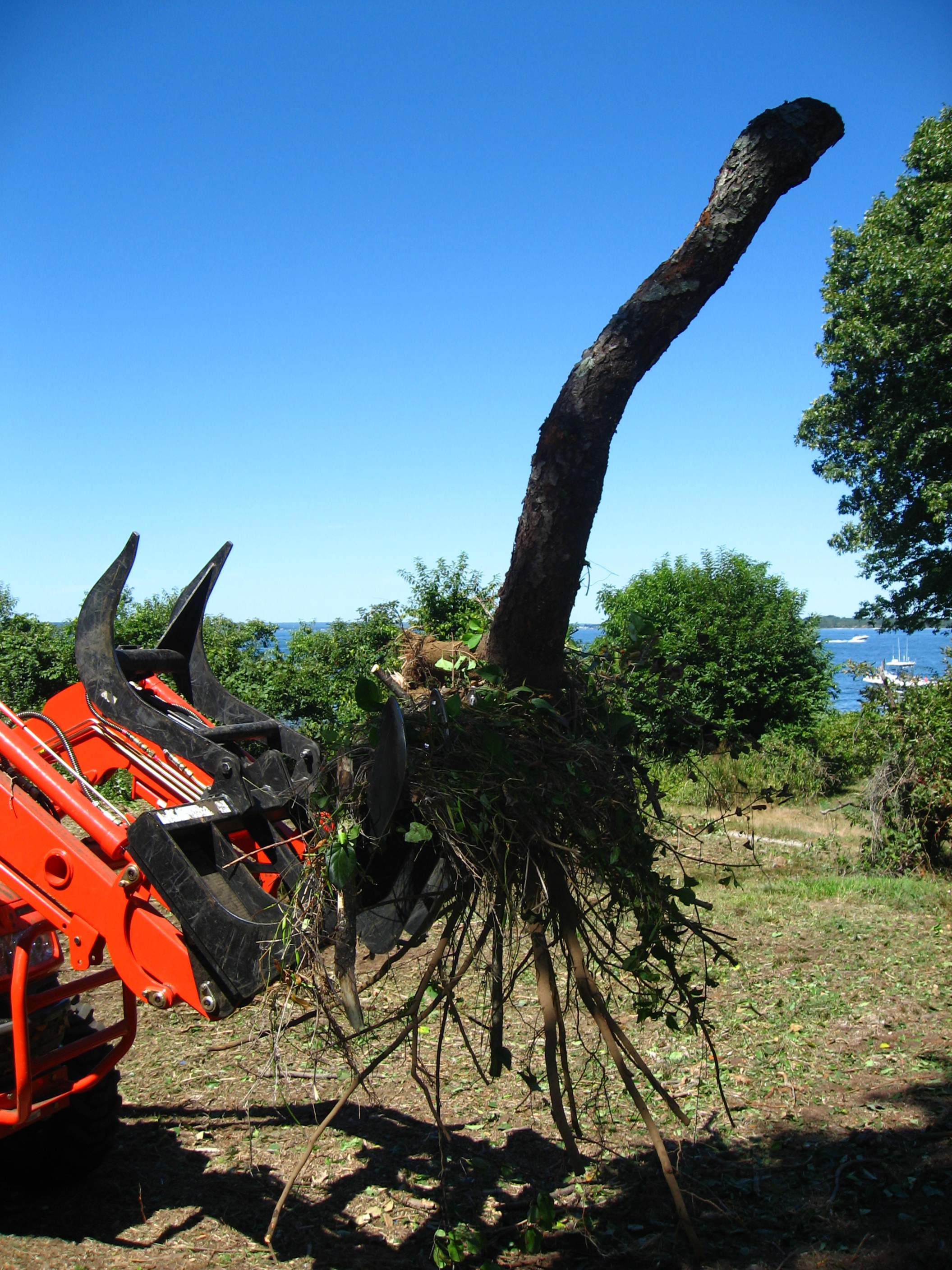

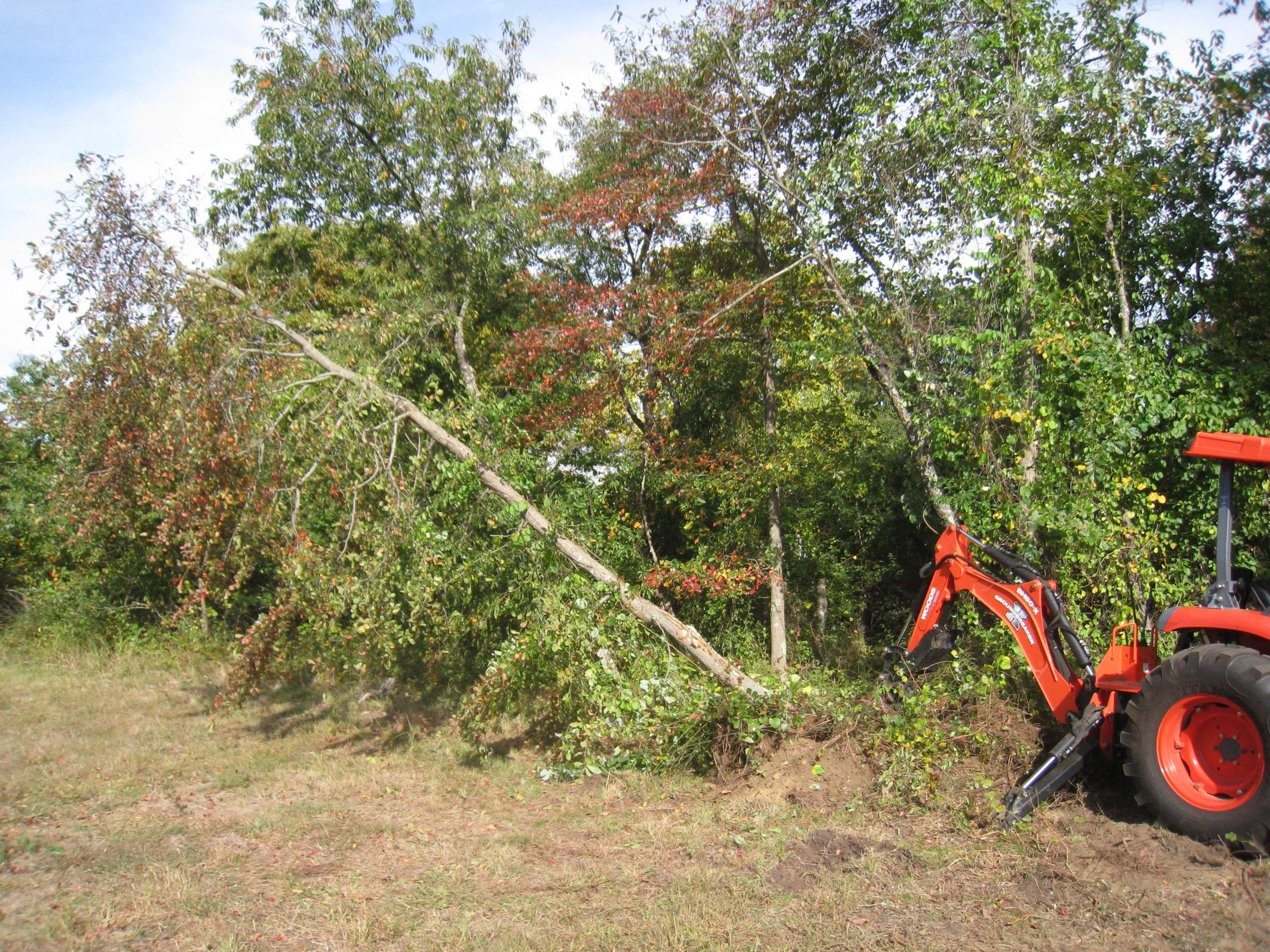

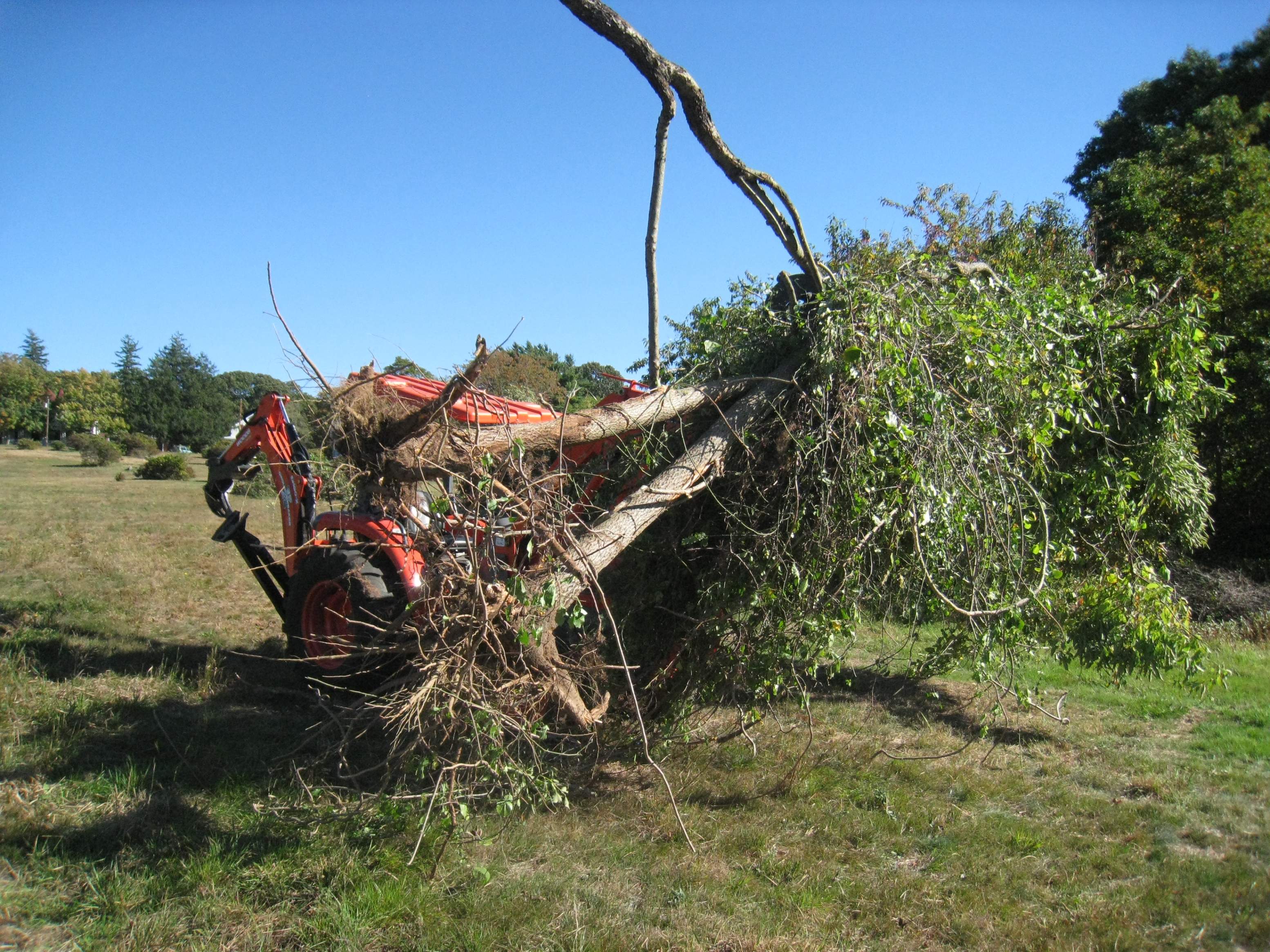

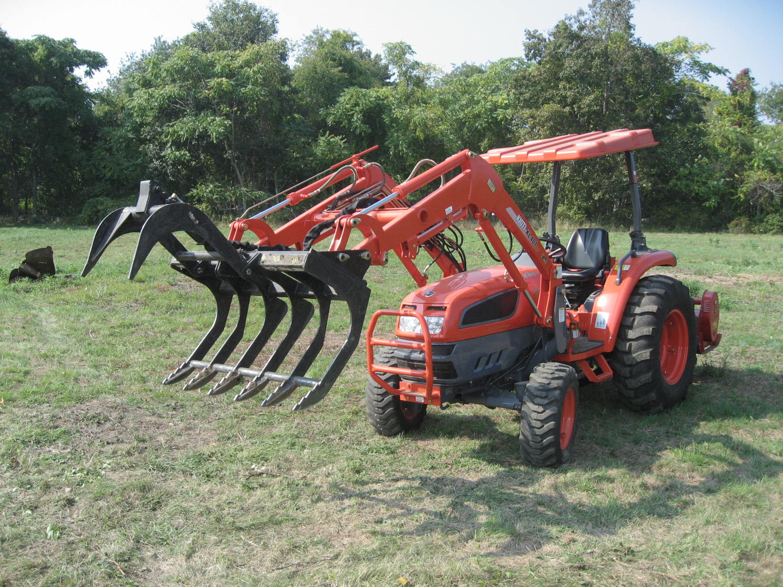

A standard root grapple (look at Everything Attachments 54" single jaw Wicked grapple for about $1700) is probably what you want for dealing with dead pine trees. I would personally dig out the stumps rather than grind stumps down. Grinding takes a long time, is messy and you still have a dead rotting stump below soil that could be very dangerous to horses in the future. Digging out pine tree stumps isn't that hard. Smaller trees (less than 30 feet) can simply be pushed over after ripping roots with the tractor so the stump just pops out of the ground with the tree. Bigger trees can be cut well above grade so you have some leverage on a tall (6foot) stump to push and pull after loosening up the roots with a grapple. To be really efficient you could cut and remove the trees and just hire an experienced big excavator and operator to pop dozens of stumps out in a day (and of course the tractor and grapple could move all these stumps to a burn pile). You might also consider if you have other uses for a backhoe attachment and do the stumps one at a time at your leisure. That's what I did. Easy peasy so long as you follow some safety rules (dead trees ok but not rotten trees that could break).
BTW, my Kioti DK40se in photos below is roughly about the size and weight of the MX5200 and I have a Woods BH90x with ripper on the backhoe.
