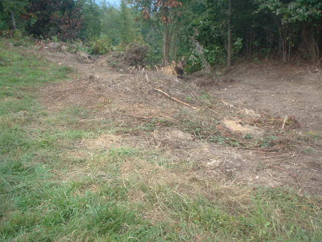

First off let me say that I am still considering a GC2300. Right now this is the only tractor in my price range. So it's either this tractor or no tractor. Now I do not want to buy a specific tractor just because it's in my price range. I want a tractor that can do what I want. Which is where I need your help.
I will be doing mostly mowing, Finish/Rough. But also loader work.
My first question is about ground clearence. will 6" be enough. I'm thinking that for the most part anything that is taller than 6" I can move with the FEL. rocks sticks ect. And I also need to cross 2 or 3 small diches maby 6"-8" deep. my atv crosses them no prob. But I'm also thinking if I need to I can just smooth them out with the FEL.
My second question is. Not just specs. how much can the loader handle. I need to move those piles of dirt in the front in the pic. Those piles are compact dirt and have been there for years. will the loader be able to dig in and spread those piles? (they are bigger than they look in the pic)
my last question is how high can the 3 point hitch raise a bush hog or any implement for that matter.
Thanks for any info in advance.

Chris, I surmise that you are talking about 6" ground clearance with MMM on or is that with MMM of ? I don't think 6" is enough ground clearance for loader work on a bank. When driving over your just dug furrows or dumped dirt to drag the loader backward in smoothing it out you dont want to drag anything other than the blade. The tractor is a good tractor, but it does have it's limitations .
Weight being another one of those limits along with the clearance . You need weight to dig in with a loader although a toothbar would help in that area.
The loader should be able to handle a full load of loose dirt but I wouldn't expect it too break into compacted dirt like a bulldozer and lift it. My 1433v wont lift up if it gets under a good sized root ,but curling the bucket does give a good bit of leverage in effort to bust the root ,but if its too big forget it.
On the 3ph lift height question ,Depending on how tight you make your top link your height will increase according.If you are concerned about going through a ditch with bushog on will it dig in when your rear wheels hit the bottom of the ditch? Probably hopefully you wouldn't get stuck. But that's why you have 4wd...I dunno think it through carefully,I can't spend your money ,but IMHO it would be easier to have more tractor (or enough)than you need than be ticked off because you don't have enough tractor to do the job/forums/images/graemlins/crazy.gif

I guess I should have elaborated more. The clearence issue was without the mmm, I will be brush hoging without that attached. I mostly was worried about the front end nosediving in the dirt and getting stuck. But I test drove It yesterday and told the dealer my consern. He had a huge ditch very steep behind the dealership. and told me to go ahead and drive in it. I did and the tracor didn't miss a beat went right through. no prob. both ways.
Now my question about the loader was more of a reasurence issue. I have operated a bobcat at my old job with a tree company. I know what the loader can and can't do on a skid steer. I also know what a buldozer can and can't do. I have seen a 12" stump stop a buldozer dead in its tracks. I was more looking along the lines of will this loader be able to hande digging the same way any loader does. just on a smaller scale. Am I going to hit a 100 lb. rock and not be able to move it ect.

Chris, The loader lift capacity is approx. 470 @ full height so lift cap is probably 600 or so.
