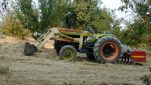

I've added new content to the Yanmar page referenced by my signature, below.
This is a sound file of a cold start (50 degree weather), then warmup @ 1500 rpm as recommended in the manual, the Yanmar Hammer (fuel knock) obvious at idle below 1000 rpm, then finally 1050 working rpm to lift the implements and cautiously pull out of the barn. (1.5 minutes, 1.5mb filesize.)
I thought I'd share this since we frequently hear 'if three cylinder Yanmars run smoother then what do the two cylinder ones sound like?' Well they sound like hammering on something solid. The sound of raw diesel power, nothing subtle about it.
I hope my Yanmar page is helpful to potential new owners. The posts of more experienced owners were a great help to me when I was deciding to buy this YM240 and as I performed the servicing that restored it to excellent conditon.
