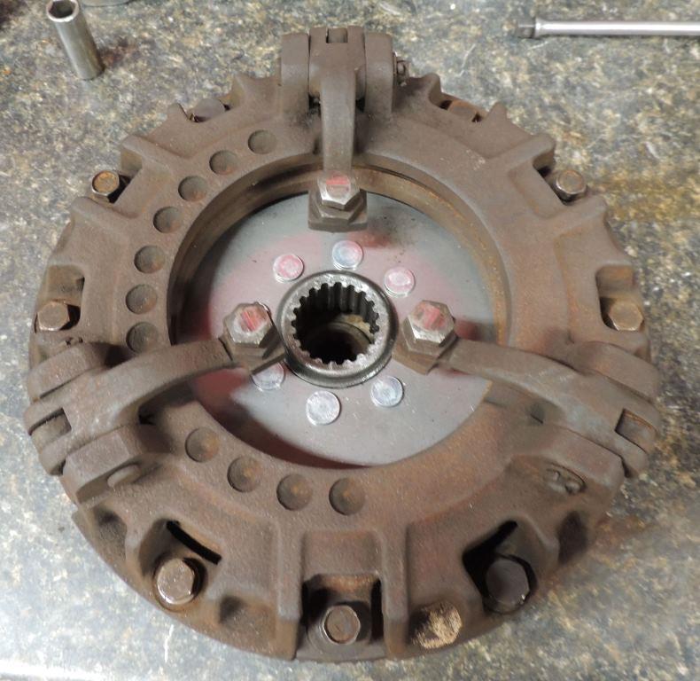

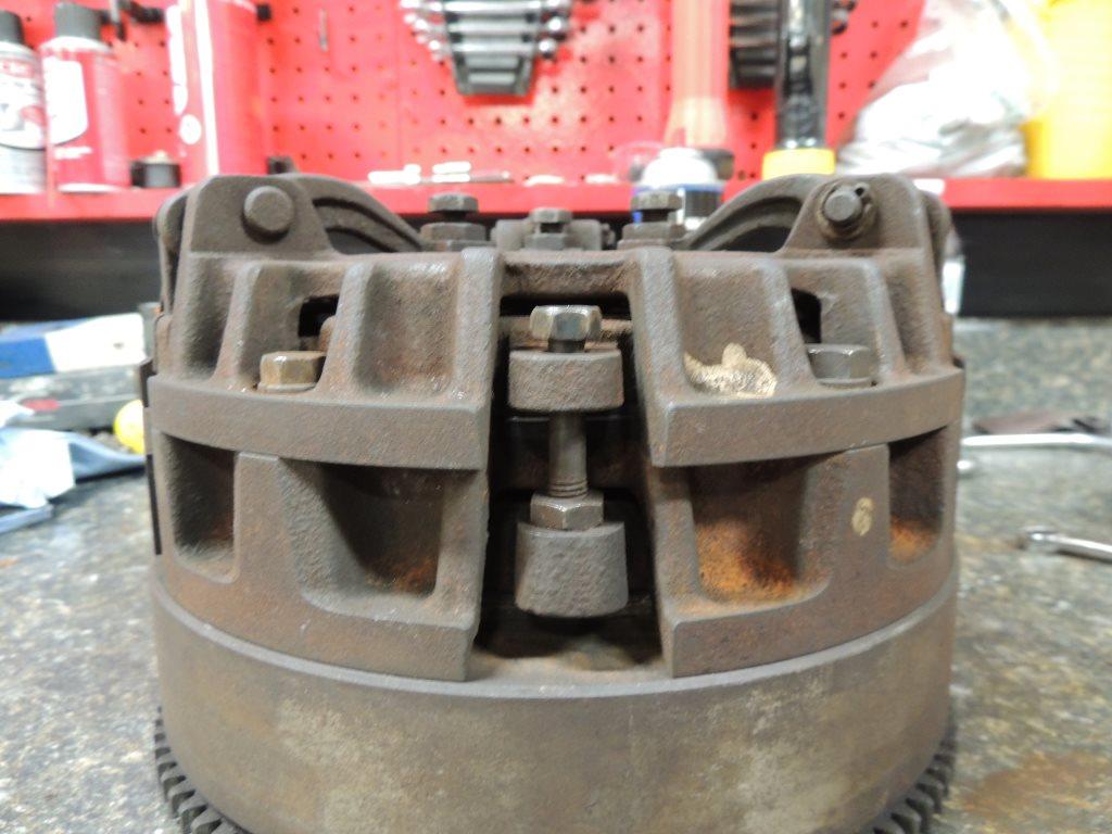

Putting this back together.
Here are pics of the new clutch in the assembly. I have everything figured out EXCEPT the adjustment for play in the three bolts that preload the PTO clutch.
Not even sure I am using the correct terminology. I have a service manual, but this is not covered. My service manual only covers the single disc clutch for a tractor without PTO.
I KNOW there needs to be some free play there. Otherwise, there would be no way for the clutch to disengage. I don't know how critical it is, but suspect it needs to be pretty close.
I believe I can still get to those three bolts after the tractor is back together through the inspection plate on the bottom of the bell housing. However, it would be much easier to adjust while I have this on the bench.

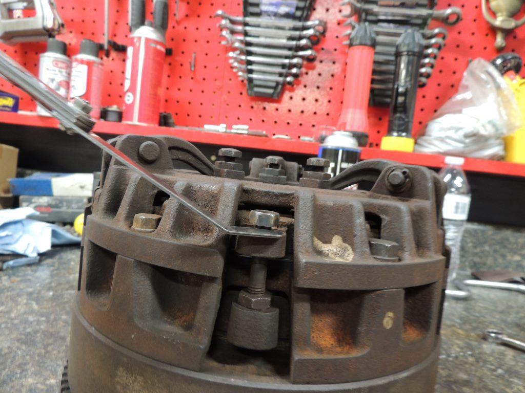

One pic shows a feeler gauge where the adjustment is needed. As you can see, there is a lock nut at the bottom of the bolt.

Those look to be limiting bolts to stop things from coming apart. Do you have any pictures from before you took it apart where you can count the threads?
The three on the lever arms look like they would would be to balance the pressure.
It has been a very long time since I last saw one of those type of clutches, trying to remember how they work.
   / Source for fixed hub clutch. Dual clutch S650 Bison #7
I have only worked on a one of those and it was a great many years ago;
normally the disc with the larger spline is on the input shaft to your transmission.
The smaller spline is on the shaft going to your pto.
The idea was as you pressed in on the clutch pedal you would release the clutch for the transmission but the pto
would still be powered,
pressing the clutch pedal completely would disengage both clutch discs and allow your pto to stop.
As I'm recalling the bolts you referenced would be activating your main clutch till they bottomed out then further travel would disengage the pto and further disengage the main clutch.

I have it back together and will be firing it up once I figure out which fluid goes where. Pretty sure I got the adjustment on those bolts figured out. They are all adjusted with .050" play. I think that will work fine, but have an inspection cover I can use to get to them if they need tweaked. An old John Deer mechanic told me the MAIN thing is to be sure they are all uniform, which I did.
