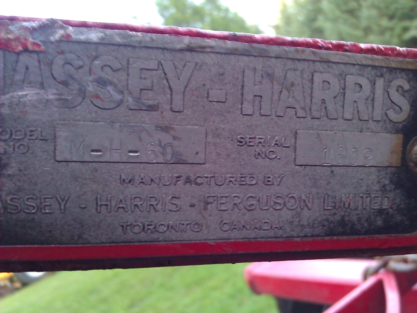

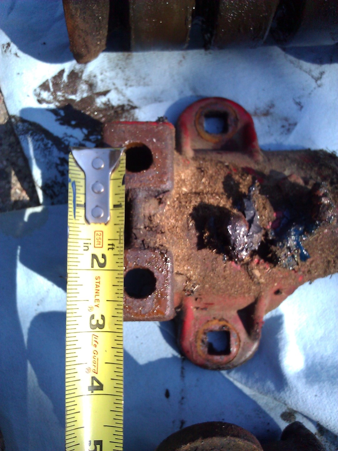

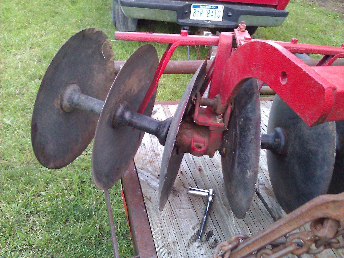

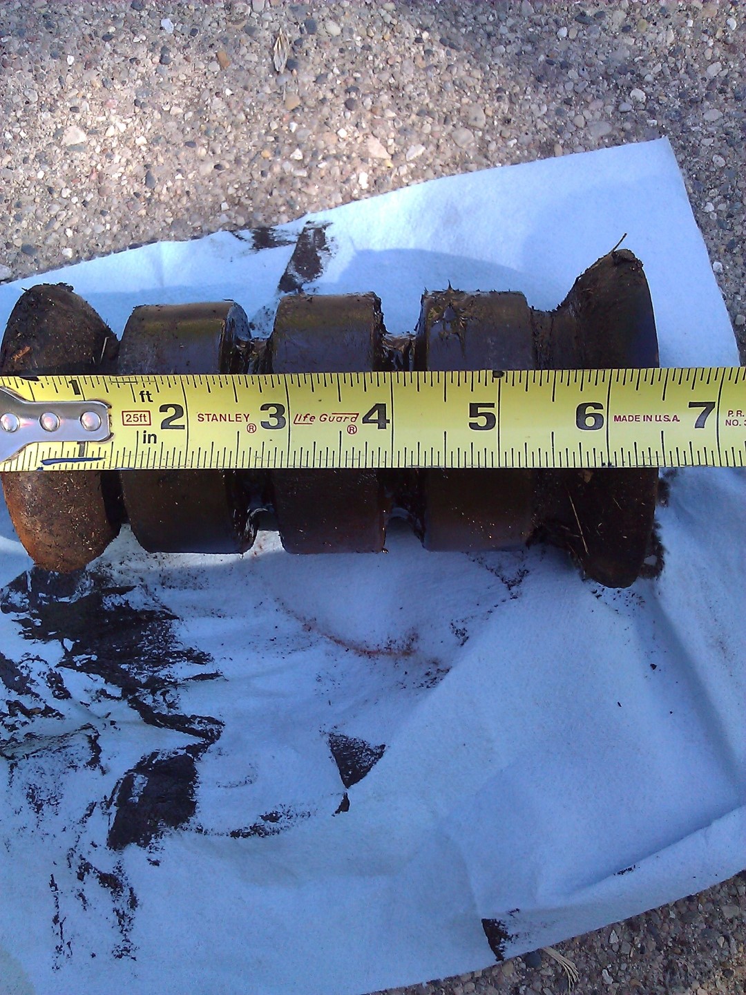

MH60 Bushing box- on machine.jpgGot a little carried away and hooked a stump- now looking for a bushing block, bushing and axle for my otherwise great Massey-Harris MH60 8 foot disc harrow. MH60 Bushing Box detail.jpgMH60 Bushing, 1.125 in lands 6.5in OAL.jpgMH60 Placard.jpg
Axle shaft is 1" sq. by 42.5" OAL.
Anyone know where I might find these hen's teeth? thanks!

Re-affirming that a) AGCO Parts Books rocks. No need to pay for Schematics if its anything AGCO! Turns out this thing is also a dead ringer for an MF22- predecessor to the MF25. The MF22 literature is dated 1960- amazing. 2) AGCO has the spools and the bottom half, not the top. Guess like some other posters I will be buying two bottoms and doing some creative machining.... Still hoping to find aftermarket but hope fading fast...
