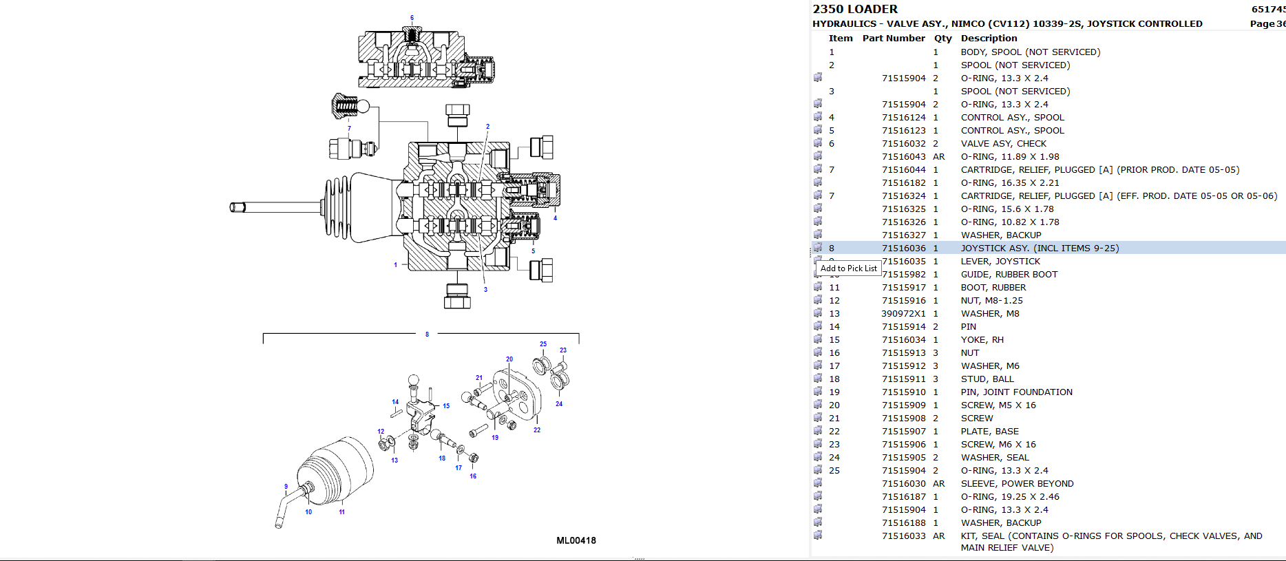

I have the 10339-2S valve which sometimes leaks and sometimes is stiff. Pulled up the boot and cleaned the mess out. Smeared some red grease on things that move and all seems OK for now. That said, I know the time will come for o-ring replacement. Hence, other than the dealer, where can I get the seal kit for the Nimco 10339-2S?
Thanks, Bill
   / Source of Nimco seal kit #2
The outer o rings on the spools are easily serviceable. Part # 71515904 O-RING, 13.3 X 2.4. Get the MF parts or just go to a hydraulic shop (probably cheaper). I would recommend just replacing what's broken, not a full overhaul. Just remove the loader before working on it, makes access a lot easier. There are a couple threads on the Massey Ferguson forum about it. Very common problem on the GC2300s now. The leak will only get worse. Nimco.png
