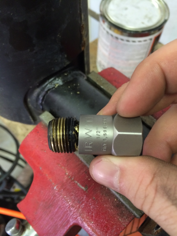

Nobody else have problems getting this undone. Now I've rounded the edges. Might end up welding something to it to unscrew it

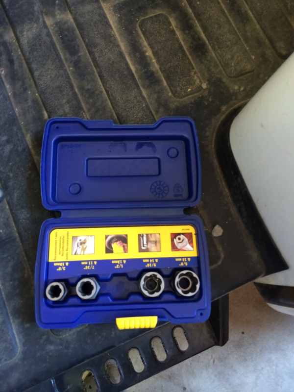

Gonna try in morning. I went by lowes and picked up a nut/bolt extractor. I may have to take muffler off because alternator is in the way. I tried just with way it is but can't get it on there tight enough.

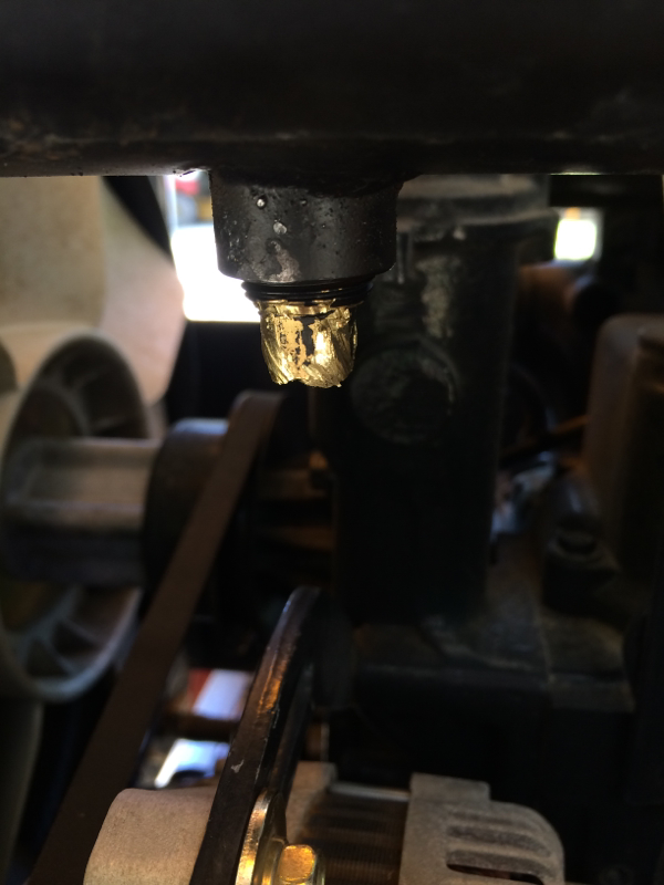

I ended up leaving the extractor on. Dealer is closed today. I used kroil and wd40. Used 3/8 breaker bar and heat and little tapping.

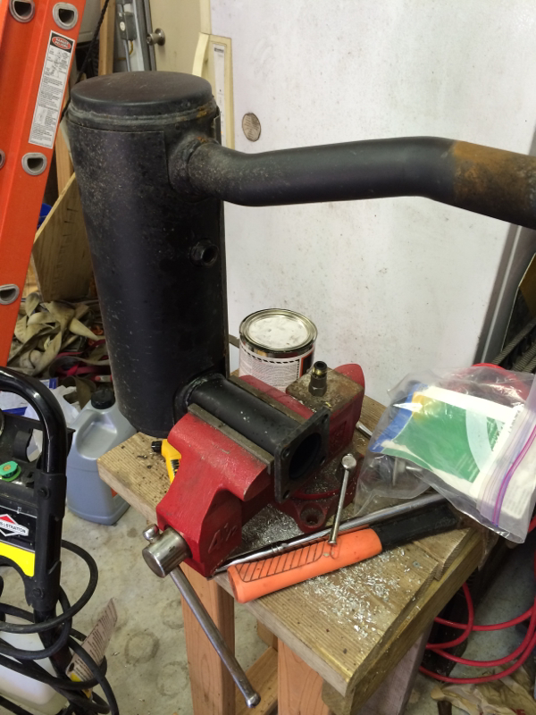

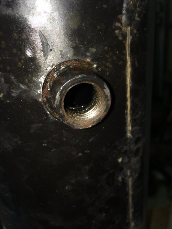

   / Spark arrestor
What it looked like

Did you have to put an acetylene torch on it or just run it until it got hot
   / Spark arrestor
#9
No ended up using little hand held torch from harbor freight didn't take to much heat.
