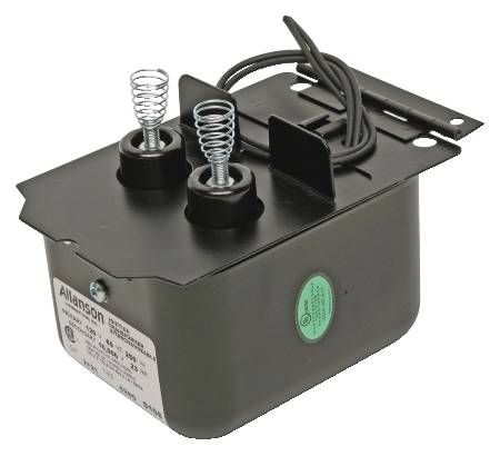

An old neighbor showed me a great trick where he would use an old oil burner transformer to burn off anything fouling a plug. I wouldn't recommend it since you're dealing with very high voltages but back in the day when the 2 strokes in snow machines would foul plugs left and right buying new plugs was cost prohibitive.
