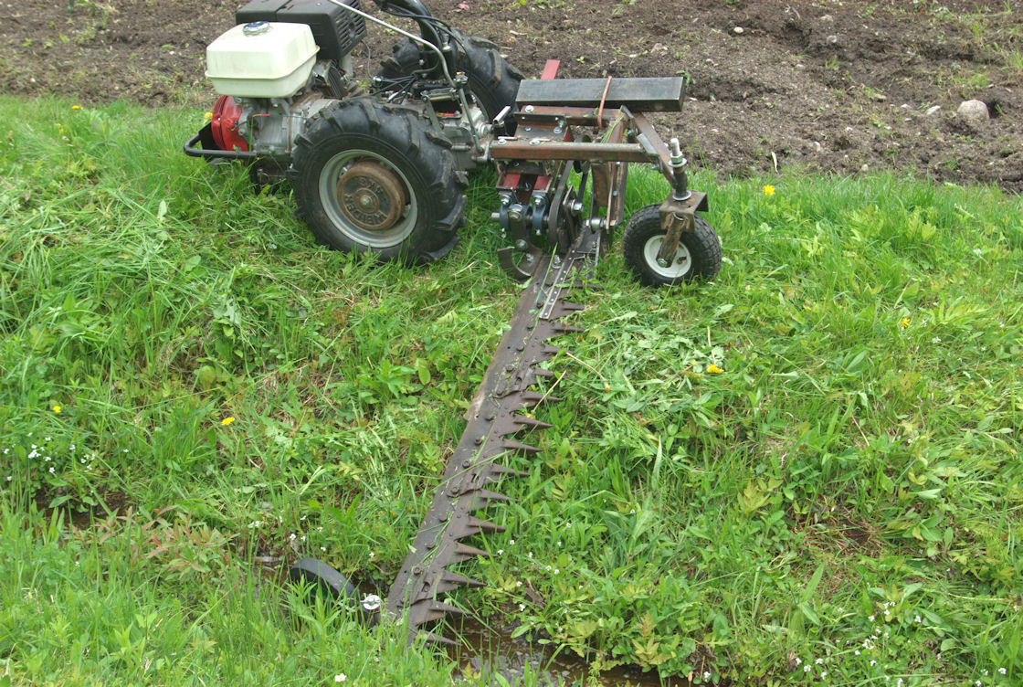

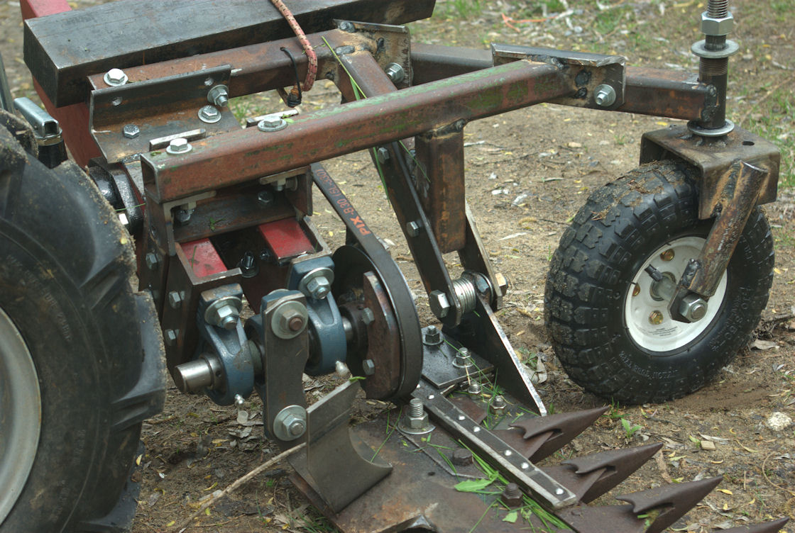

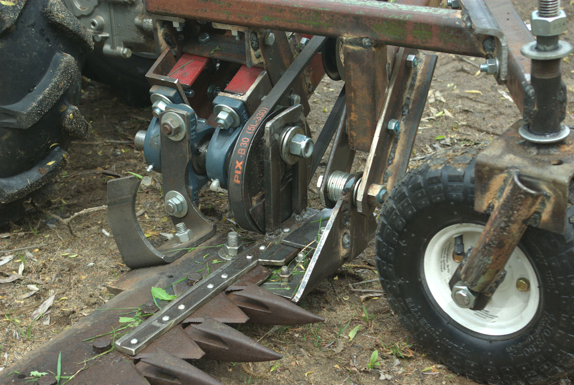

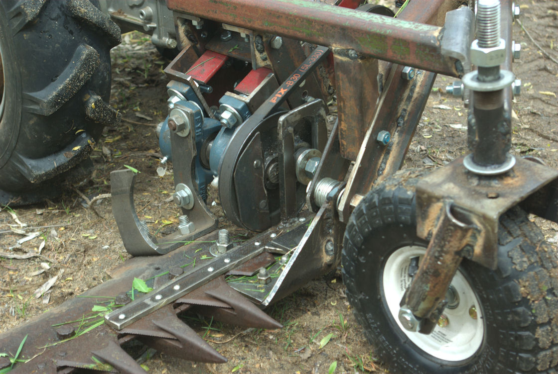

Hi! This is my new mower. I add a wheel at sickle bar end because too much side drag. also I fit a counter wheigt at drive pulley. Now more aceptable shake .
Drive system is a 6 in. pulley with 5/8 5 gr. bolt welded on pulley side. One bearing (6203) turn and slide with drive pulley inside a large slot makes two (3 in. strokes) by turn . This run very well now . But I dont know if the bearing could resist for a long time. I make more test now. Good luck ! Oldmech

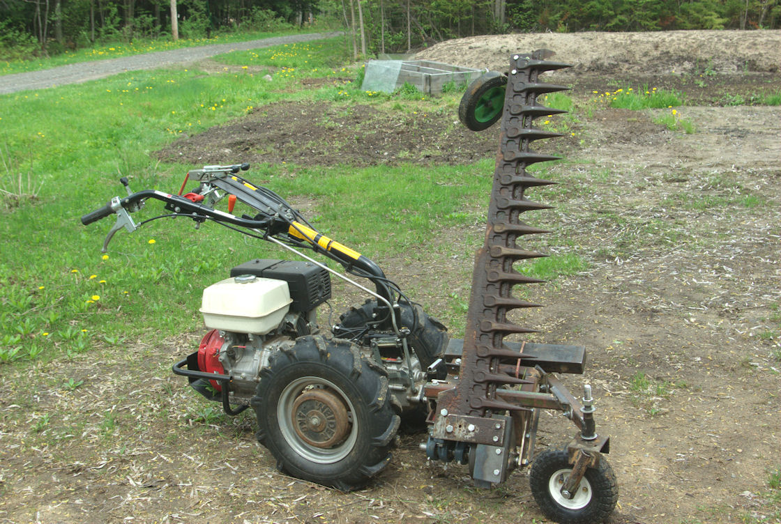

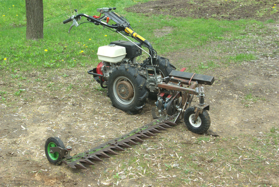

Hi! I make some test yesterday. Run well in all position. Next step . I need a lift system May be a 12 V winch with battery. I want add a second wheel with heavy weight for balance the mower and act as a breake for less drag from the sickle bar on the ground. Thanks! Oldmech
