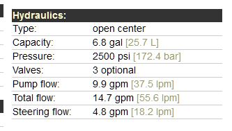

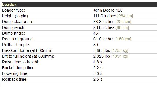

I recently purchased a used JD 4500 MFWD (sn 252424) tractor with several attachments including a Fork Lift and a Box Scraper. I致e searched the web for the lifting capacity of the front hydraulics and the Rock Arms yet have not found specifics for this tractor. I am looking for the total lifing capacity of the power reverser loader as well as the Rock Arms.
The box scraper attachment looks to be too large and has hydraulic rakes yet my tractor is not provisioned for rear hydraulic service line. What would be the result if I hooked onto a load the Rock Arms were not capable of lifting?
   / Specs on John Deere 4500 Front and Rear Hydraulics #2
Spec's from Tractordata.com

Thank you. I'll look up the weight on the box scraper
