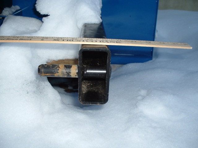

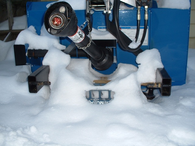

John,
Could I bother you to take a few measurements on your Speeco hitch, assuming its a Cat 1? I'm attaching a few pics to show my blower hook-up. I'm thinking if the spacing of the lower hooks on the hitch are perfectly matched (a long shot, I know), they might go in the channels. I need the measurements of the inside spread, outside spread, and thickness of the hooks themselves.
The blower would require the hitch to have an inside spread of 26 3/4" and an outside spread of 29 7/8". The channels are 1 1/2" across. Its either going to fit perfectly or not at all.
Thanks in advance for your efforts!
Brad

   / Speeco quick hitch and Wood's implements
Re: Speeco quick hitch and Wood\'s implements
I just got thinking, this might not work anyway. Someone correct me if I'm wrong, but it seems to me that the Speeco Cat 1 actually accepts Cat 2 pins with bushings to slip over the Cat 1 pins. If this is the case, I wouldn't be able to get the bushings on the inside of the channel.
Might have to go with Pat's easy change and deal with the lower arms flopping around or get the stablizer bar for hook up. It seems everyone likes Pat's system, I was just trying to get set up where I would not have to mess with the swaybars. I guess once set for winter with the stablizer bar in place, it wouldn't be too bad.
Thanks for letting me think out loud. I may have answered my own question /forums/images/graemlins/tongue.gif assuming I'm correct about the Speeco needing Cat 1 bushings.
Brad

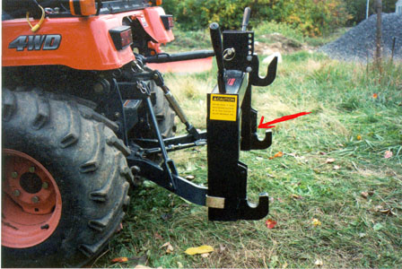

I have a Speeco Quick Hitch on my BX23 and I have used it with a Woods GBC48 Box blade that claims to be CAT1 and ASAE quick hitch compliant. To get the Speeco to fit on the GBC48 I did have to make a slight modification to the quick hitch - there are two brackets on each side that the pivot for the holddown arms rotate in - I had to use my grinder to cut out a small piece on each of the inner brackets because they were hitting the arms on the box blade that the Cat1 pins are mounted on. (see attached picture - arrow points to where I had to put clearance). As far as the pins go I just took the pins off and then used the Speeco adapter bushings but instead of putting them over the pins I attached them directly to all my implements with 7/8 Grade 8 bolts of the appropriate length. I had to do a little bit of work to get everything to work but in the end it was worth it - putting attachments on the tractor is much much easier now than it was before wrestling with the 3pt arms.

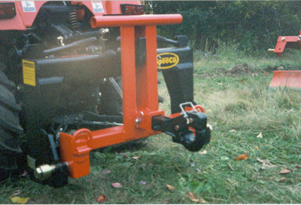

   / Speeco quick hitch and Wood's implements #10
another shot showing the Speeco with 3pt hitch adapter I put together - you can see how the Speeco adapter bushings are put on with the 7/8 bolts
