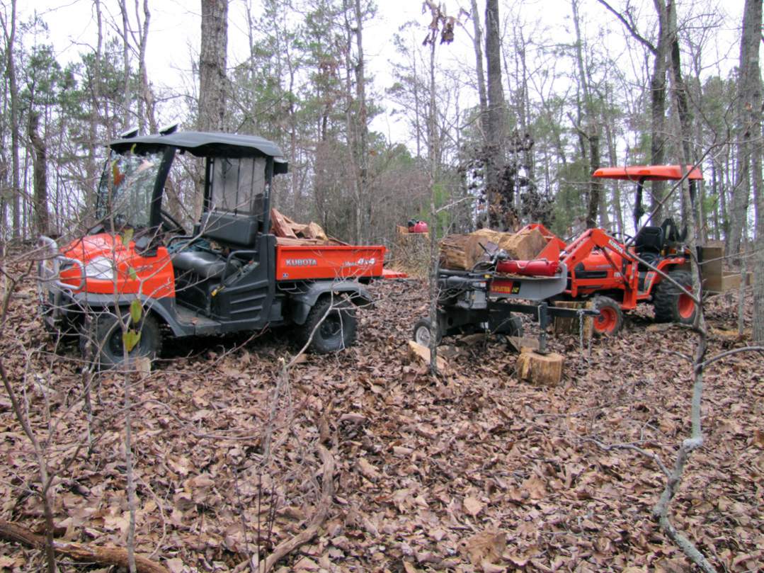

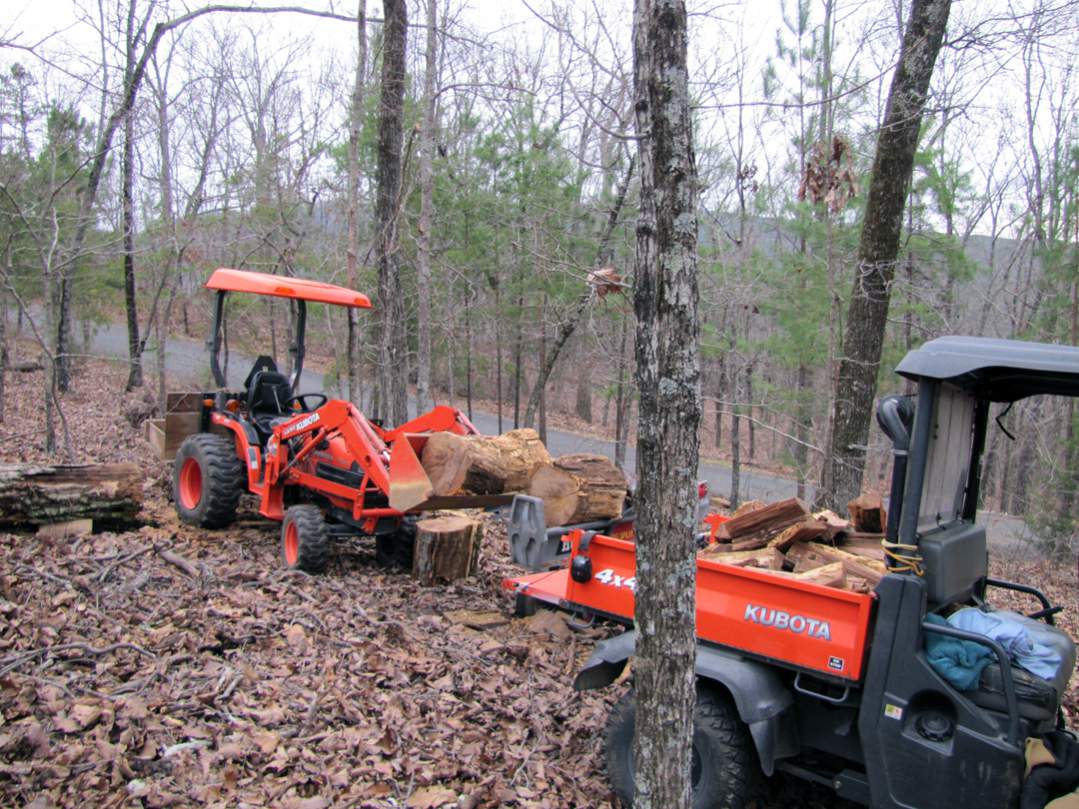

The other day I was down at the TSC here in Calhoun, talking to the guy who usually helps me. A REAL farmer type guy for once, who understands what I am talking about. Anyway, we got to talking about the 35 ton splitter I have from them and how I have had it for like 7 years and probably 100 cords of wood and the oil is still clean clean many hours after an oil change, it doesn't burn a drop of oil, and starts on the first or second pull..........
To my surprise Speeco has a 4 way splitter attachment for the 28 and 35 ton machines. Actually they have two. A light duty one and a heavy duty. I ordered the heavy duty one and got it the other day. That thing WORKS...........easily takes off 1/2 to 1/3 of the time. Was easy to install and one can change back to a single blade or change the horizontal height of the 4 way in seconds......GOOOOD STUFF................
The pic is what I split in perhaps 30 minutes of splitting. It's a standing dead for a couple of years red oak. 38" at the cut and now that I am finished, split out to a little more than a rick.....4X4X4'. I use the tractor bucket to handle the rounds and lift it to put on the shelf of the splitter. By the way, I didn't know they had that shelf as an accessory until last year............WORTH THE MONEY........Anyway, thought some of you might like to know about the 4 way...........God bless.......Dennis IMG_2307.jpgIMG_2309.jpg
