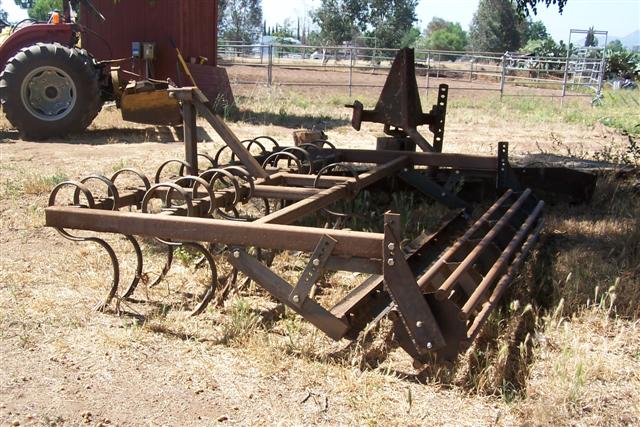

I just completed this project, we had built a horse riding arena and had sticker shock when we priced arena maintainers. So we dug around, found scrap steel and $60.00 later this is what we came up with.

Looks good, i have been thinking about trying a rotating harrow like the King Kutter one but your looks much more straight forward and will be one to add to my list.

Eddie, that is a fine looking piece of work you have built there, now we will need some action shots:)

that looks kinda like mine my back wheel is solid mounted how does the spring mounted one work? i love mine just cost me a little bit more to make those spring teeth are expensive!!!jon

Looks great! I like how you have the spring load on the level bar and roller. It looks like its back far enough to give a decent landplane effect.
Mahana79 - I had a rotary harrow that I used in my sand arena, but all it was good for was deep sand and nothing else. I finally broke down and bought a TR3 which works in almost everything but costs alot. If I had the time (and talent) I'd build one like Eddie built.

I do have a 6' rear roller for a pulverizer, it is a very heavy one. I do not need it, it may make a good addition for this type of project.
   / Spike Tooth Harrow With Pulverizer #9
the roller on the back works as a guage wheel and packs down some of the fluff the teeth leave. i would think the pulverizer would work great..
