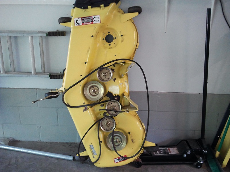

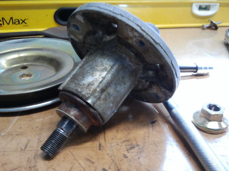

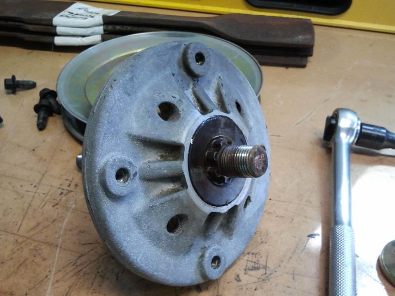

Does anyone know if these spindles can be disassembled? I want to replace bearings, but can't see how these come apart.
The deck is a 2008, 54" John Deere.
Thx for any assistance!

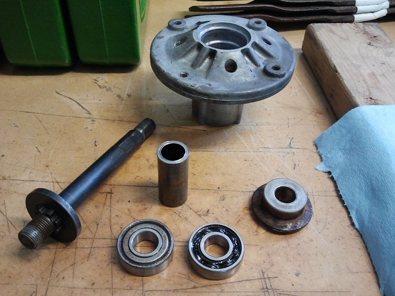

Got the spindle apart! Next need to remove/replace bearings. More pics on the way.
Special Thx to SandburRanch for the excellent instructions on how to do this!

So I got the bearings out no problem. However, finding the replacements is going to take a little work. My JD Dealer only sells one of the two bearings. O'Rielly Auto has them, but they are $11, and $13 dollars. The local farm supply and Hardware Stores don't offer them.
Peer 6203, GX20818 (top bearing)
Peer 6203, GX21510 (botttom bearing)
If anyone has a good online source, please let me know. If I can find a good price, I will do all three spindles, and not just the bad one.
