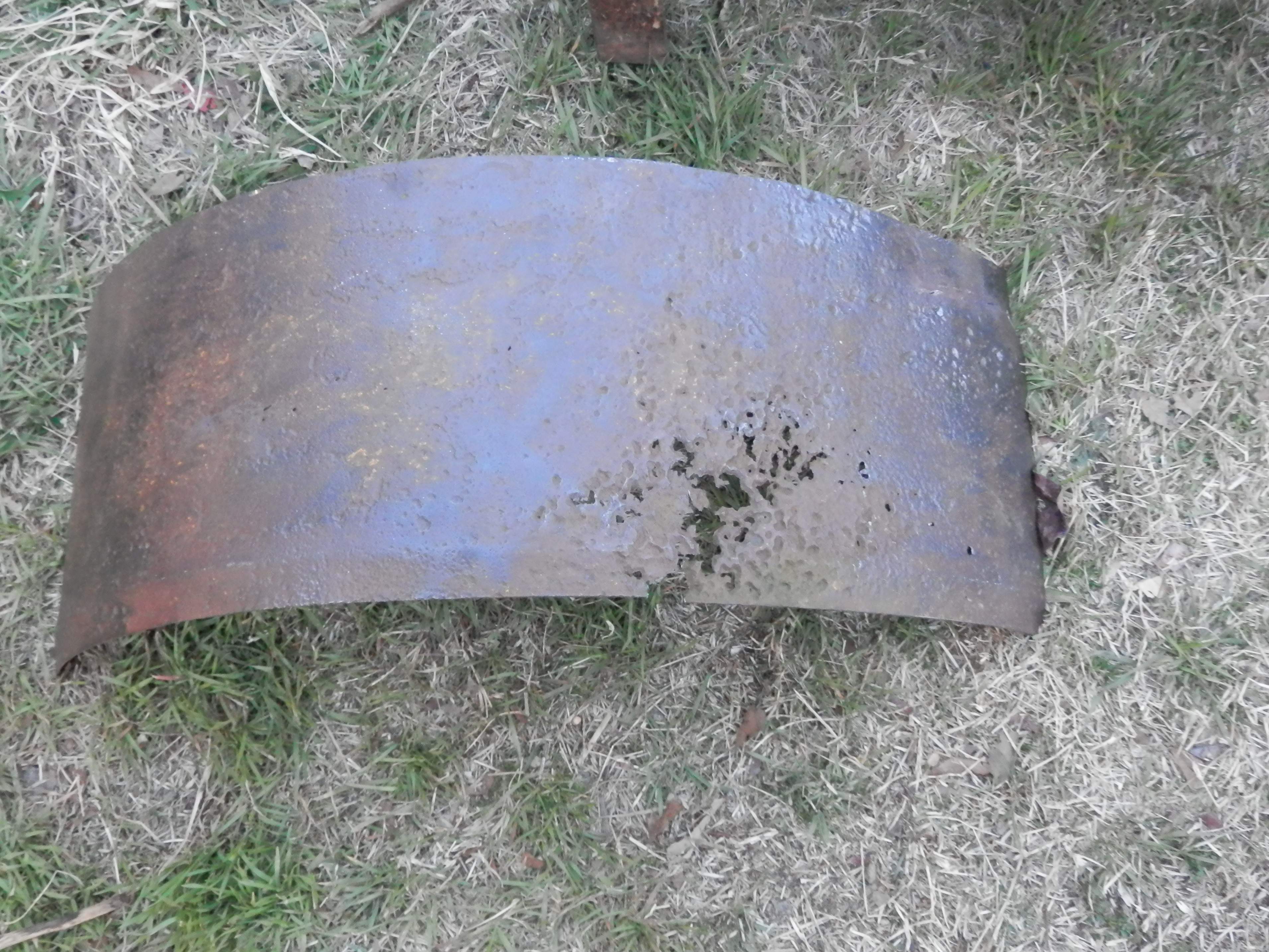

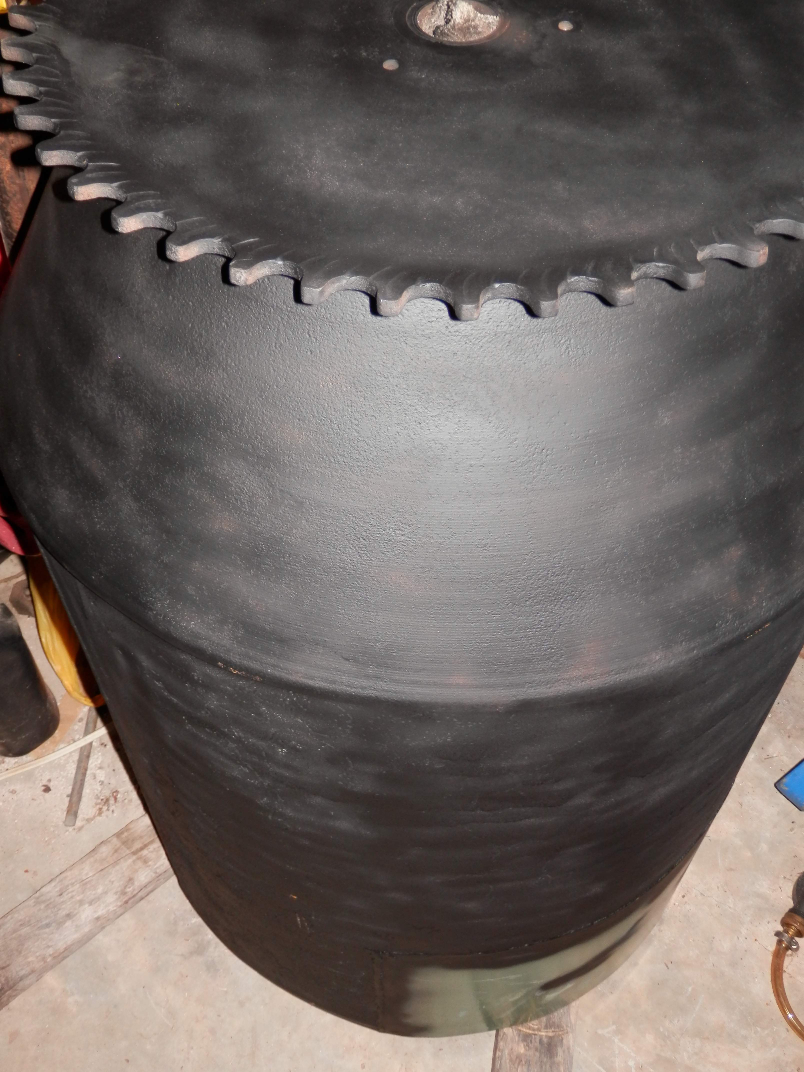

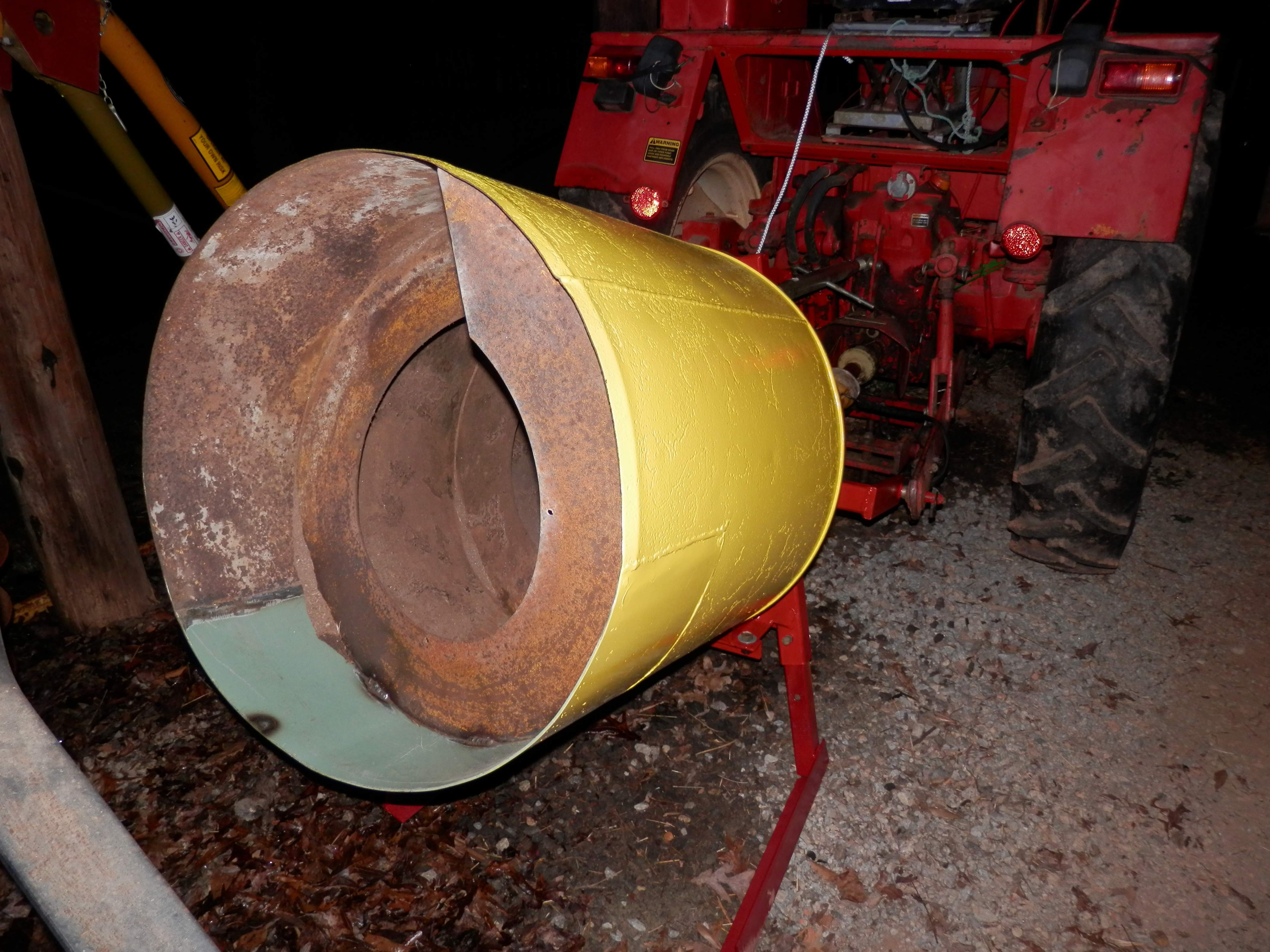

I have some concrete work coming up where the truck can't get to and I saw an ad on Craigslist for a 3-point cement mixer for $250. The owner hadn't run it in 20 years but he said it was in working condition. I asked if it had a hydraulic toplink and he said no, it reverses gears and pushes the mix out like a cement truck! Well, I had to go take a look and went over that evening. Of course a hard cold rain set in just as I got there. It was pretty rusty and had a spot rusted through the drum near the edge but the mechanicals looked okay so I went ahead and bought it. He had had lots of calls after mine and wouldn't come off the price.
Did some searching online and it's a Teagle Spiromix 100 with a batch capacity of 5 ft^3. I even contacted Teagle in the UK and they emailed me a pdf manual for free. The current models are all powered by a hydraulic motor instead of the PTO but they look the same.
http://www.teagle.co.uk/images/pdfs/leaflet/spiromix.pdf

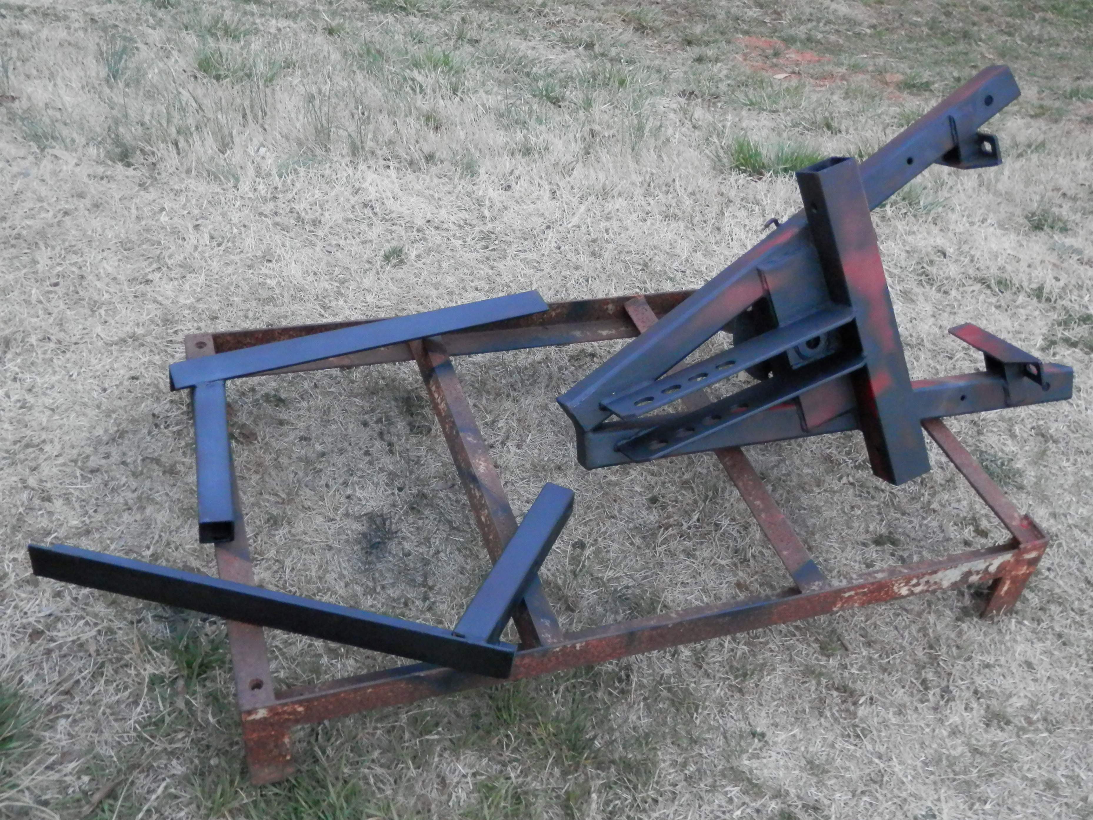

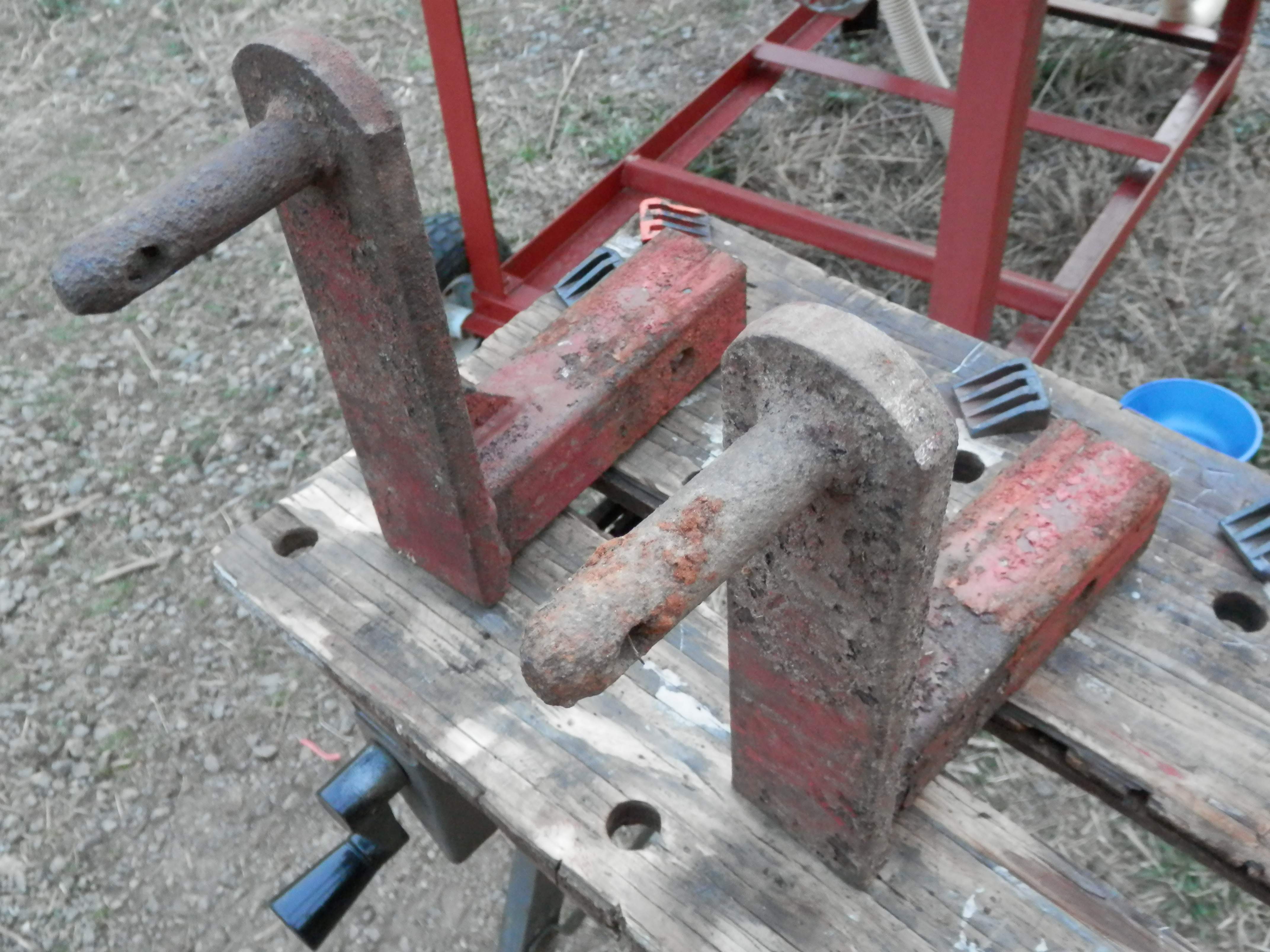

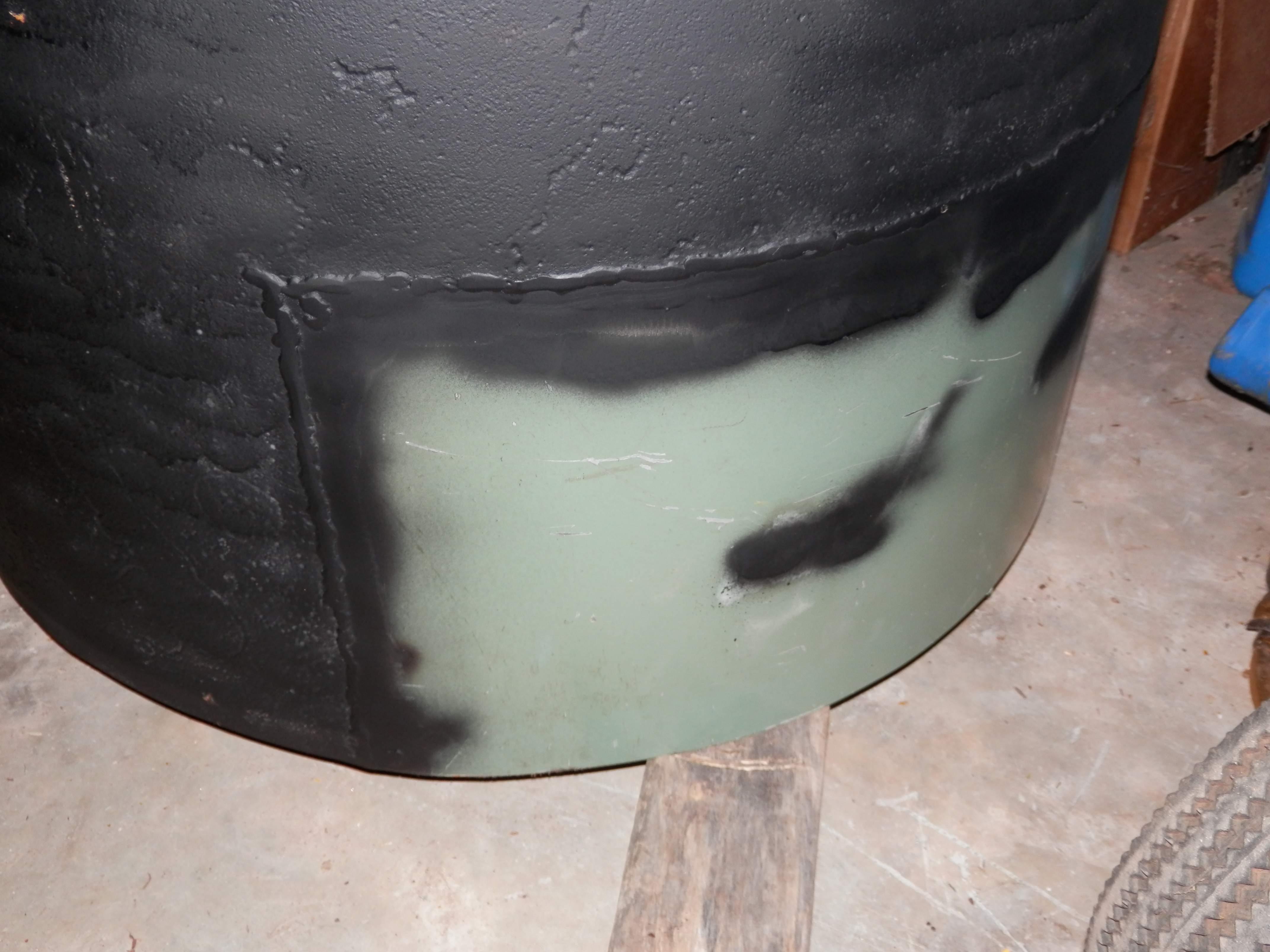

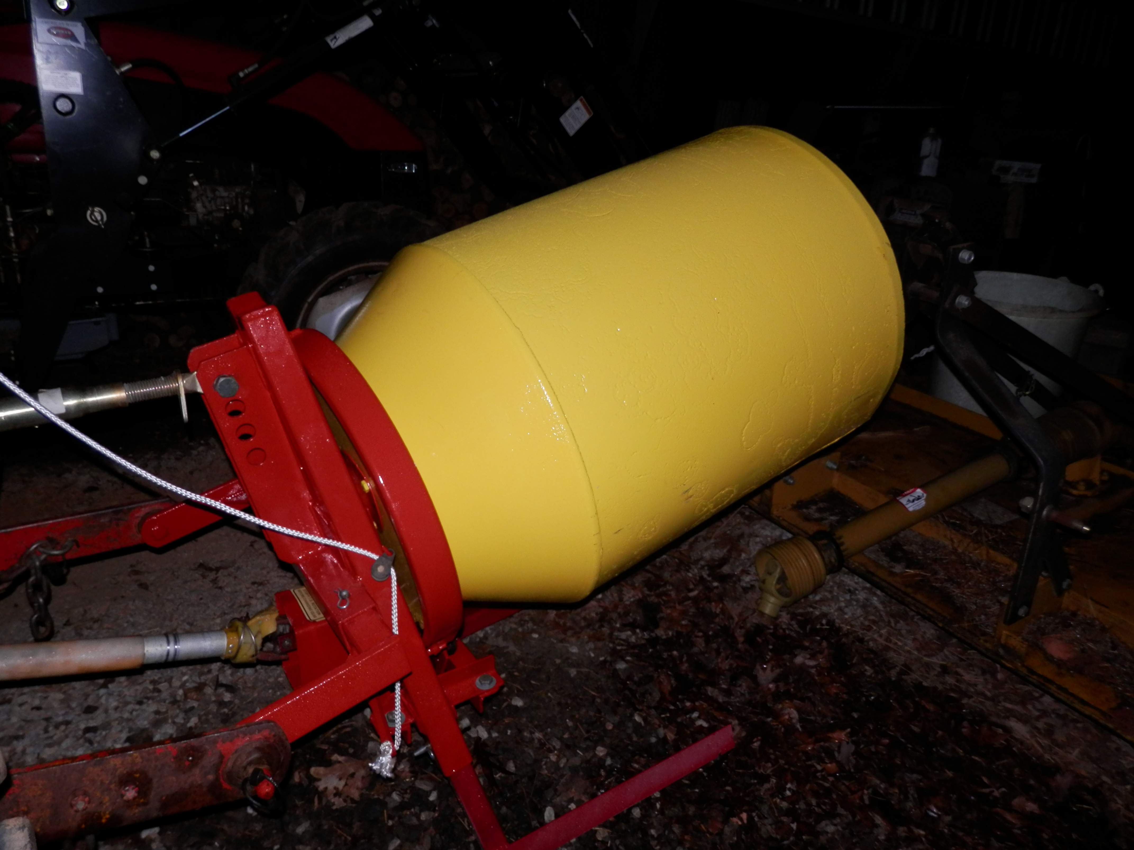

Anyhow, I got it home and it was even a little rustier than I thought. I cut out about a 10x24" rectangle that was rust perforated and welded in a patch. The drum material was about 0.10" thick and I found a piece of similar stuff in my junk. I cleaned everything up mostly with a cup brush on the angle grinder and painted with Rustoleum Rust Reformer(R) before giving it an oil-based topcoat. Got it back together yesterday evening and it's looking pretty good!

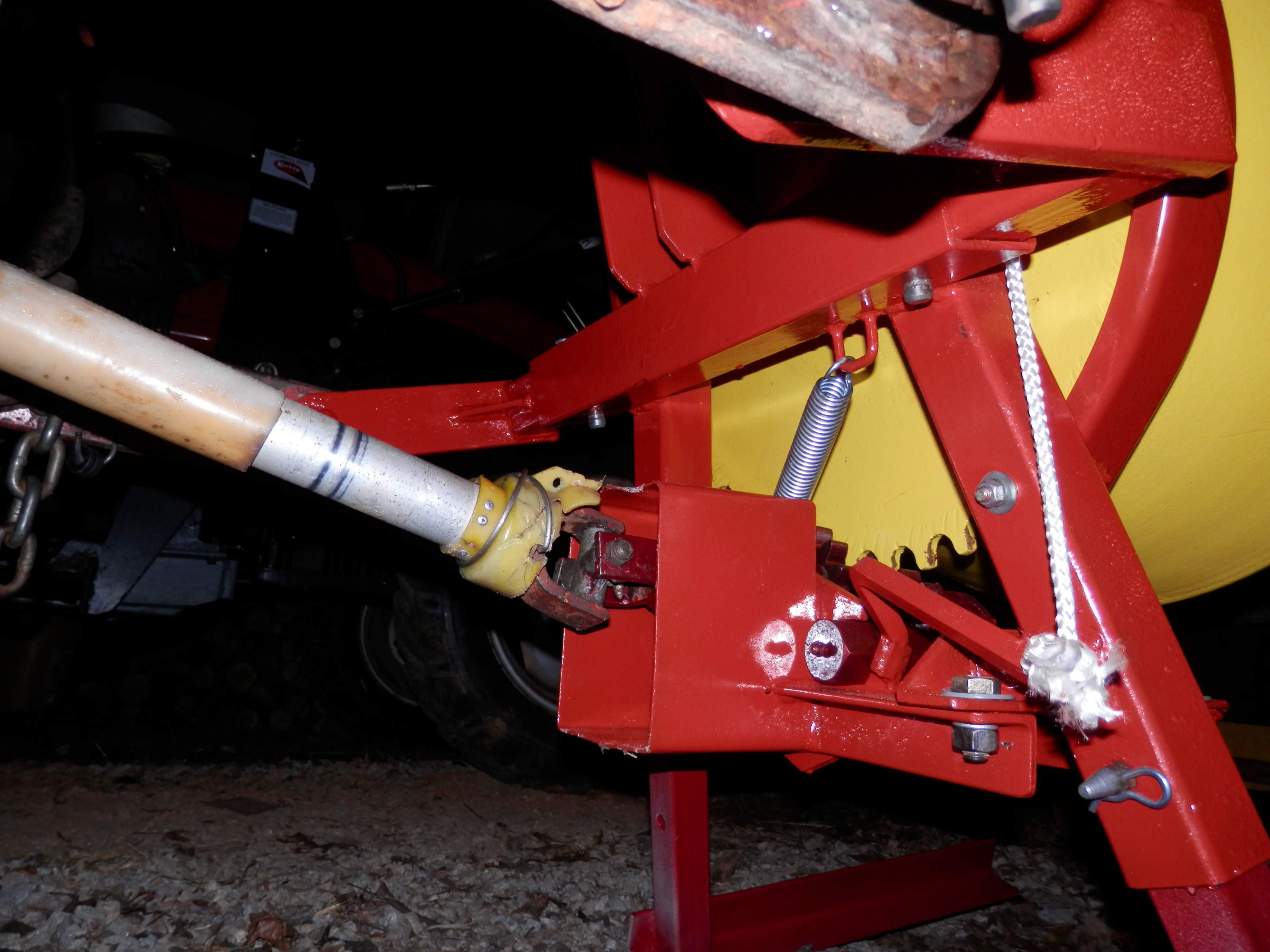

There is one sticker that was still intact on the PTO guard that says you must stop the PTO before reversing. I'm thinking the momentum of the drum may cause damage if it's reversed on the fly.

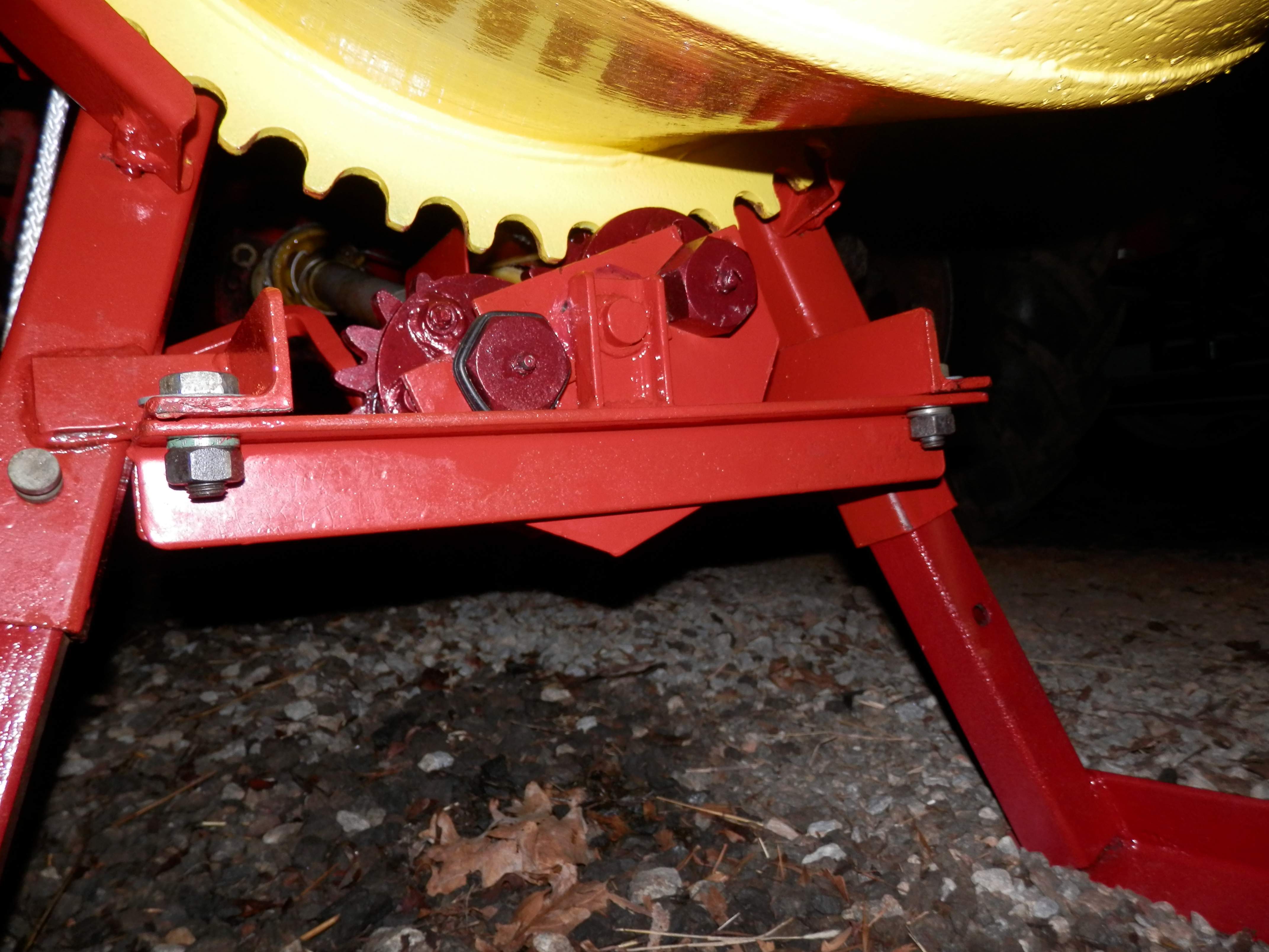

I tried it out to the extent that I threw a few shovelfulls of gravel in it and let it mix, then reversed it to dump it out.
The spring overengages the drive cog and the assembly rattles a lot. You may notice I put some o-rings around a shaft cap to limit the travel a little which helped. I'll probably attach a little piece of flat belting there as a bumper to limit that engagement. The drive cog gears consist of a set of greased rollers which I like in terms of longevity of the bull gear. I'll probably also grease the whole bull gear. There are 4 bolts at the ends of the angle iron pieces holding the gear assembly in place. The frame holes where they attach are slotted to allow for adjustment. Removing those bolts allows the removal and complete dissambly of the gears.
Here's a video someone posted of a pretty decrepit looking example running that shows a pretty severe rattling. Apparently there is imperfect centering of the bull gear making the rattle periodic and mine has a similar behavior. The gears on the one in the video are really jumping around and that may be a misalignment of the assembly. If you look at my picture of the drum painted black you can see telltale marks on the bull gear where the gear that drives the reverse shaft was eating into the gear face. THAT would probably cause the jumping you see in the video.

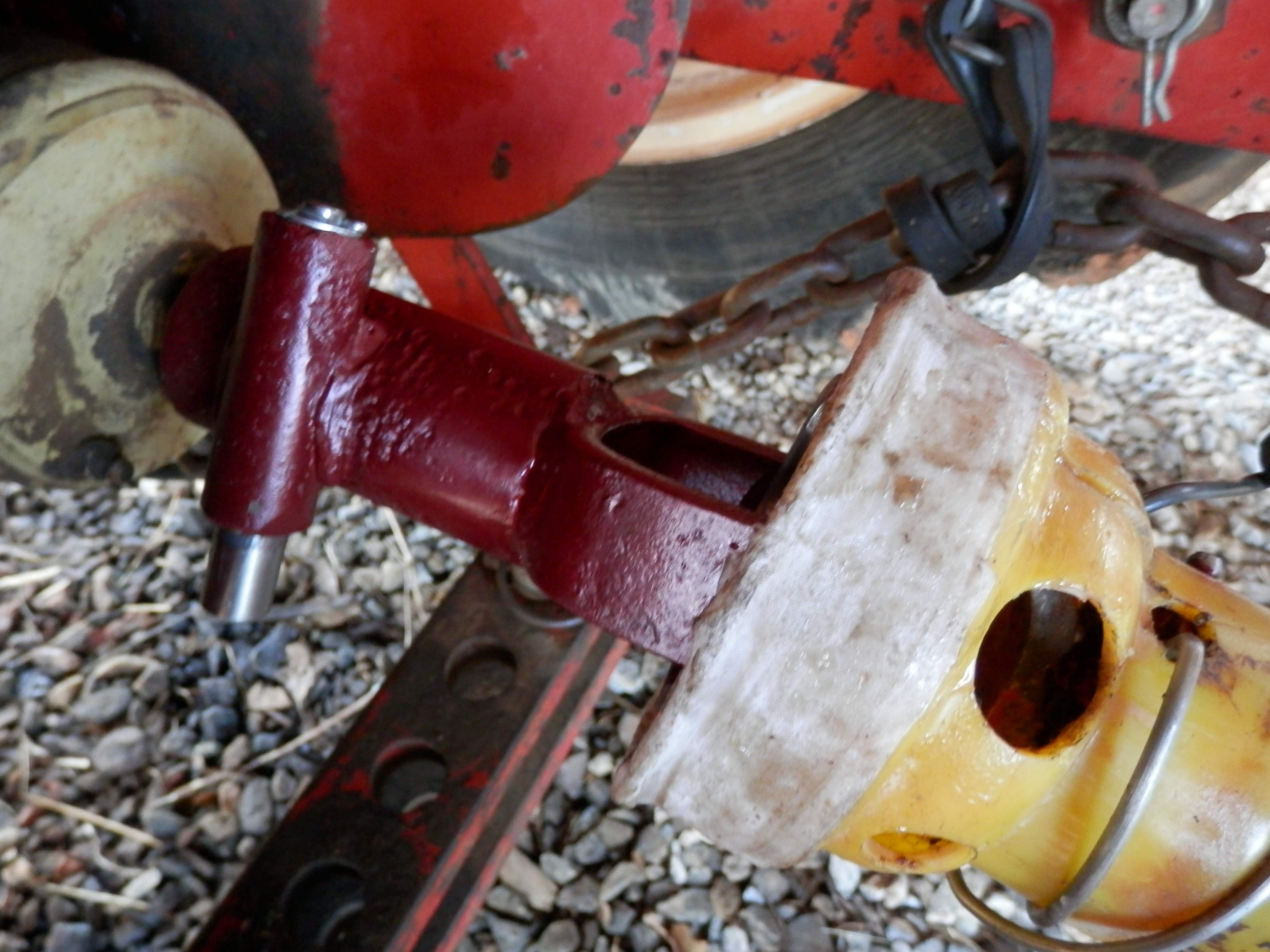

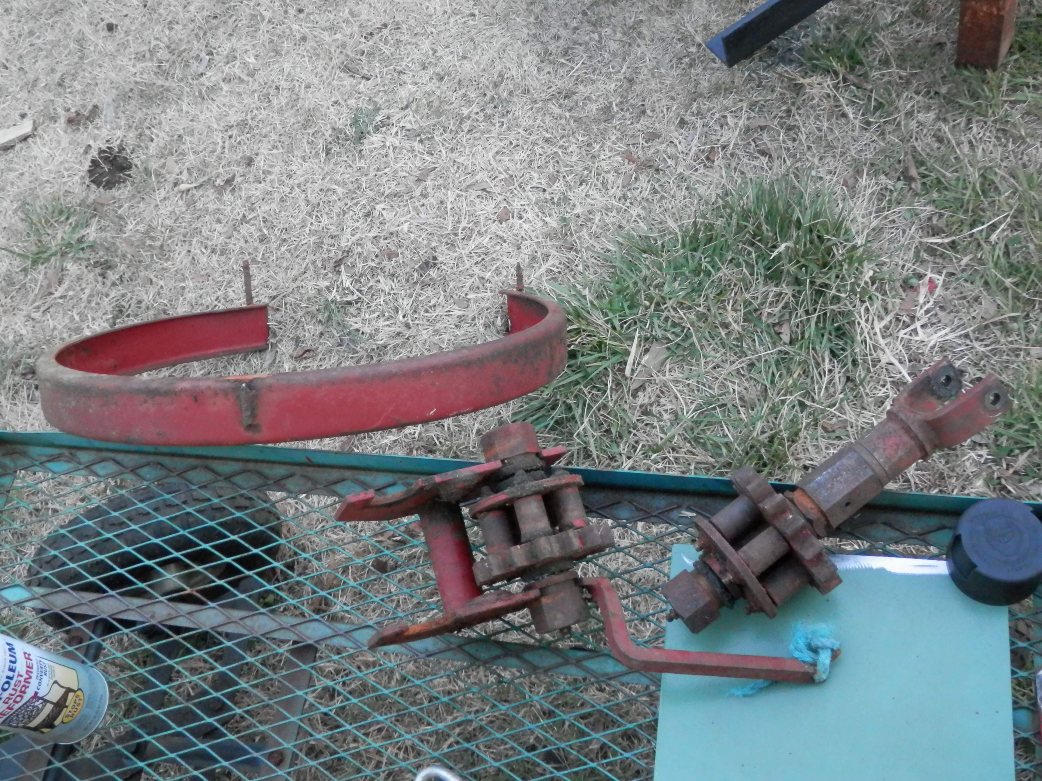

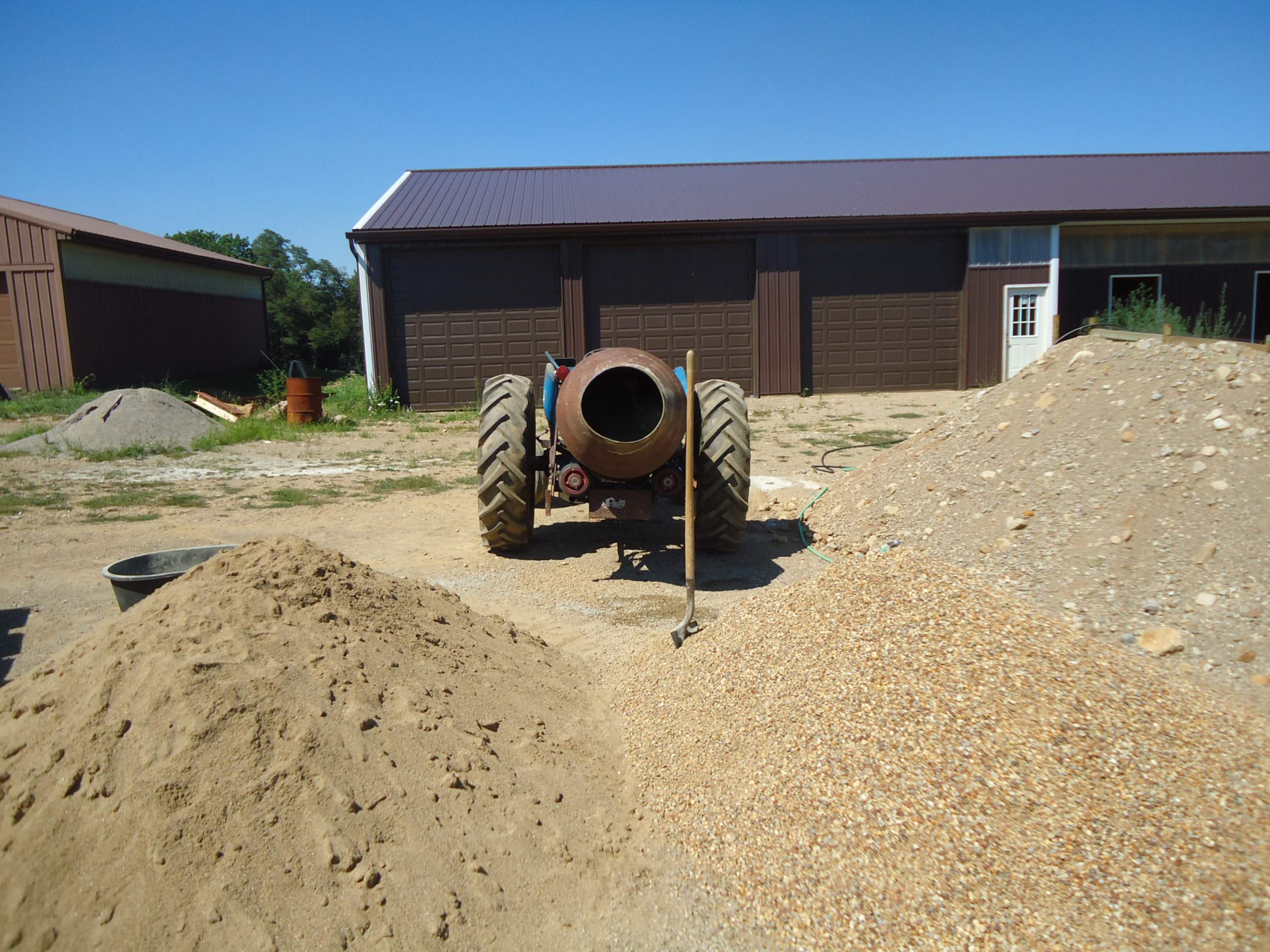

I took some more pictures and a couple of videos tonight. I added the little rubber pad to limit the cog gear engagement. I need to order some sand and gravel and do the prep work so I can actually mix up some concrete now! One other thing I forgot to mention was the PTO coupling was really rusted and I had to make a new locking pin for it. I used a piece of W1 drill rod but didn't harden it. I also fixed up that end of the guard where it was cracked by wrapping it with some cloth using hot melt glue. The other end of the guard was missing the tube and I added an aluminum tube. I didn't fix that end of the bell guard because I was worried about clearance with the stationary guard. The shaft flopped around some while I was putting everything together and dinged up the edge of the stationary guard so it's probably good that I held off on fixing that end of the plastic.
