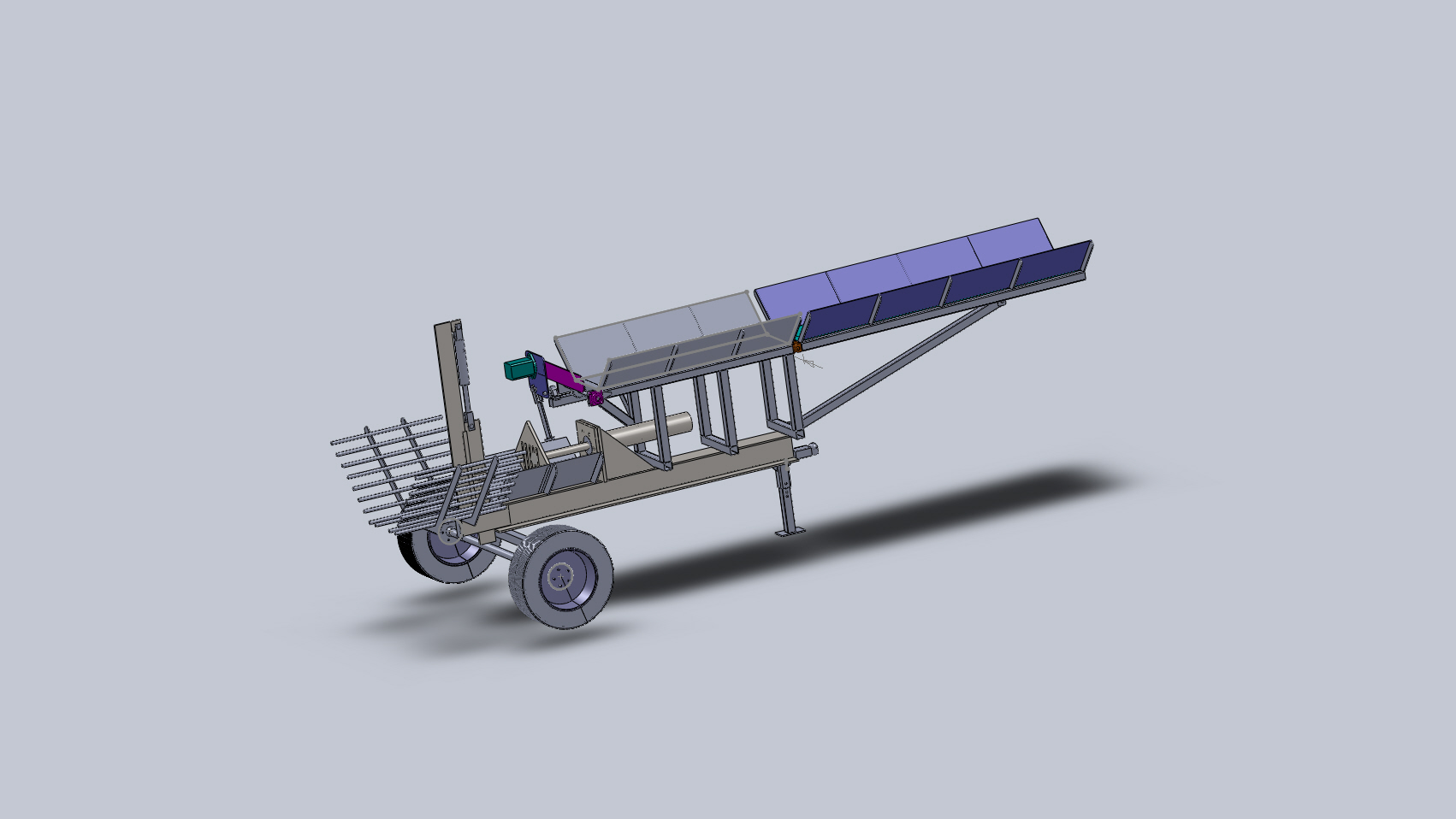

Im looking for a few opinions on a splitter. Currently i split 8 cord a year with a borrowed gas or electric splitter. I think this year i might get up to 10 cord and its time i bought my own.
So Ive been researching OEM splitters. Ive also thought about building myself a firewood processor to make life a little easier or maybe even sell some firewood to offset the cost of wood. But after reading several threads (and pricing components) Im thinking that i wont build the full processor (if i go DIY) and just build the split section. I can add the processor at a later date.
One major advantage of a DIY splitter is i can build it with top shelf components. I really like the idea of Prince's new LSR self contained regen valve. I can see it speeding up the cycle a lot. I also want an adjustable 4way and log lift and DIY gets me that without the massive upcharges that the oems add for those components. See attached rendering of my processor/splitter design.
OEM gives me the advantage of speed. I have a bunch to do and id like to have my wood up before summer. If i have to spend several days building and designing a splitter its time i cant spend on other things.

So i headed to princess auto. They had a hydraulic clearance on. Picked up a 1.95 Cu pump for $35!!! and the prince Autocycle valve regular 345 down to $240. I was wanting to go with Prince's LSR regen valve, but the autocycle was a deal, and with a big pump i wont even notice the lack of regen.
How could i pass that up? Sale ended today so i had to jump. I can still return it next week if i find something, but i think im going to build. I can get what i want for way less.
Once i start building, ill post up a thread.
25GPM into a 4" cylinder should make for one fast splitter!! :D Rough calculation of a 3 second extend time. Might be too fast,lol. Might put a larger 36" cylinder so i can split doubles, dont know yet but i got the flow.
