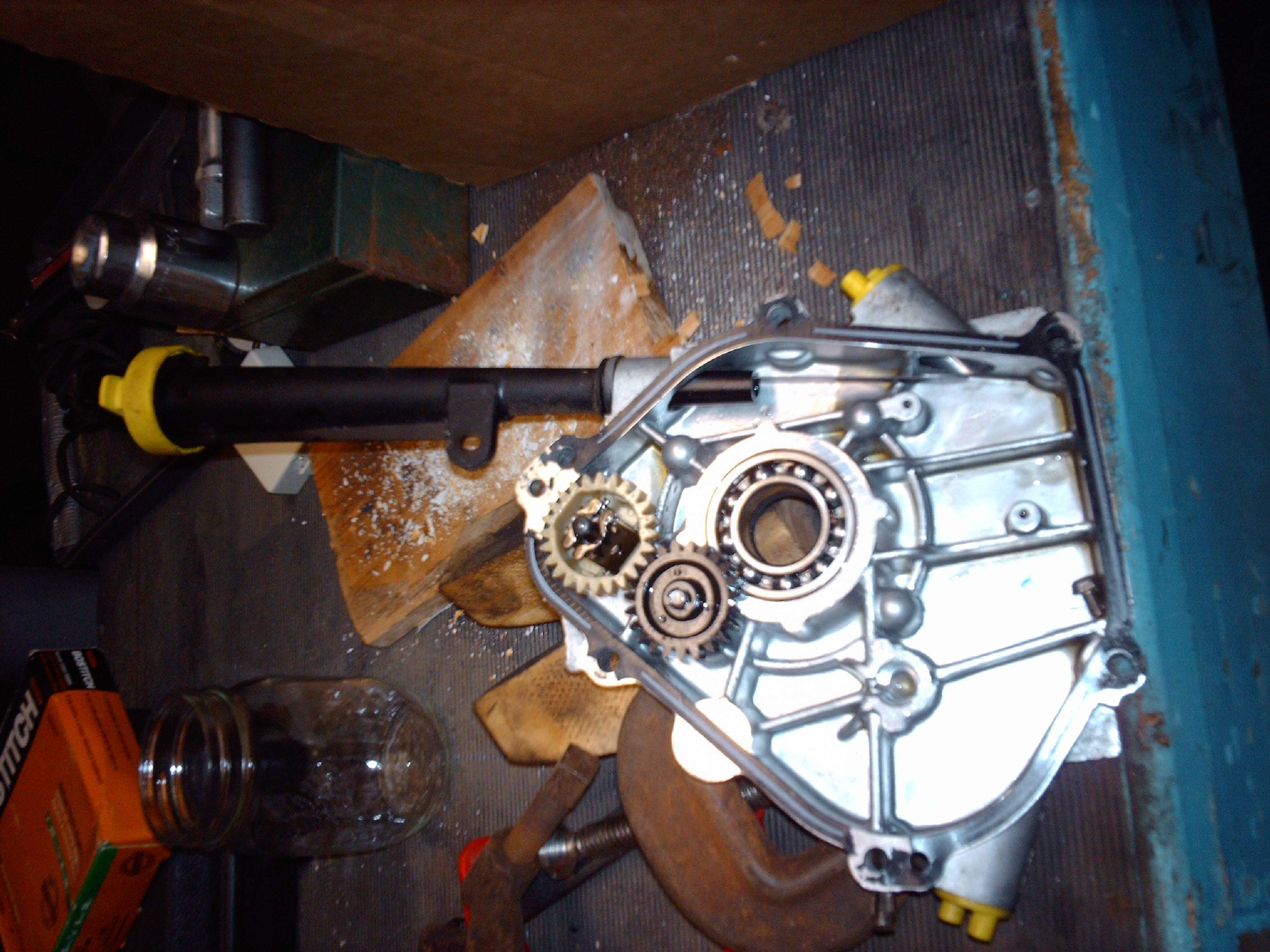

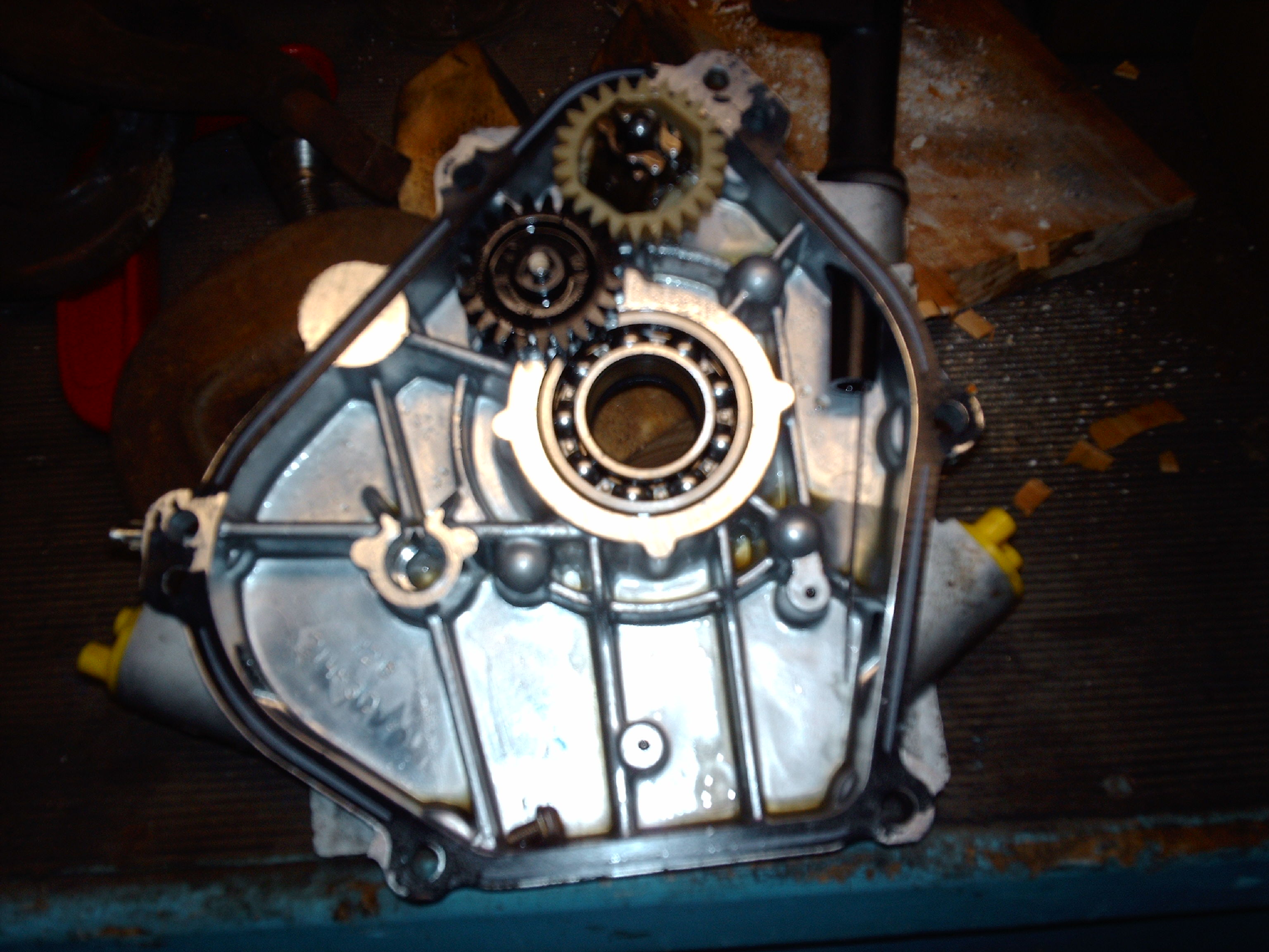

The small yellow plug is the dipstick for the tank that went empty, any idea what we're looking at here ? Engine is a Tecumseh 8 horse.

Guessing by pics /words a tear down..depending how much damage cyl. walls,piston,crank...looks like a bad gasket may have cause this.

The yellow plug is where engine oil can be added.
   / splitter seized up today #4
The engine is done. That is were the engine oil goes. I would go down to Harbor Freight and buy one of the imported engines to replace it. It will be the cheapest way to go.

Welcome to TBN. Yes, like stated, the engine is toast. When you put the new engine on, do yourself a favor. Get that hyd filter off the suction side and put it on the return hose between the valve and the tank.

Just curious, but how long was it between the time when you last checked the oil level and the time it seized up?
