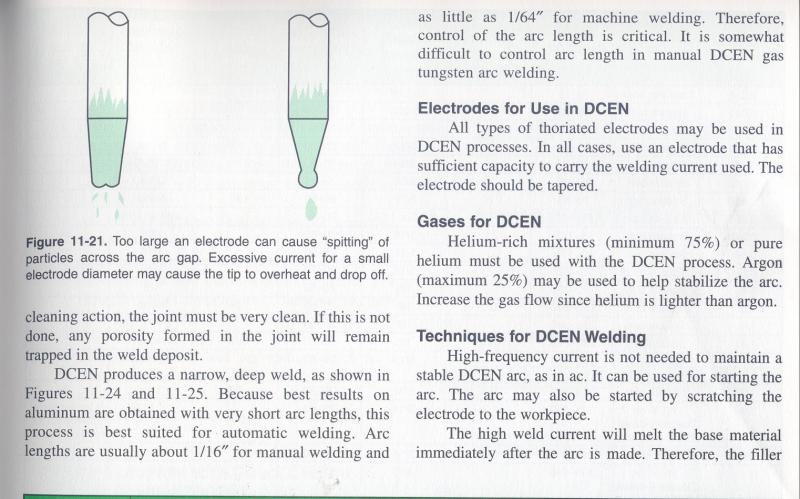

I have some aluminum I want to weld, I know being a DC machine TIG welding with the 150STH is not a good choice. I was wondering if I could add a spool gun and have the capability to weld alum with that. Thanks

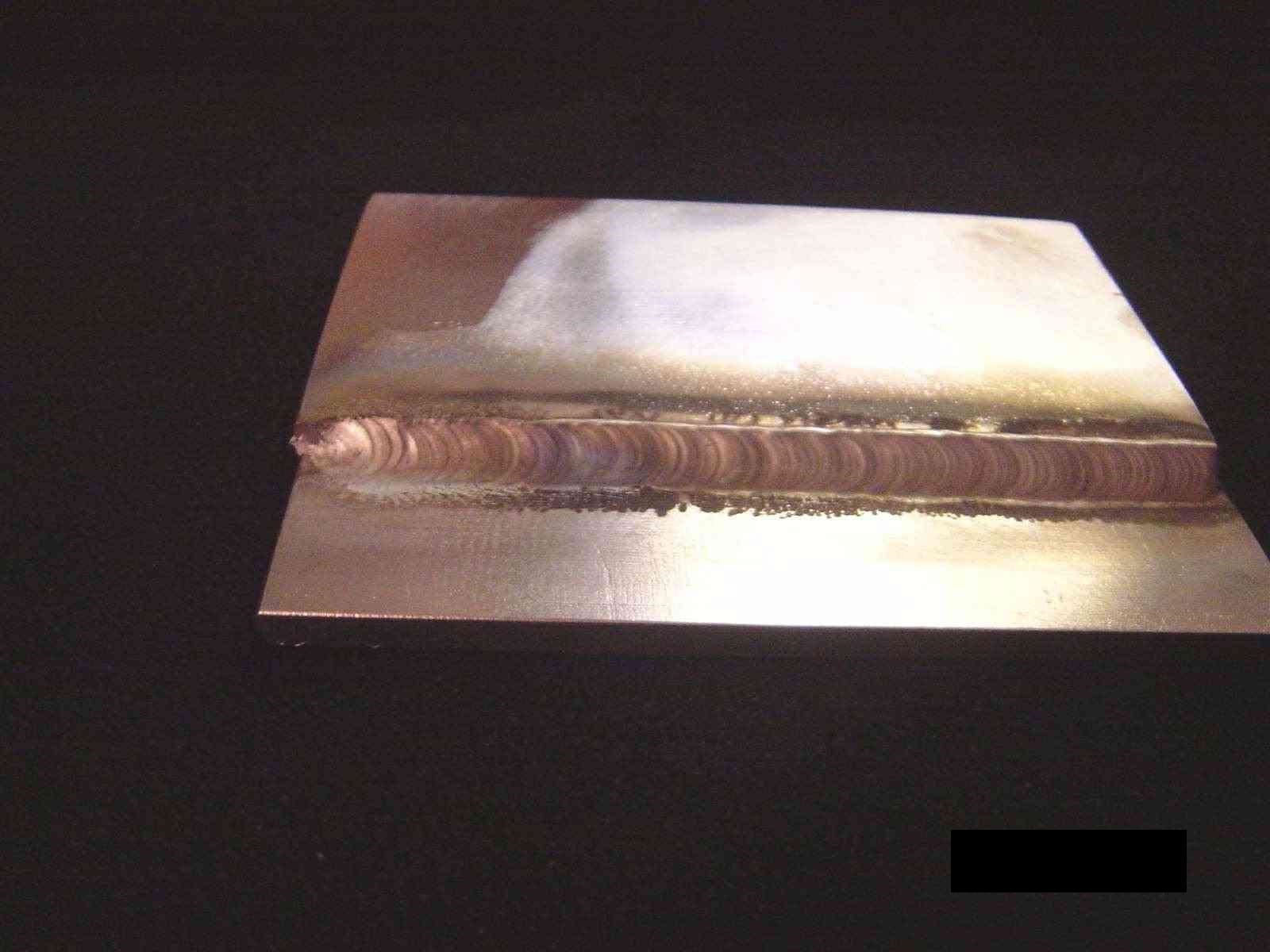

I thought you still needed AC to weld aluminum?
Nope! This weld was made with an Everlast DC only stick welder. Now with DC you won't get the cleaning you get on AC.

I have the TIG setup, with footpedal, I just thought DC welding aluminum didn't work so well. SA what did you use for gas for that weld?
   / Spool gun & Miller Maxstar 150STH #6
Helium. sɐb ǝʌɐs oʇ pǝʇɹǝʌuı ʇı pǝpןǝʍ ǝɥ ʇnq.
I pretty sure that weld was done with 100% argon.
This weld was done with my Miller Dynasty 300, on DC with 100% helium. Now with 100% helium it is about twice the power as with 100% argon.

I knew He would give a hotter weld than Ar, I didn't realize a decent weld on Alum could be done DC Tig with Ar. For my limited Alum welding, getting set up with He is out of my price range. SA, I understand you have only been welding for a few weeks... hopefully in a few weeks I can lay down a bead on Alum that looks as good as yours. :) Can a spool gun be used on a CC machine, or do you need a CV machine?

I really don't know, yomax4 would be a good one to answer that question.
