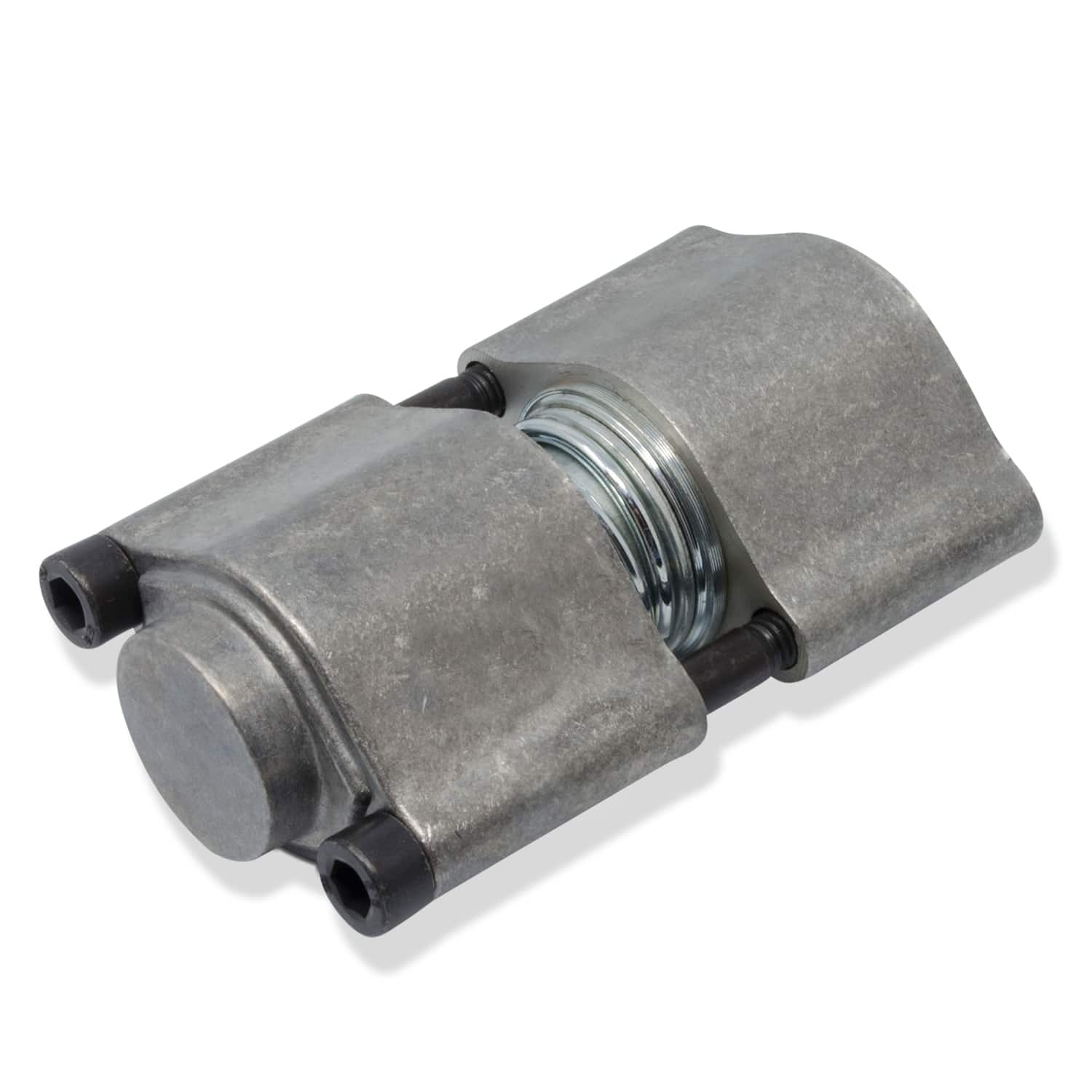

I'm looking to convert my 2 spool (standard A spools) to latching float on at least one spool.
The supplier of my valve has a latching detents available which seems to address that.
However, despite discussing it with them, I am getting confused over how that can work, with the same "A" type spool as I don't see how simply adding a "Detent" can add a "float" function simply by "latching" in the "upward" position, vs having the lever pressed all the way "up". Is there internal "plumbing" in this "Detent" that is not obvious?
I want it to be so, as this is by far the most economical way for me to add a float feature, but, if it does not work as desired, wasted money.

Normally float would require replacing the spool and also adding the detent feature. Spool requires 4th float position and detent feature Depending on valve manufacturer they may or may not sell you the parts to do this conversion.

Correct. A float spool is indeed required, but simply replacing (and/or swapping) spools in most hydraulic control valves is not an option. If you want a valve with a float function you switch to a valve WITH a float function. You don't simply ADD a float function. Yes, you can add a detent feature to some valves. I've done that on occasion, but float is a different matter.

And there's the answer - a control valve made with a float function usually has a detent, but just adding a detent to hold a control in one position doesn't make float.

Further discussion has cleared up the confusion on my part. A different spool and detent are required and apparently not readily available.
I'm not sure I need a float anyway, for the Top and Tilt (just the tilt) but some have said it can be useful in some cases for box blade or rake use.
