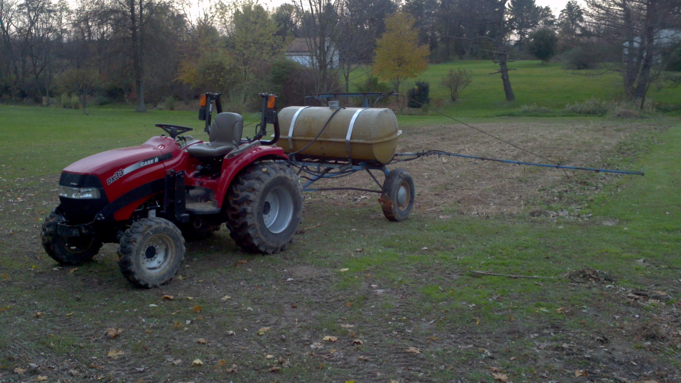

I have a Delavan 66-3110 pump that I am using with a 15' sprayer and I am having a few problems with the pump.
I've checked all other lines and they are clear and have isolated this to a pump problem. I tried running the pump and couldn't get any pressure from it. Even with a short hose and a funnel pouring water in it would barely take in any water and came out like a trickle. It was like the pump was clogged. I took the pump apart and cleaned it up inside the reassembled the pump finding no obvious issues. I put it back on the tractor and it worked great! I ran the pump for about 20 minutes and then stopped. When I went to flush the system on the sprayer.....I came up with nothing. No pressure. Hardly even an trickle. Even when re-hooked up a hose and a funnel to the pump. No pressure out of it. Any ideas on where to even look here?
Thanks for any help!
   / Sprayer Pump issue #2
Try rebuilding the pump. We have had these that look fine but would not draw or create pressure. Rebuild works unless the housing is worn then you need a whole new pump. The tolerances are very tight and once the rollers or the housing are worn you will never get any pressure.
I Stand Alone
   / Sprayer Pump issue #3
I Stand Alone is probably correct, the only other thing that I can think of based upon your testing is the PTO adapter is slipping on the pump shaft.
