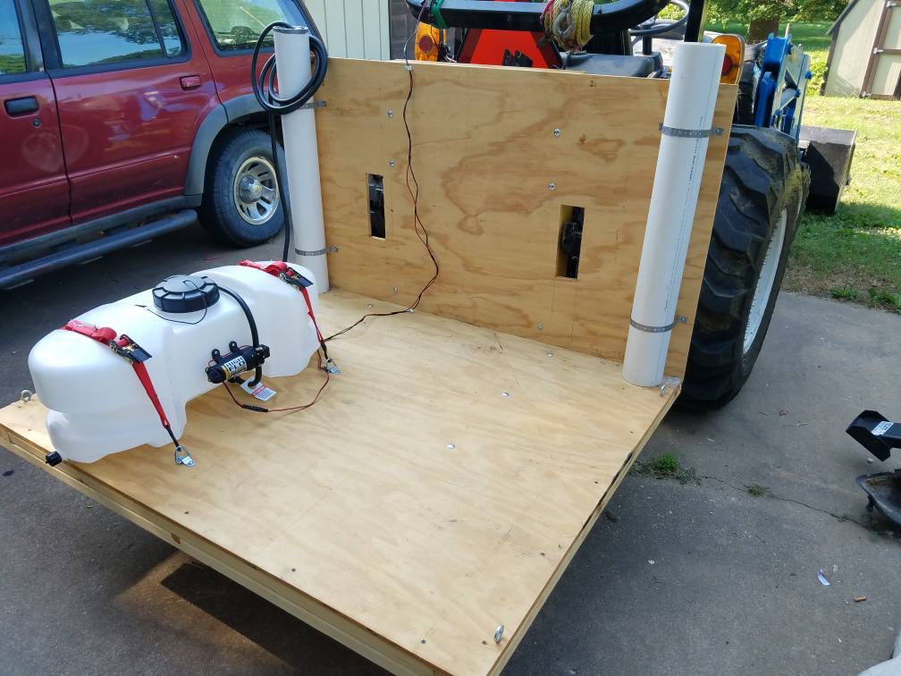

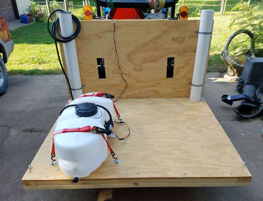

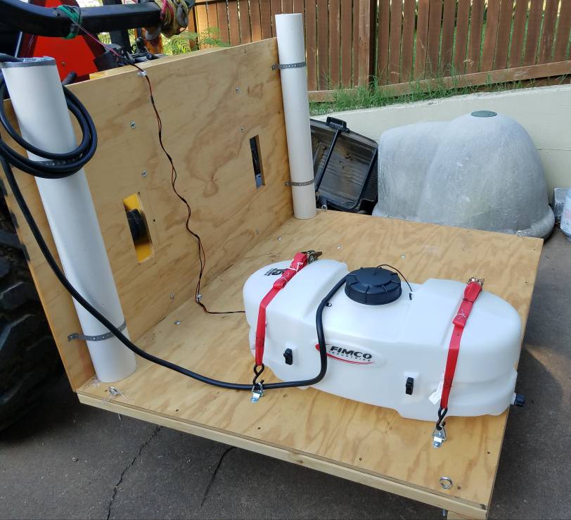

Today I finished setting up my spot sprayer and the electrical for it on my carryall platform. Now I can spot spray the fence line and those small troublesome bramble areas.
I had previously install a 12v power port on the left side of the dash console and will be using this to supply electrical power via a port plug instead of the standard battery hookup. Added 6' to the wiring harness so that it would reach from the console to the sprayer and still keep thd on/off toggle switch handy while sitting in the seat.
Used some scrap pieces of pvc for spray wand and tool holders. Saw that on someone's post on this site and thought it was a great idea. I plan on painting the carryall platform/frame LS blue this fall. 20180610_090403.jpeg20180610_090330.jpeg20180610_085655.jpeg

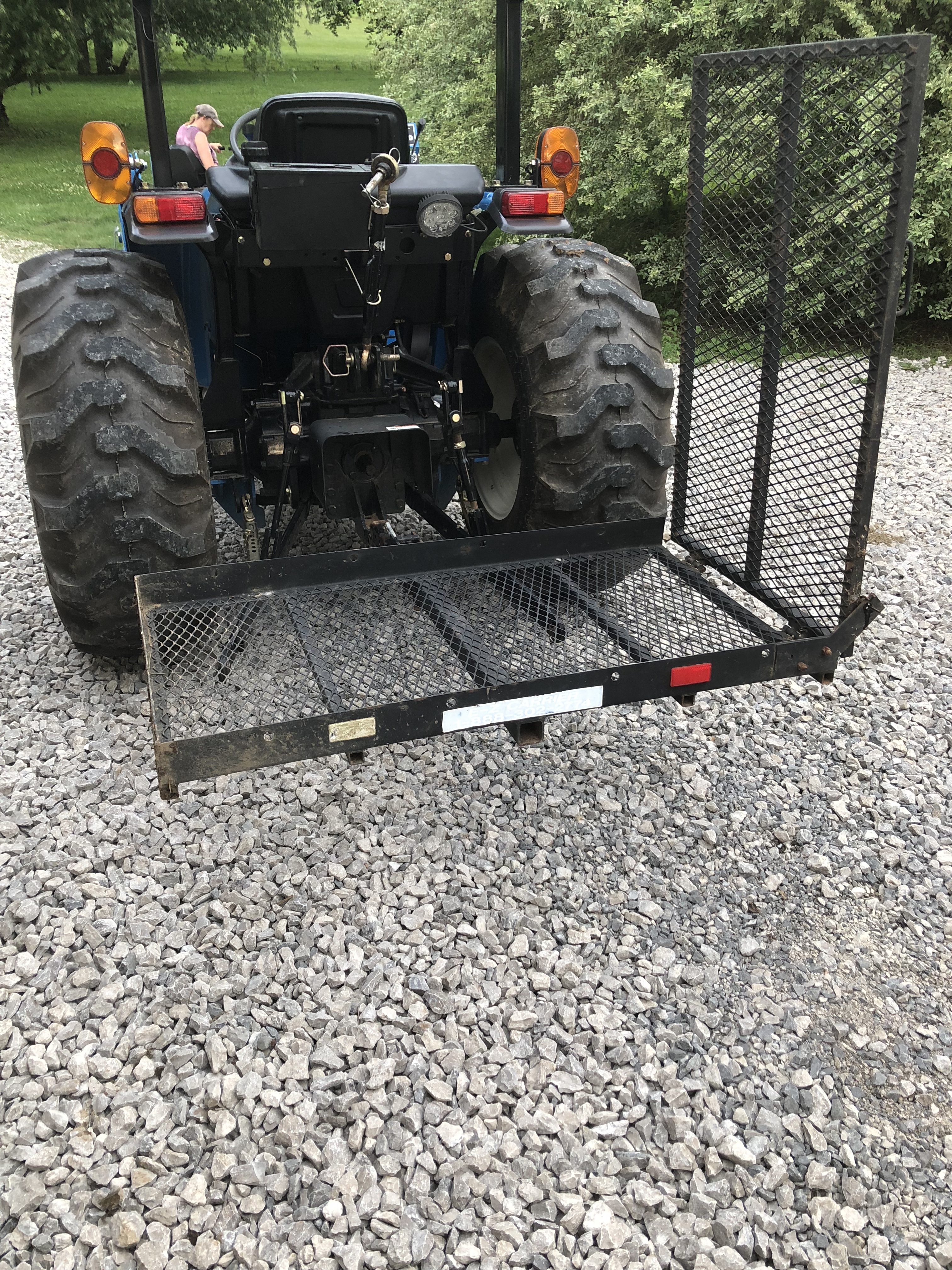

I made a carryall for the same purpose last week, I had a power wheelchair carrier I re-purposed.
