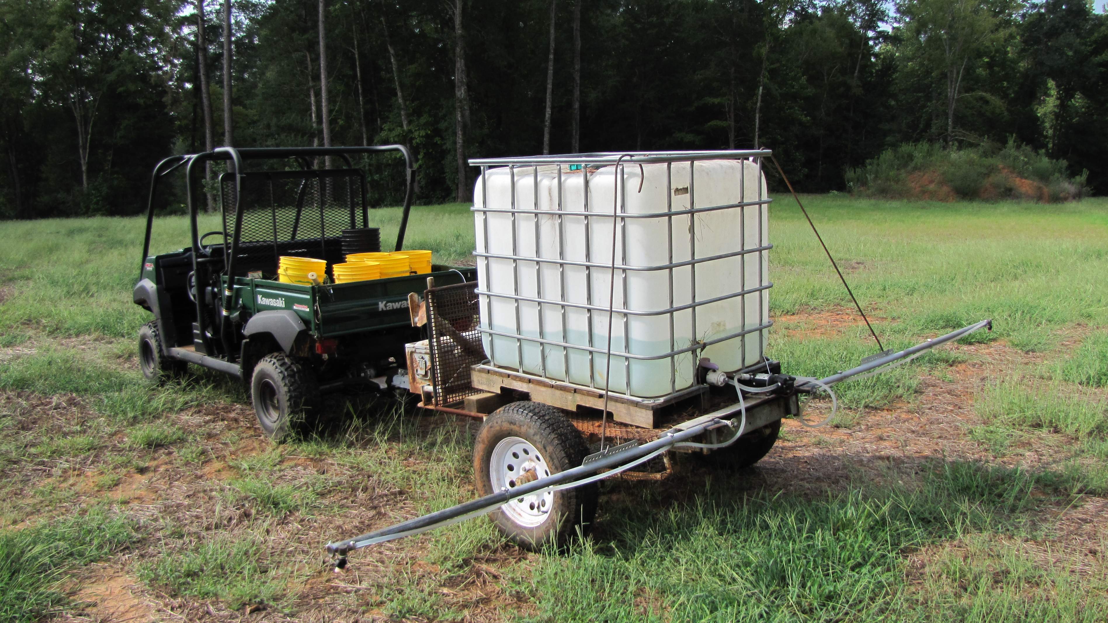

I built my sprayer from a tank that I bought, then a pump and some connections. It plugs into a lighter outlet on my dash and I turn it on and off with an inline switch. Pretty simple, fairly chaep. Tricky getting it worked out, but for something that I use twice a year, definately worth the effort.
