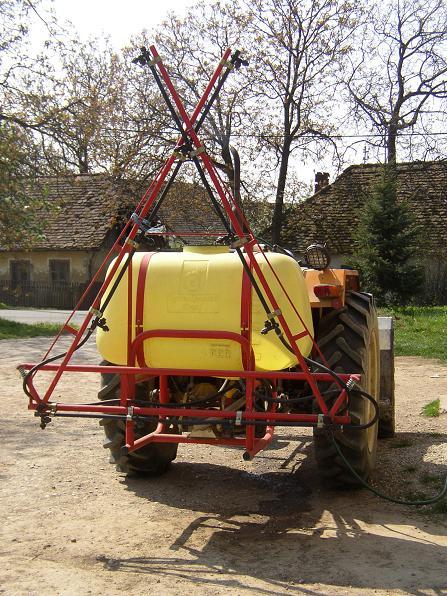

   / Sprayer #4
Just a few pictures on my factory built sprayer. It is 330 litres (sorry, don't know in gallons), with 240" wide boom.

   / Sprayer #5
It has 3 part boom...

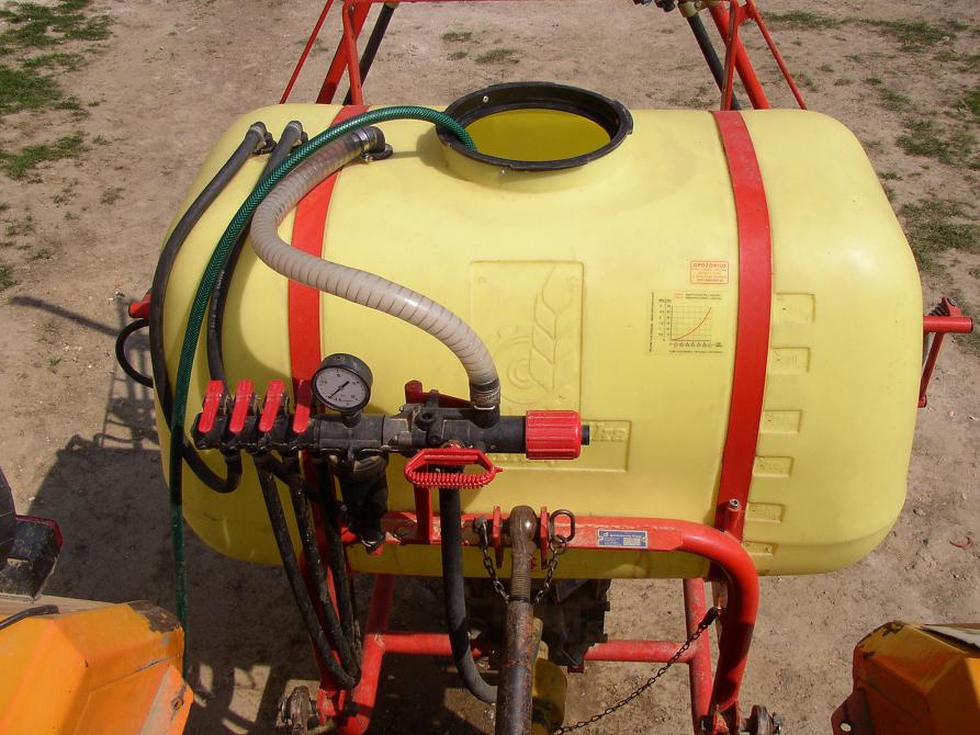

   / Sprayer #6
Close view to pressure regulator and valves...

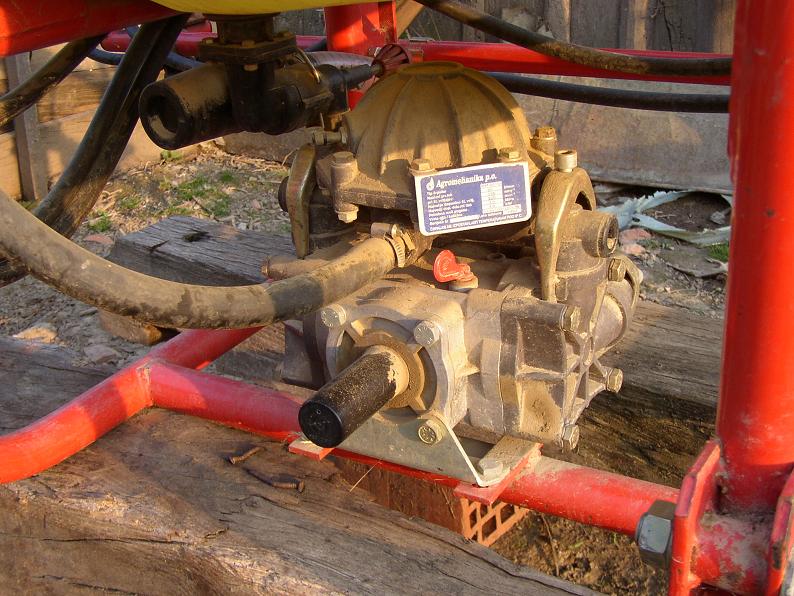

   / Sprayer #7
...And finally look at pump. It is 2-piston-membrane type.
Try to find centrifugal type pump. It will be cheaper, enough for 30-50 psi, and will work fine for you. /forums/images/graemlins/wink.gif
