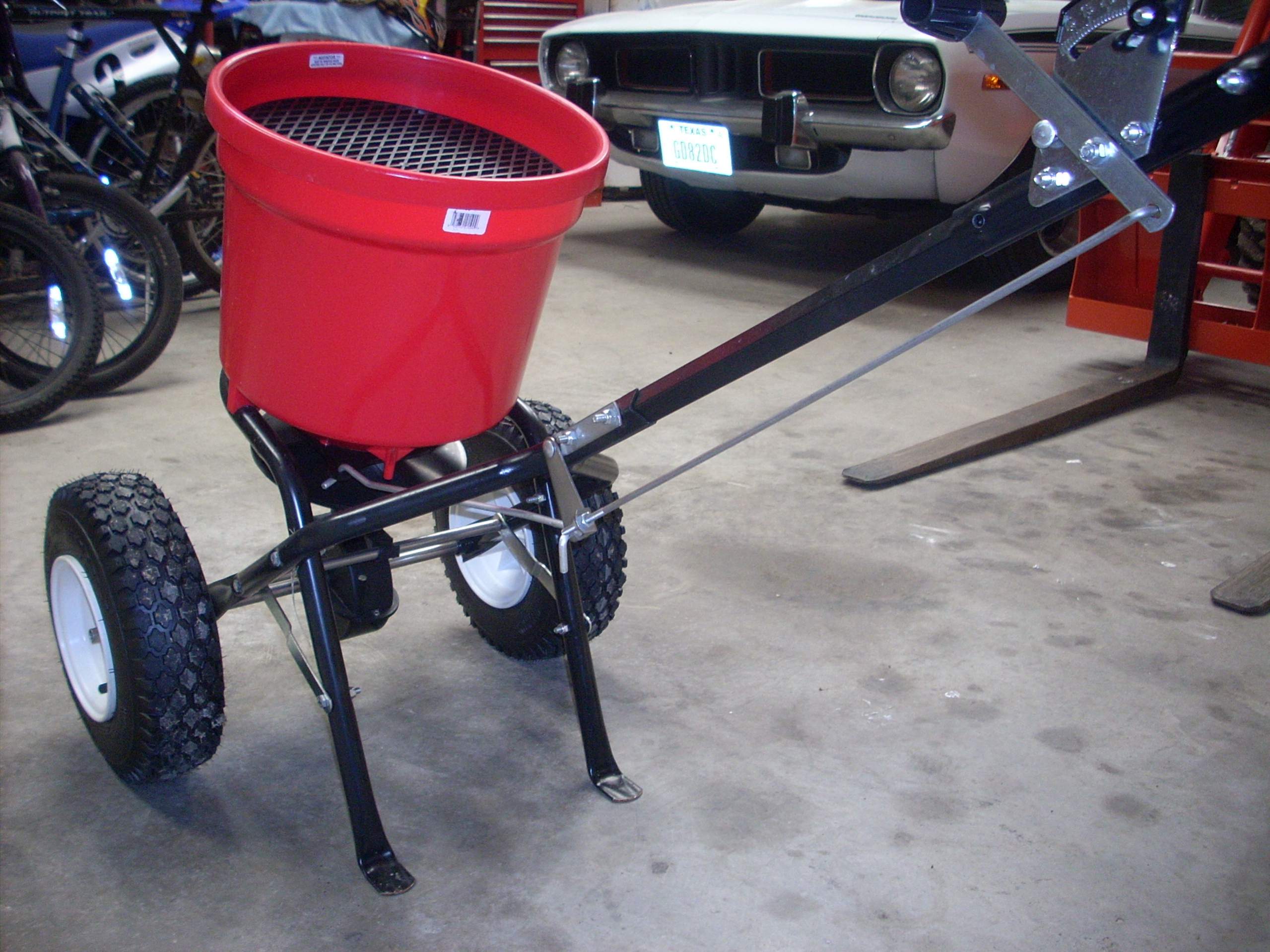

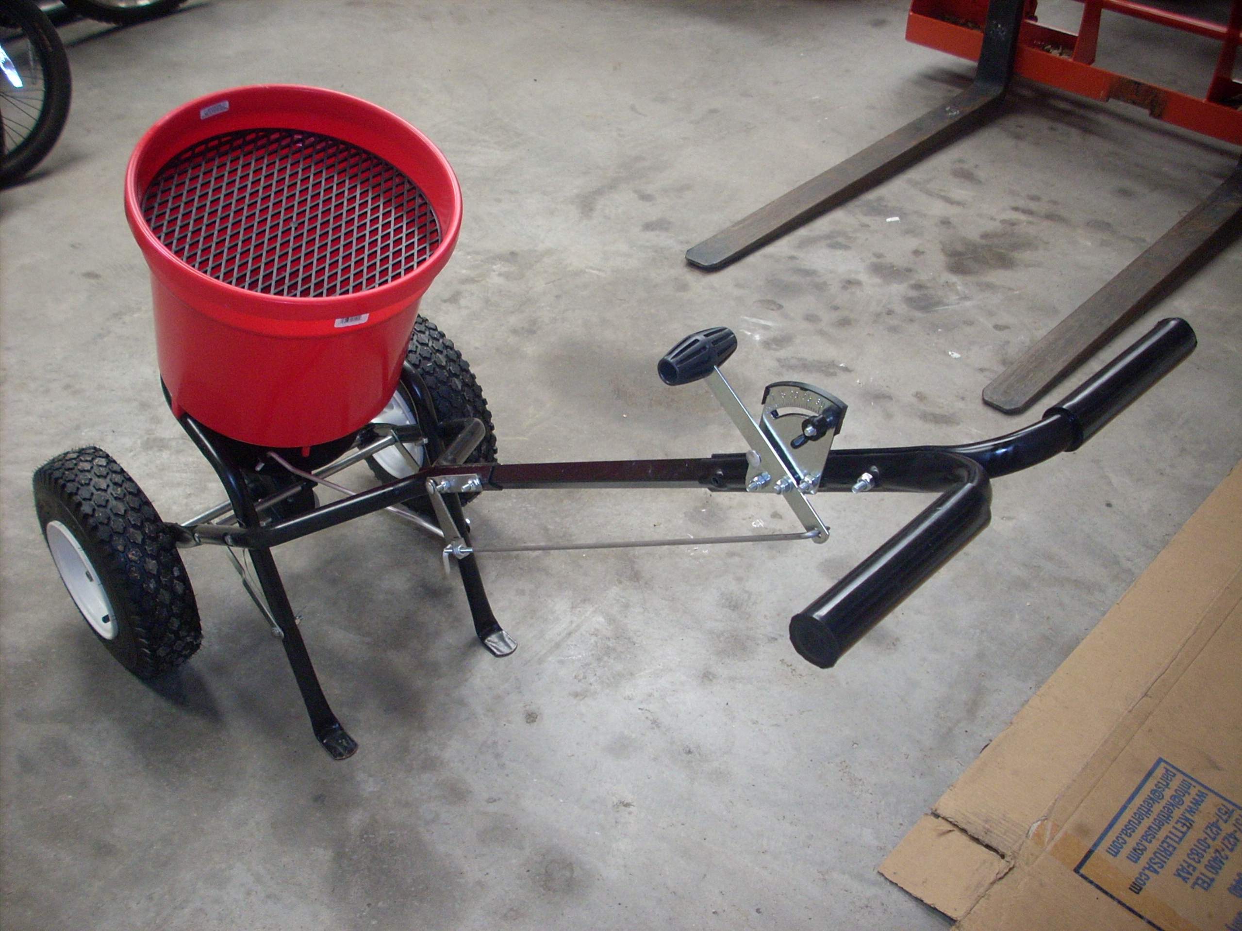

Hi Roger,
I was just going through this myself and ended up buying this Earthway broadcast spreader for my little over 2 acres of lawn. It seems a little expensive for a walk behind, but it does an excellent job. I can cover the lawn pretty quickly. The spread settings are based on a 3 mph walk. Have you looked at the pendulum spreaders? Pricey, but sound nice. I included a link to a pendulum spreader from Agrisupply to give you an idea on price. I think I will try to buy one eventually, but the walk behind will do until then. Good luck in the search.
Amazon.com: Earthway 2150 Commercial 50-Pound Walk-Behind Broadcast Spreader: Patio, Lawn & Garden
Pendulum-action Spreaders - LSU AgCenter
Fertilizer Spreader, Fertilizer Spreaders, Seed Spreader | Agri Supply, 76160
