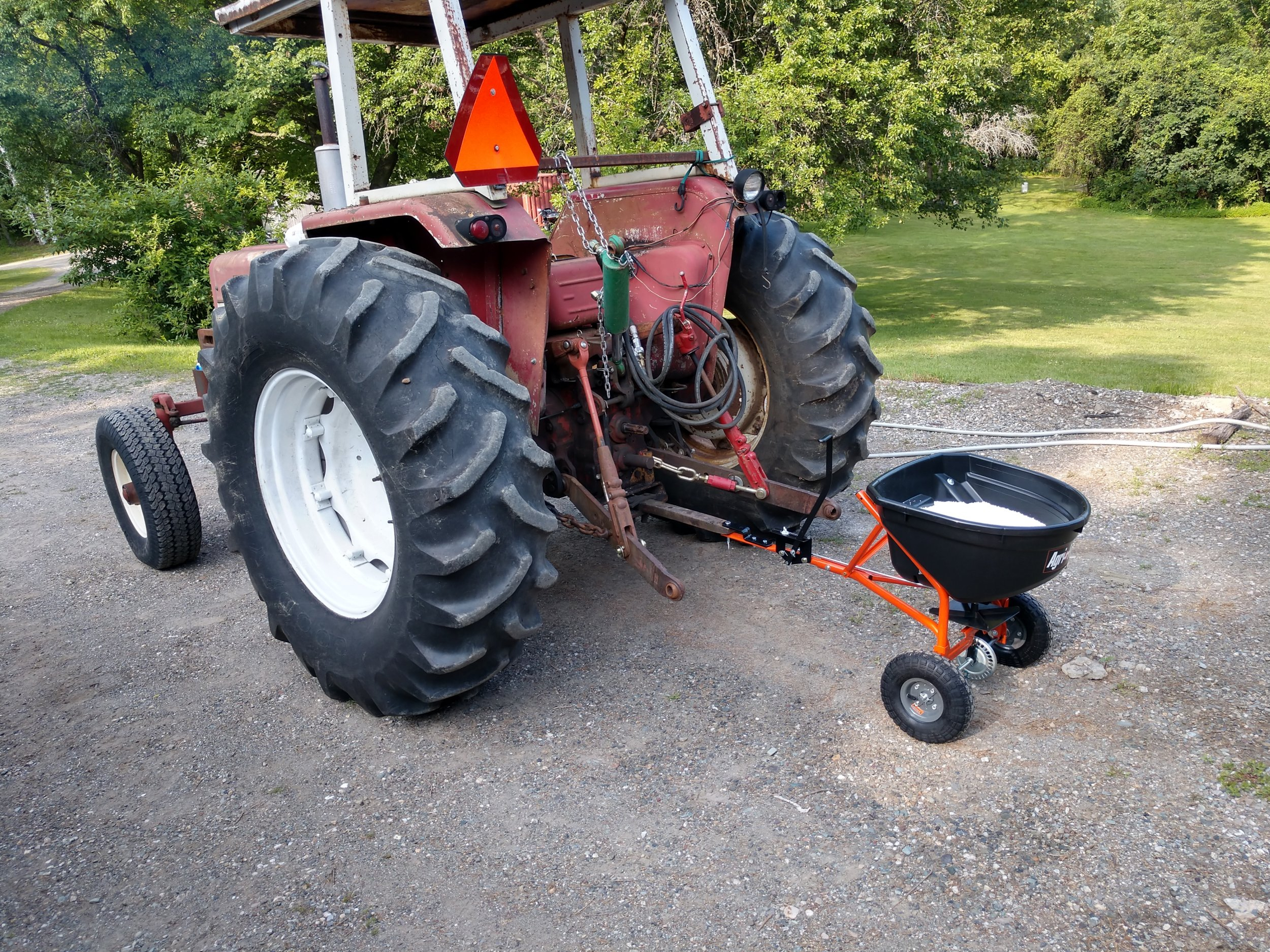

Probably better off with a little walk behind spreader
Snowex 100 lb. capacity Broadcast Spreader SP-65

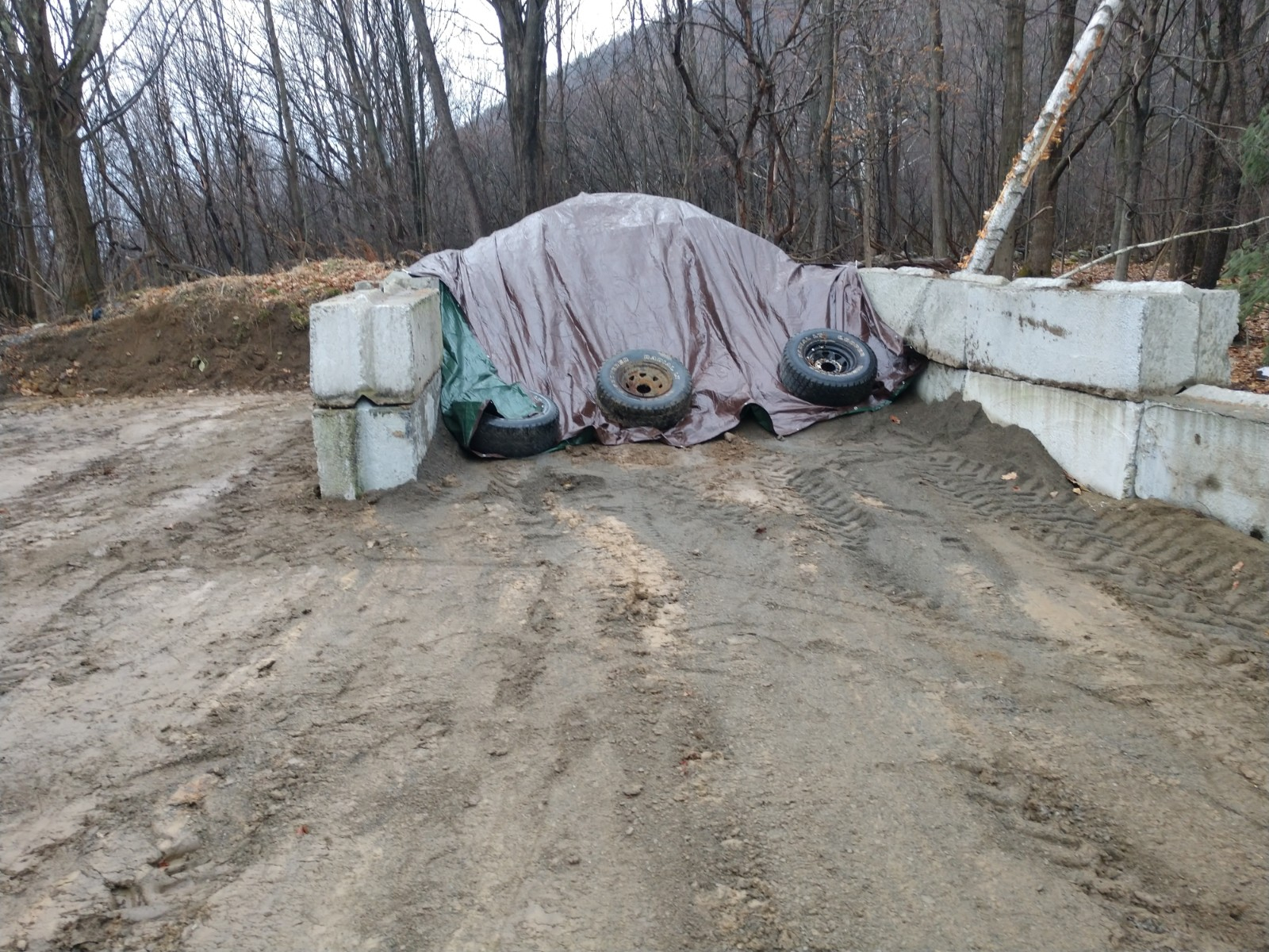

That sounds real good, just one minor little thing.
When it gets cold sand piles freeze so unless you can bust through a foot or two of frozen sand to get to what hasn't froze you will not sand much.
And as soon as you break through it will freeze there.

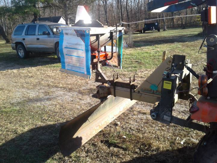

I get a tandem or tri-axle load of salted sand every year or two for my long steep driveway.
Don't know what is going on tonight had to edit my post the first time both pics came up as attachments, and I couldn't open them.
   / Spreading just a tiny amount of road salt? #9
I hear you, where I grew up is about 2 degrees of latitude further north (and a lot further west!).
I cannot believe you don't keep your sand in a climate controlled building. Haha
The sand is not freezing solid, that is just all of the moisture. If you have a way to keep it dry, it would be fine. Of course, that may not be practical.
