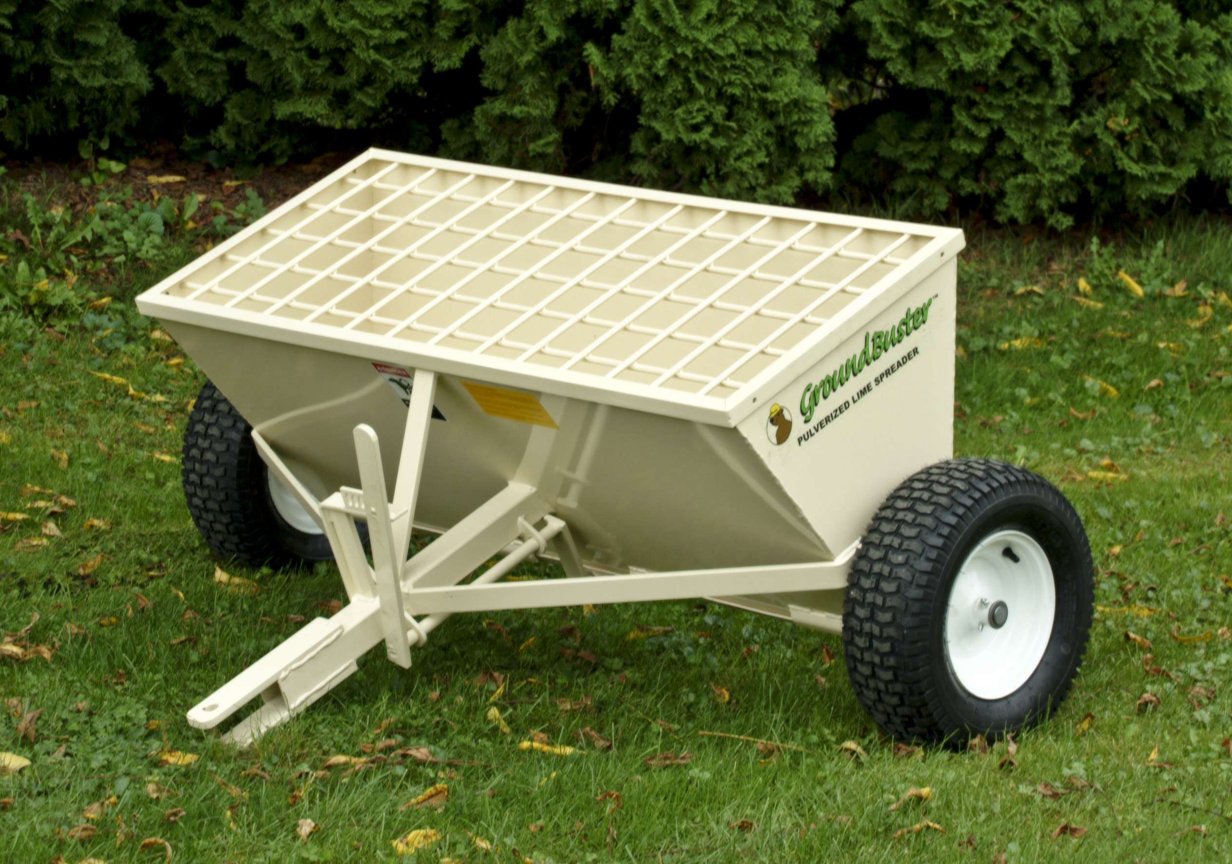

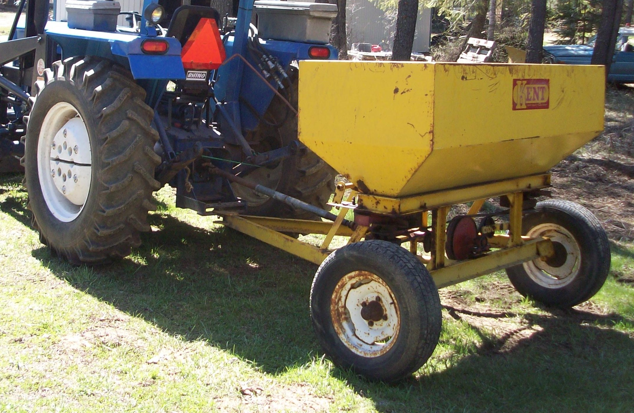

You need a drop spreader. A spin spreader will not work with powdered lime and will break within moments. The material is simply too dense and compacted. Pelleted lime will usually work, however if you don't put too much in at a time. If your area is not too big you could put it down with a lawn drop spreader.
Here's a pic of an old and modern drop spreader, also called a "lime sower" by some.

Those are what I need! Save my arms flinging lime with a shovel gets old quick.

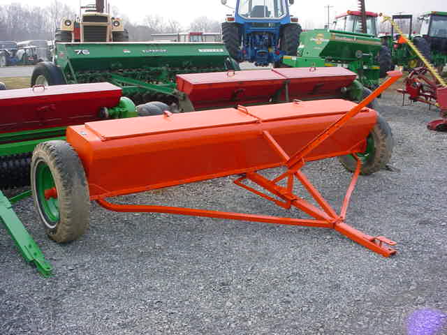

Something like this should work well, I spread lime with it and it also worked for spreading seed. agree that Lime is expensive
