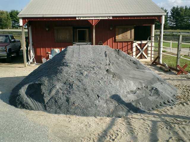

Well, the estimate my wife was given that 22 tons would be enough to put a 1 inch layer on top of our ring was way off. Here's the pile of stone I started out with this afternoon at 4:30 PM.

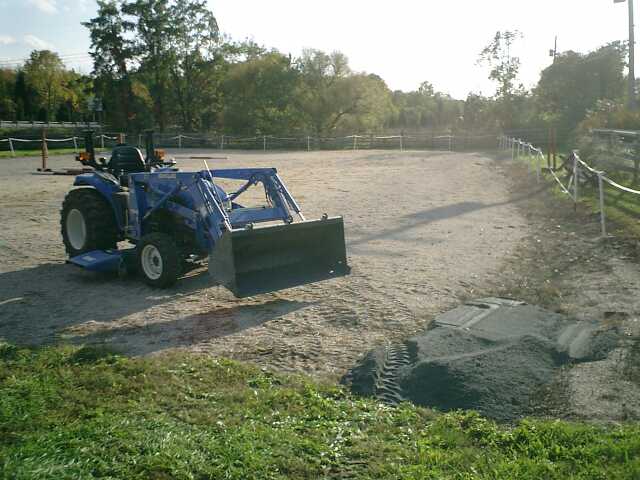

Here's a shot after the first 2 FEL loads were dumped. This side of the ring had some major wash out from a rain storm, so the first task was to fill this in.
