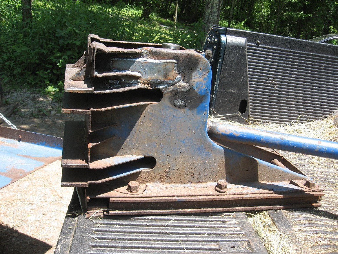

The ongoing trouble with my Ford 532 baler is in another thread, which is getting rather lengthy. I finally discovered after several steps (broken needles, maladjusted needle retarder, knotter issues, etc.) that my plunger was bent and busted, so the safety stop no longer touched it. So, I've pulled the plunger and it is at the welder's getting repaired. One roller bearing was in pieces, and so I'm replacing that too.
I thought I'd start a new thread as my next question has to do with reinstalling this plunger. It seems like this is the time to sharpen the knife along the edge of it? Also, I've heard talk about "wedging," plungers for adjustment. I'd appreciate any advice on how to best tweak the plunger for optimal performance while I'm up to my elbows in this project.

The damage to the plunger really looks as if it could have been caused by the safety stop itself. That point is peeled backwards which seems to have caused all the additional buckling around behind. I noticed a bit of welding has been done before on the surface in this area, so I wondered if there was an old injury that weakened that area of the plunger, and either a few good smacks into the safety (for whatever reason) buckled the whole deal, or perhaps something like the neighbor's kid's bike found its way into the area as well, adding to the wreck.
Thanks for the info on the knives. I don't have a manual still (I was warned that the timing info in the original manual was wrong and caused guys all kind of trouble...just a side note). Perhaps I'll go with the 14t recommendations you provided and see how that goes unless I land the 532 spec.s in the mean time.

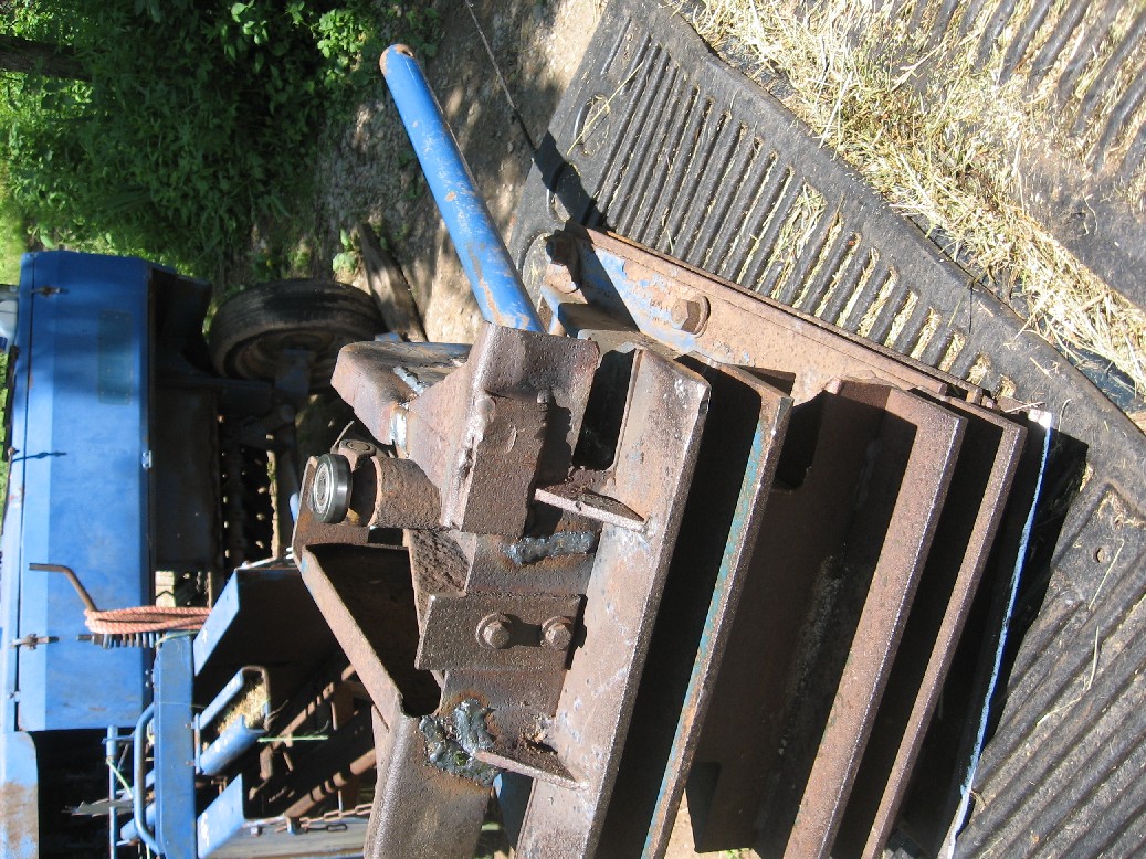

Plunger is in! Here's a few pictures of the splendid repair. Once in position, with new roller bearing and everything looking good, I was amazed at how easily the plunger rolled along without any resistance. Before I reconnected it to the crank, it literally rolled back and forth with hardly a touch. And, blades are hollow ground. Can't wait to see how this does now.

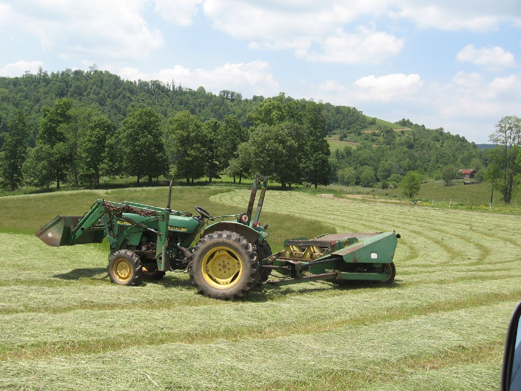

I'm adding a picture of the little jd 850 with the jd 1217 haybine setting in the midst of its work yesterday. I mowed all day and only burned about 5 gallons of diesel. A little slow going uphill, but not bad.
