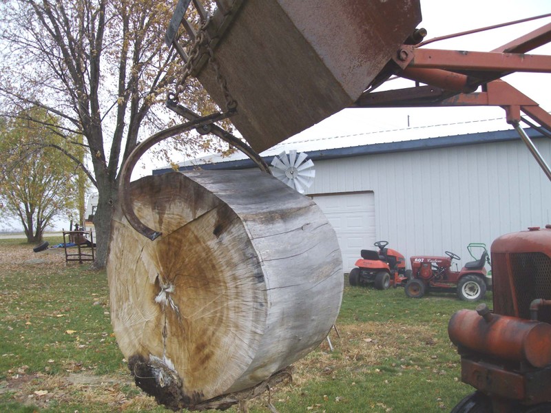

I have been thinking of building/buying a log splitter that is attached to the FEL and runs from the 3rd remote (otherwise used for grapple). I like the idea of an inverted splitter, so I can set it down on top of large logs and split them in-place without having to man-handle large circles.

I have another stand-alone splitter that I use for much of my work, but I have a big pile of very large circles that need to be split, and I couldn't lift them onto the splitter without using the grapple (which isn't really safe). Additionally, I have an arborist friend that will bring me large logs that he can't split easily...thus I get free wood delivered to my home by way of very large circles. I just need a way to split them without killing my back. Once they are in managable sizes, I *can* use the stand-alone splitter for the work. Thus, a somewhat slower cycle time isn't terrible for me, but I don't want to be waiting minutes between splits.
