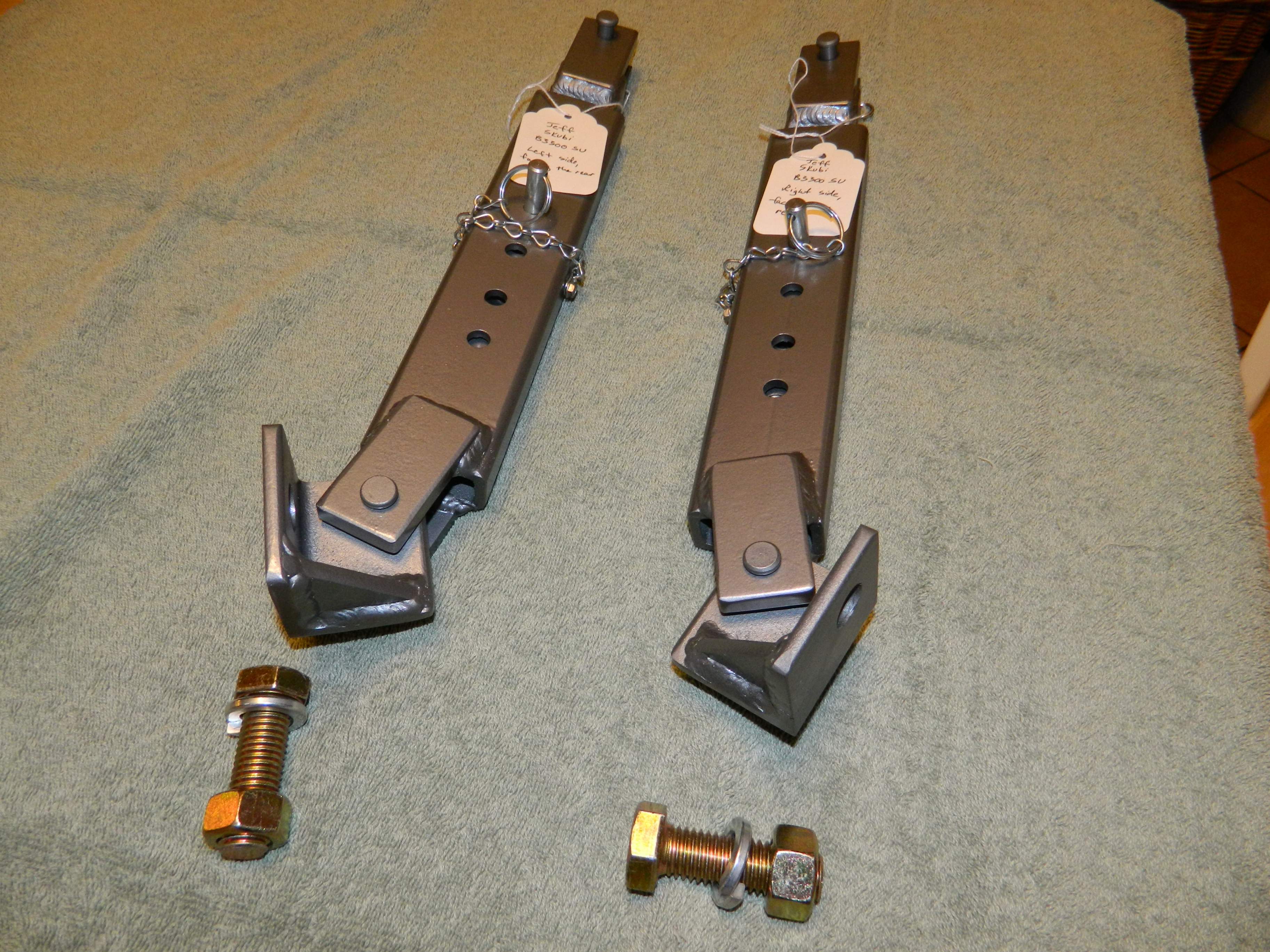

Mark Hodge makes pin adjustable rigid stabilizers to order.
His mech for my Kubota B3300SU was less than $200 delivered/both sides.
He does quality work and is a nice person.
RIGID stabilizers are much stronger than TURNBUCKLE stabilizers.
If you often PUSH a bush hog into brush, or PUSH with a box blade, you need rigid stabilizers.

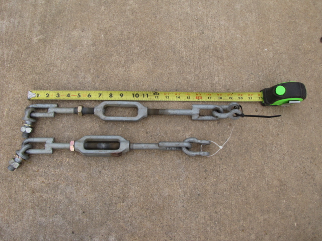

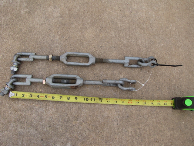

Here are the ones I was talking about. There is 3" adjustment in them. These came off a L2800 Kubota. Make me a offer.
