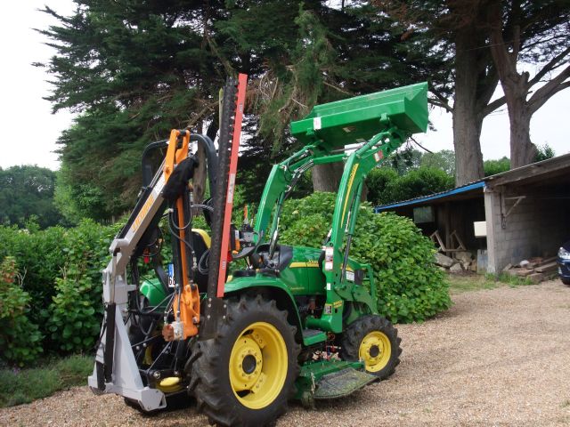

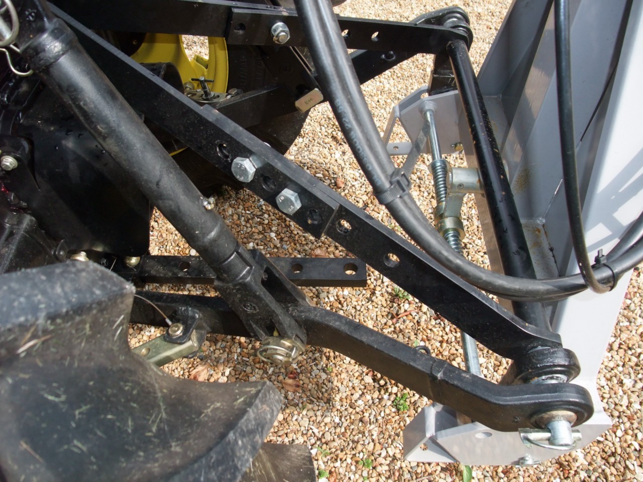

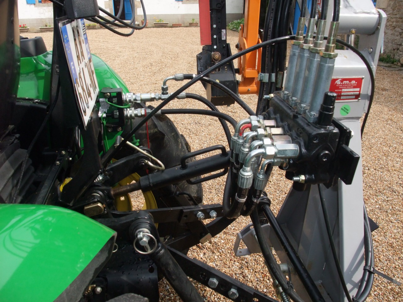

For heavier or bulkier implements, stabilizer bars are recommended. They are 2 adjustable metal bars that you put on your lift arms to increase rigidity. I use them with the hedge trimmer on my JD 3520. They are quite efficient.
That is quite the hedge trimmer!!!!!!!!!
   / Stabilizer bars for PHD? #5
The 5 foot cutter bar does a quick job, but the beast is quite difficult to handle, especially when the ground is not perfectly flat, which is the case most of the time.
