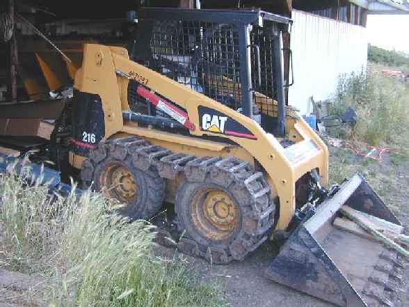

My experience is with my Cat skid steer. I have the steal grouser brand tracks for it. They transform that machine into a tank. I have cleared blackberry thickets in really steep areas. When I say steep I mean that the only thing keeping me in my seat was the seat belt. I have also used it for logging after a storm took down a bunch of trees on the property. Since the weight is all in the back you can drive down a very steep bank and back right up it. I have done some work sideways that was really scary, but knock on wood, it hasn’t tipped yet. The tracks make the machine more stable and mud is not an issue with them on. They do tear things up and track mud on the driveway but if you ever get a skid steer and intend to use it in mud during the winter just buy them when you buy the machine. I usually put them on with the first rains and take them off when things dry up here in the northwest (late July /forums/images/graemlins/grin.gif).
I have looked at the ASV and CAT track loaders. They have really low ground pressure. I once asked the CAT salesman what the price difference was and if I remember right it was about $7500 more for the same size machine in track version. I have a friend that used one on his place and he was impressed with how much smoother they were to drive than a standard skid steer. I can believe that. My skid steer drives smoother with my tracks on. I can be more aggressive with the controls with them on also because it won’t buck around as easily.
In general I highly recommend skid steers and even better the tracked versions but the track vehicles are a fairly new thing and will be expensive. Since you already have a nice tractor you may be better off hiring this specific job out or renting a dozer if you can’t stand watching someone else have all that fun. You would probably be money ahead.

One thing i hate about my companies new holland ls170, is the grouser tracks. We have the tracks on the skid steer the paddles would knock the back tires off the rim and would have to wait a few hours to get someone out to fix it. Not to mention another 30 taking the heavy tracks on and off. Now that the job is mostly concrete we have the tracks in storage.
   / Stable on slopes with mushy ground? #8
Chechnya
I have those grouser tracks. You can see them in the attachment to my previous post. I have never had that problem. I’ve been running them for three years now in mud, concrete, and manure piles. They work great. Are you sure that your air pressure and tension were OK?
