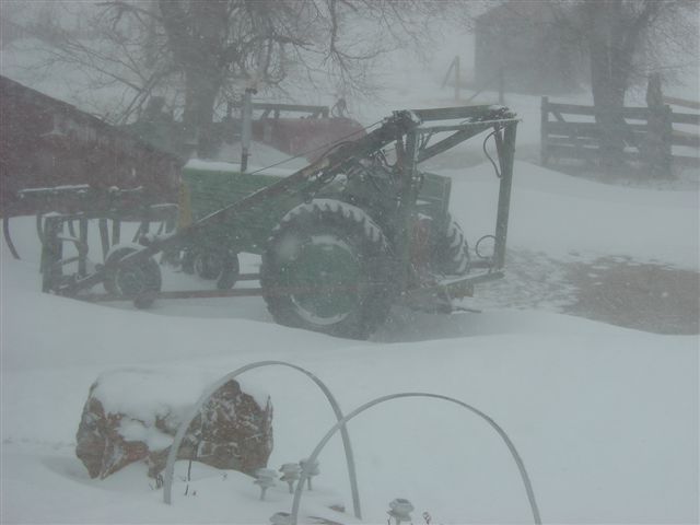

Yes we use an old farmhand stacker for that. A F10 to be exact. I thought I had a better picture of it handy but this is the only one I could find without digging for it. This is the winter mode where it is on the Oliver 77 and the grapple head on it instead of the hay head, in the summer we have a "farmhand truck" a 1952 Chevy Viking ton and a half truck with the rear removed so you can buck hay with suspension and a synchronized tranny.
