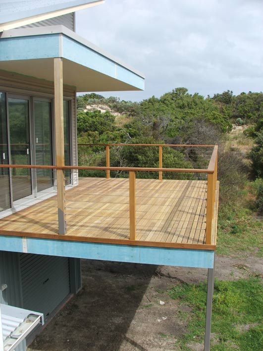

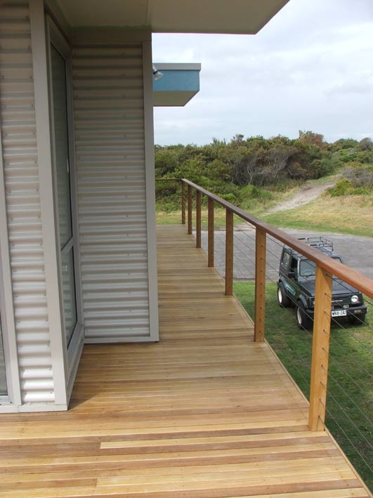

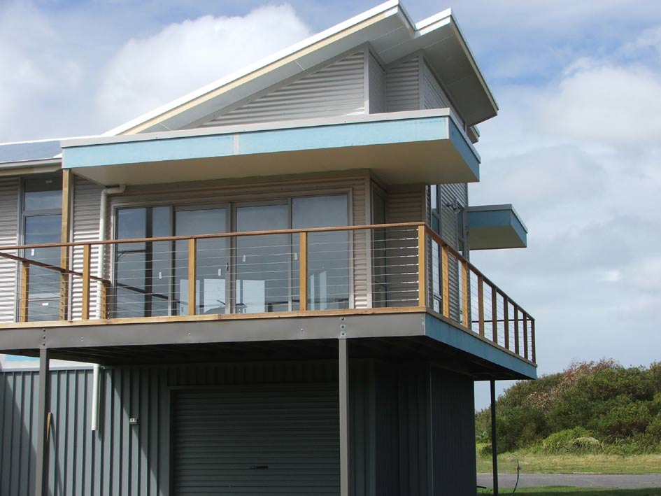

The deck, posts and handrail were installed by a carpenter but I installed the wire myself. Thank heavens I had the wire pre-swaged. This only cost about an extra $5 per strand, and not only is it much neater because it eliminates a thimble and swage at each end, it saved me about 3 days work and worry. (I didnt realise until after that if I'd tried to do the swaging myself I would have had to swage it AFTER it was threaded through the post holes. It would have been a really tedious job). Pre-swaging cost me about $250 extra but a good swaging tool would have cost about $100 anyway. So in hindsight the extra $150 it cost for pre-swaging was a bargain. All I had to do was measure each length nice and accurately. One turnbuckle on each length provided enough adjustment, except for the longest side (13 metres) which has a turnbuckle at each end.
I had no real problems except the wood I was drilling into was extremely hard and I snapped a few stainless steel screws.
I think it looks good. It doesn't block the view and it was much cheaper than getting a fully timbered fence around the deck. Hopefully it will stand up to the sea air.

It looks good - both the stainless wire and the deck stain color. The whole place is looking good!
I'm preparing to stain my deck this coming weekend, I'll be using Cabot's 'Naturals' stain in 'heartwood' color. I sampled two colors of Australian Timber Oil (also from Cabot). It's not as opaque as I wanted, but looks better than the other stain colors. I'll just redo it a year, or two, earlier!

I really like the clean look of horizontal wires - it really lets you look through and see you estate, and whacks a bunch of maintainance issues.
You're lucky to be able to do that. There are code restrictions here that prohibit horizontal ballisters - too easy for kids to climb over. Nice job.
   / Stainless steel ballustrade wire. #5
Looks great! I was tempted to use ss cable or clear tempered glass balusters on my deck. In the end we used round powder coated aluminum spindles.
We have that restriction for pool fencing but I haven't heard of it for balconies too.
