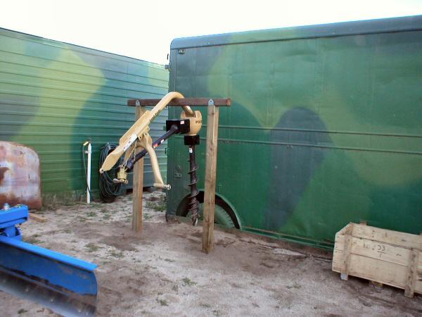

   / Stand to store my Post Hole Digger? #5
Doug, this is what I use and it works very good, not portable though. 4x4's, a couple of brackets to hold the top removable 4x4 and some screws. Less than an hour to install.
Brian
