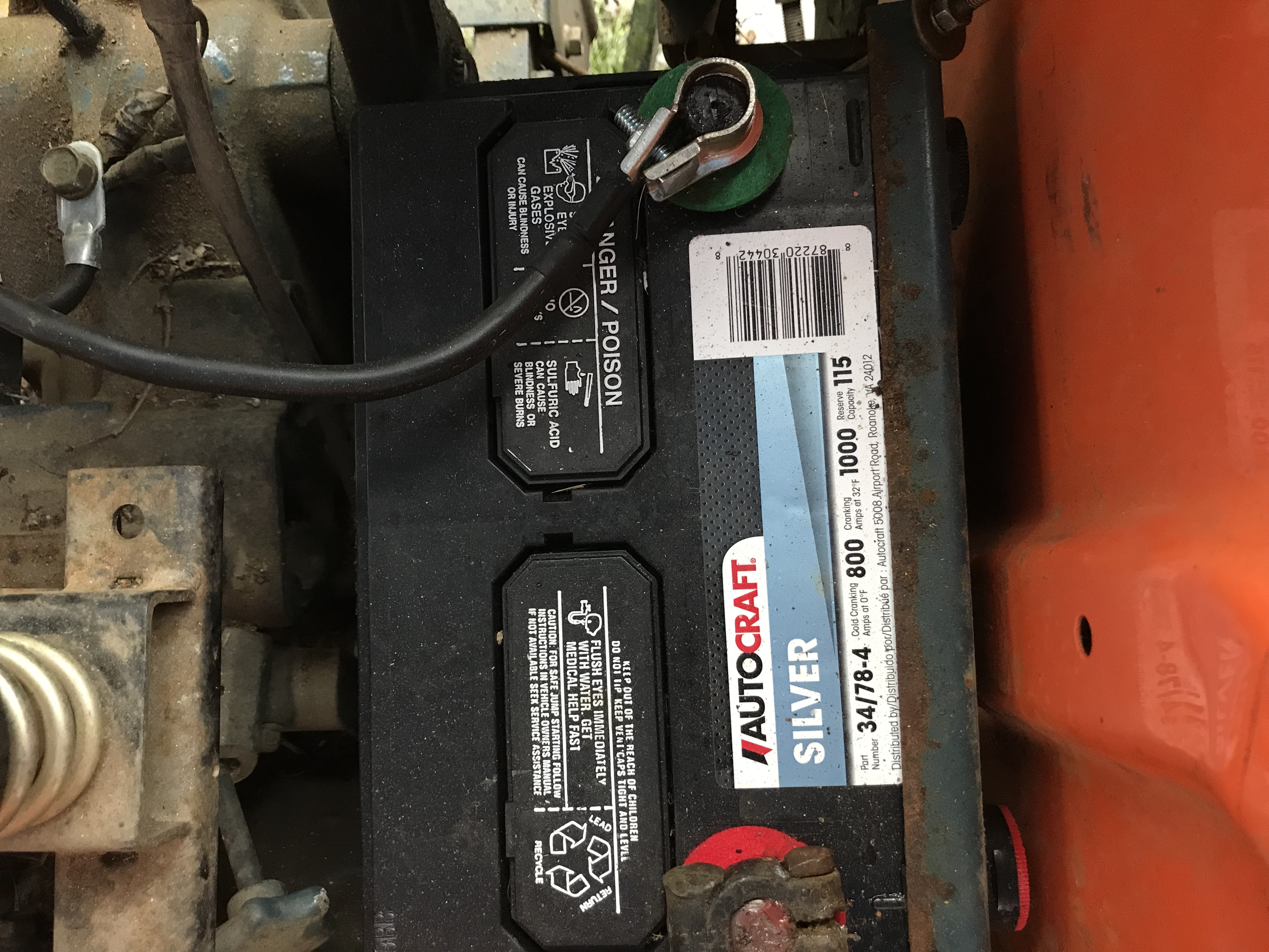

My tractor battery died. Went to Autozone to get a comparable battery. They couldn't match it perfectly so I got the closest thing.
I can eliminate a whole lot of problems because I can jump start the tractor from my car battery. As soon as I hook it up to the jumper cable the lights and gauges come on and she fires right up.
I can eliminate a starter issue, spark plugs, battery cable issues, bad fuses, etc.
As soon as I disconnect the jumper cables, all the lights and gauges go dead. Tractor still runs fine but no electric features work.
I'm kind of stuck with the idea that I bought a dead battery.
Is there anything else I should try before returning the battery?

Measure the battery's voltage at the posts and at the terminals. You can check if the battery is dead or if the terminals are not making good contact with the posts.

It's measuring 0.0 on posts and terminals. It must be a bad battery. I've just never heard of anyone buying a dead battery. It never worked so it must have been dead from the start.
I left it hooked up to the car for a direct charge for about 30 minutes and still nothing. I've been trickle charging for about 16 hours too with nothing. I don't know if my charger can handle a car battery though.

Offhand based on that picture, I would re-attach your negative terminal on the battery as the clamp is sitting up too high on the terminal and it looks like it is loose as I can see between the clamp and the terminal.
I would also take off where the negative cable connects to the frame and clean that up and then reattach it with the negative cable from the battery on the bottom so that it is the closest to the frame with the smaller terminals on top of it. That should give you the best possible connection for your negative terminal.

Great suggestion. I really struggled to get that negative terminal on that post. I may replace it entirely before declaring the battery a dud. Let's assume the negative terminal is the issue. Was I able to jump start the tractor with no problem because my car battery is properly connected to its negative terminal?

Correct (if the battery is broken inside so that the terminal is not connected).
I would try loosening that nut up all the way and seeing if it will slide down like the one on the positive terminal is.
when you measured 0 volts, that was on the actual lead terminal of the battery itself? Or was it on the clamps for the wires?

I measured on both. Both measured 0.0. I guess it could be a loose negative terminal. I'll try that first, replace the terminal, and then get the battery tested.
   / Starting Issue - Kubota B8200 #10
Ascertain that the battery has 12.6 VDC open circuit voltage before attempting to put the new battery into engine start service. Using a smart battery charger, charge the new battery overnight at about 5 amps. With the engine running at fast idle, measure the voltage at the battery. It should read 14 volts or higher. It appears you have installed a new negative battery cable sometime previous to taking the photo. The negative battery cable clamp is poorly installed and the clamp looks to be overtightened. Correct that and route the negative cable so it does not cover the battery cap. Remove and clean the chassis negative battery cable connection. If the new, charged battery does not start the tractor, it is defective.
