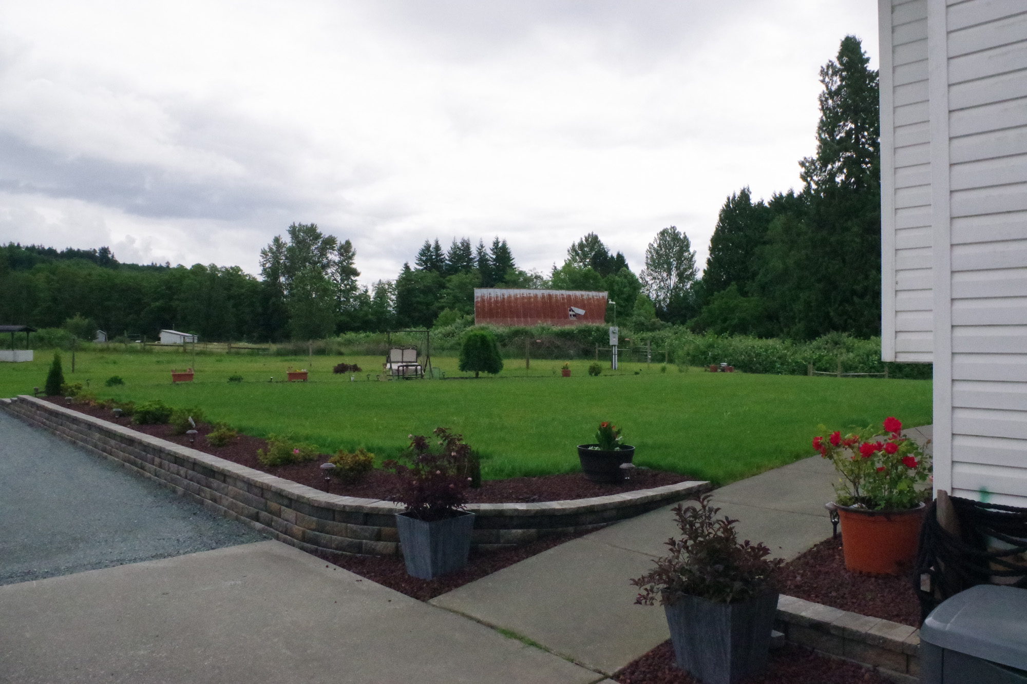

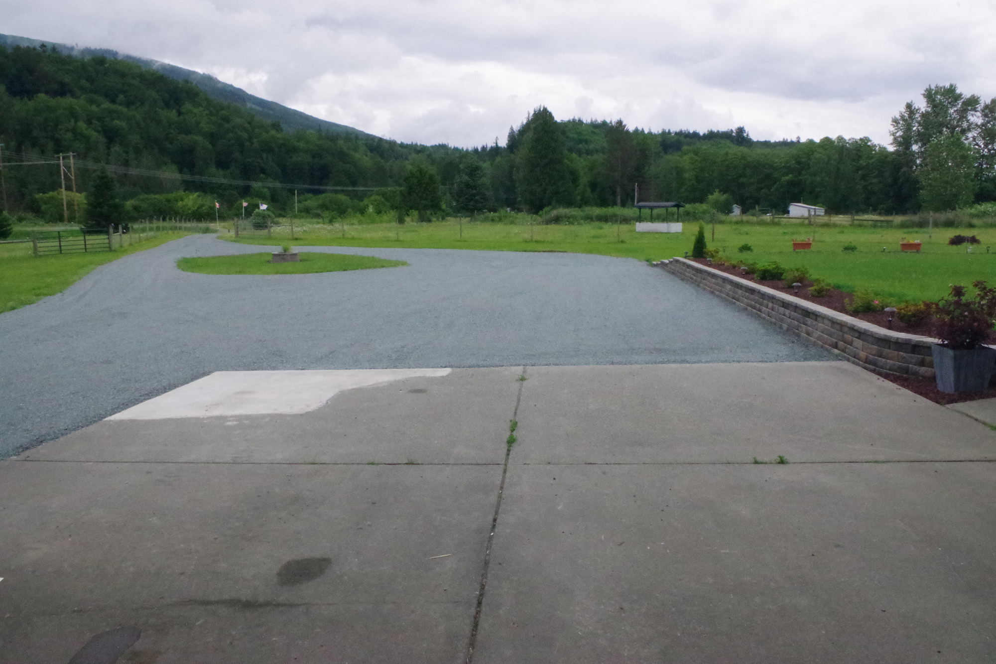

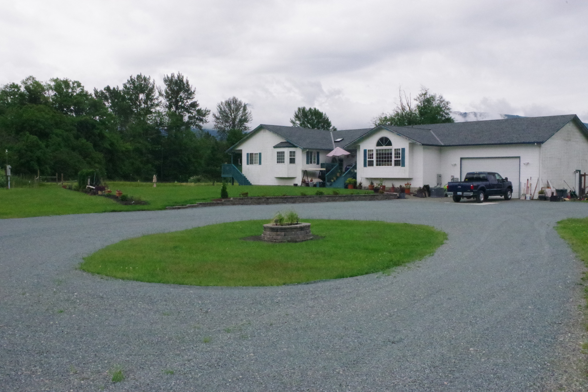

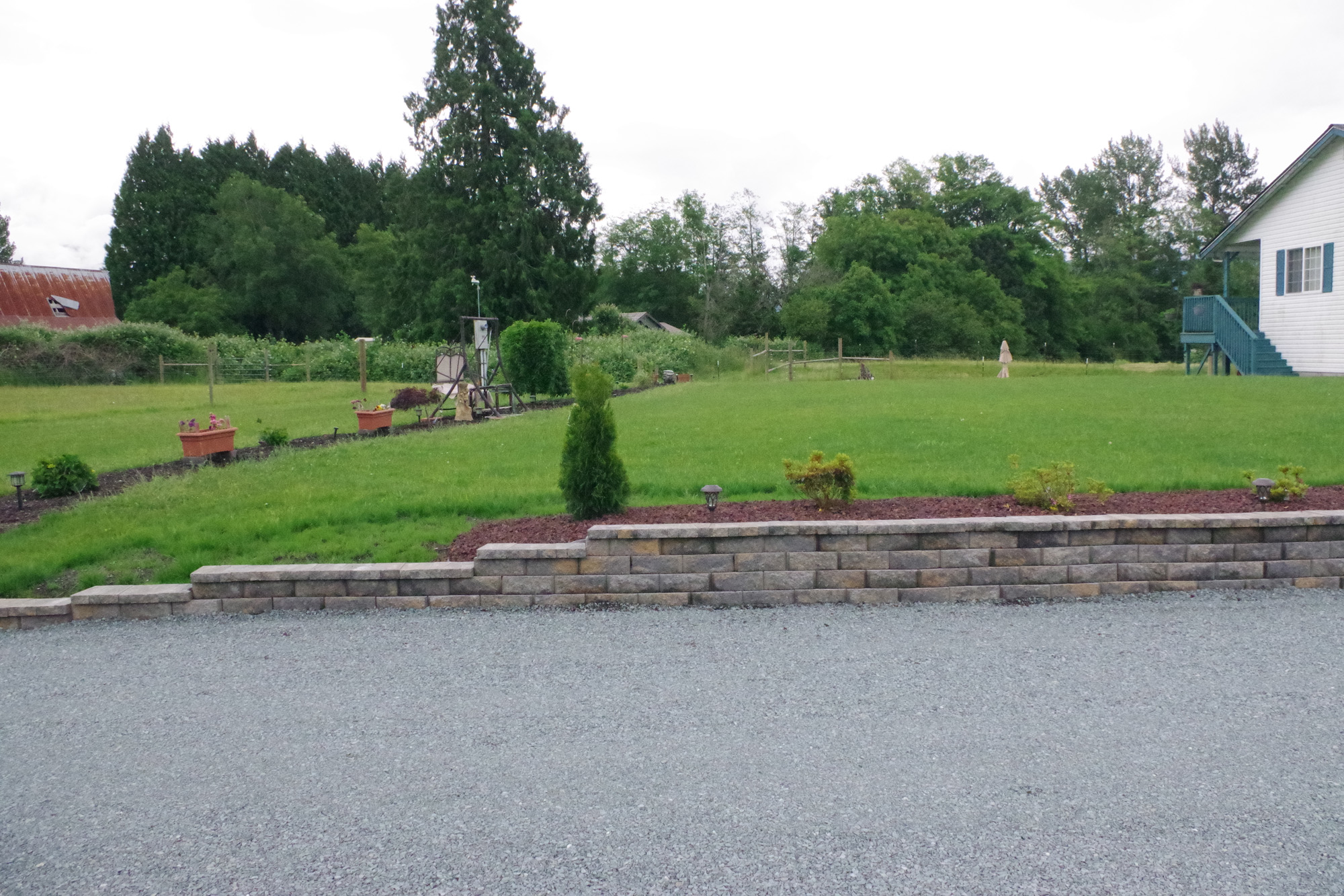

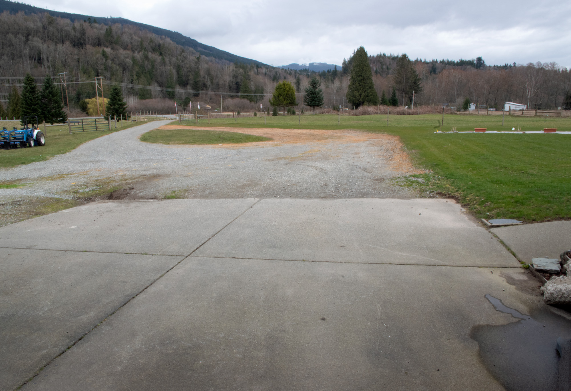

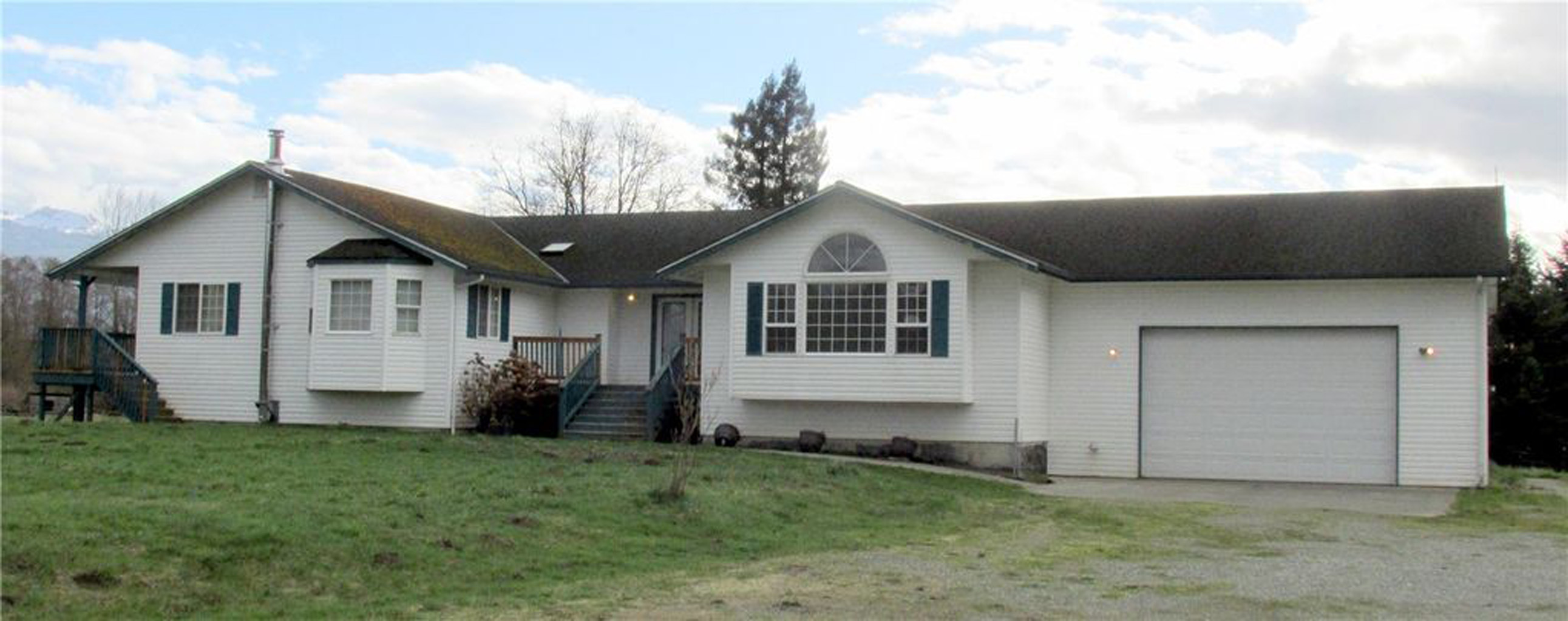

We had started last fall by planting a new front lawn, but with the governors edict our plans for Spring had to change. I,d been considering it for a while so we got started. The first pic is from the real estate ad at the time the home was purchased, the second is this Spring after the new lawn was established. The driveway had a 6 inch rise at about 30 feet from the garage apron. The apron on the left had broken because they had for some reason effectively dammed the water in that corner. Twenty years of driving in on saturated ground had caused the corner to sink about 4 inches. There was a 3 inch hump in the gravel about 1 foot off the apron. When it rained hard there was a 4 inch deep puddle on that corner of the apron.
Using my box blade I managed to move the hump and drag the gravel to places I wanted it. We dug back the grass line and built the little retaining wall, poured a new corner on the garage apron and last week we finished with the new gravel. We are generally quite pleased with the outcome, it was $2700 well spent.
