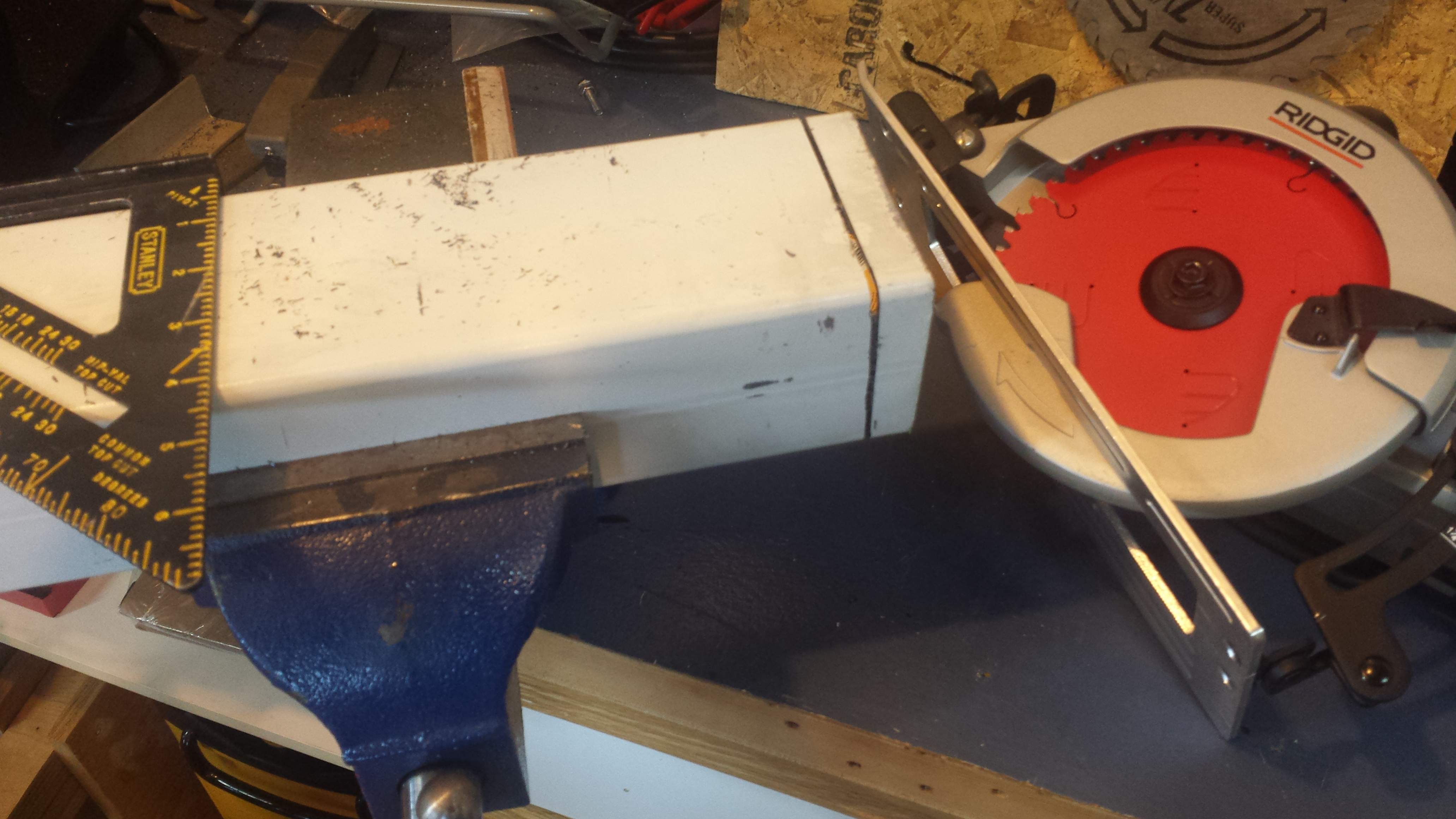

I had a new Ridgid R3210 and decided to try a Freud Diablo D0648F 6-1/2" x 48-Tooth Steel Demon TCG Ferrous Cutting Circular Saw Blade 5/8" Arbor.
Reasoning behind the 6.5" was the tooth speed would be slower than a 7.25" blade, and I didn't need any of the extra capacity.
View attachment 362183View attachment 362184
You can't even tell it's cutting anything on the light gauge (1/8") 3x4 tubing I tested it on, the chips are small and the cut is cold.
Other note is that this is a painted tube, and if you were completing a repair, there is not any heating or discoloration of the finish.
pretty neat. I'm wondering what the cut would be like on a thicker piece such as 3/8"?
   / Steel Cutting with Worm Drive Saws #3
According to the printing on the blades, they don't recommend thicker than 1/8" or bigger diameters (tubing) than 1" -
I'd be interested to know what kind of blade life you're seeing, if you've used it very much... Steve

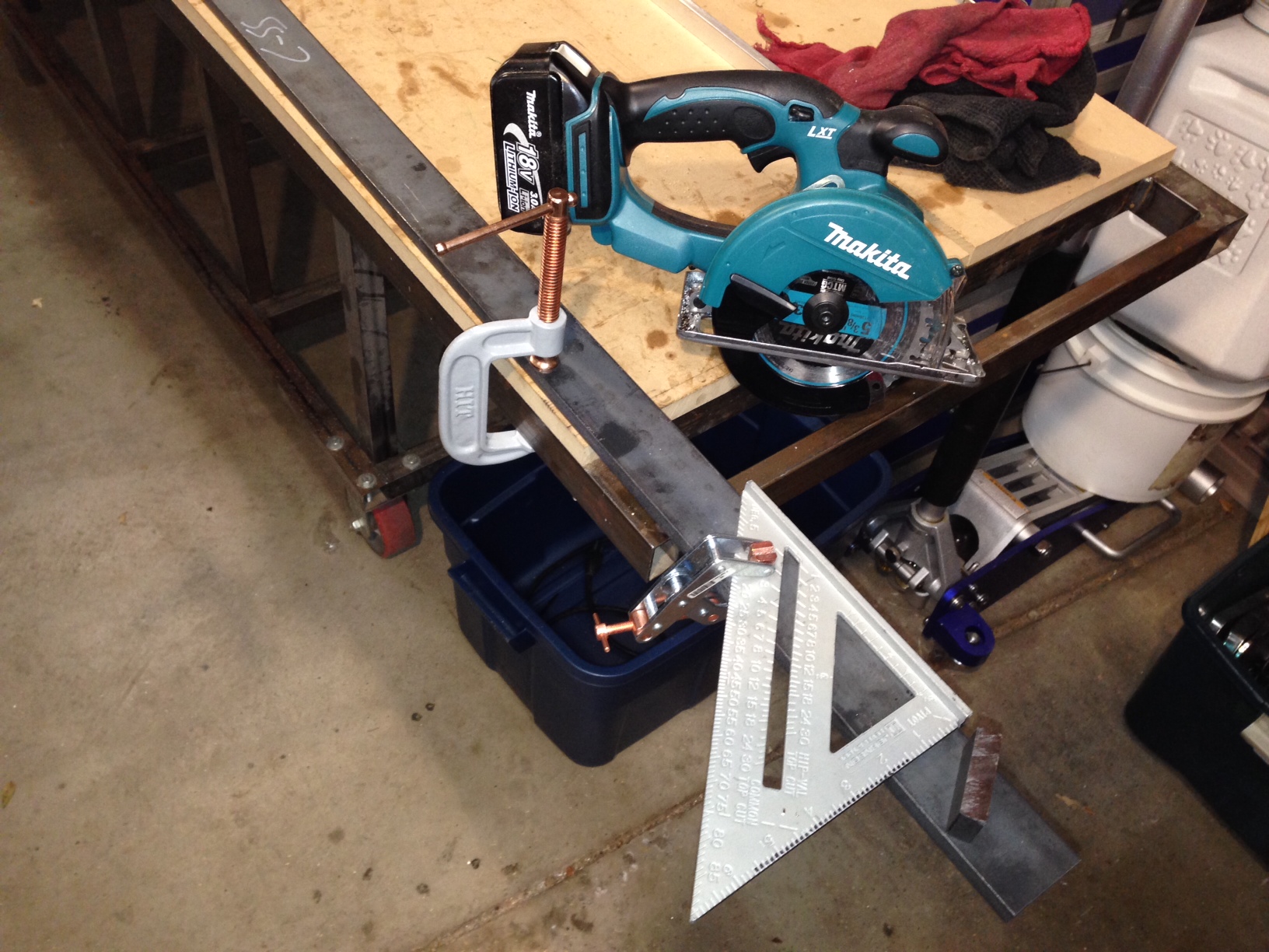

I've used various steel cutting blades in wormdrive saws and had lots of hot chips everywhere. For a while now I have used the Makita saw below which generates chips that are almost cold, and most of them stay in the guard. It cuts 1/2" mild steel with no issues. The battery lasts long enough that it is not a constraint, when it does run low just switch in the second battery. A speed square clamped to the work will give a perfect cut every time.
   / Steel Cutting with Worm Drive Saws #6
OK I have to ask that blade in the picture looks like it is mounted backwards. Does that saw run clockwise ?
   / Steel Cutting with Worm Drive Saws #7
Zoom in. You can then see that the teeth are opposite of where they look like they would be in the smaller picture, and the rotation/blade are all normal :)

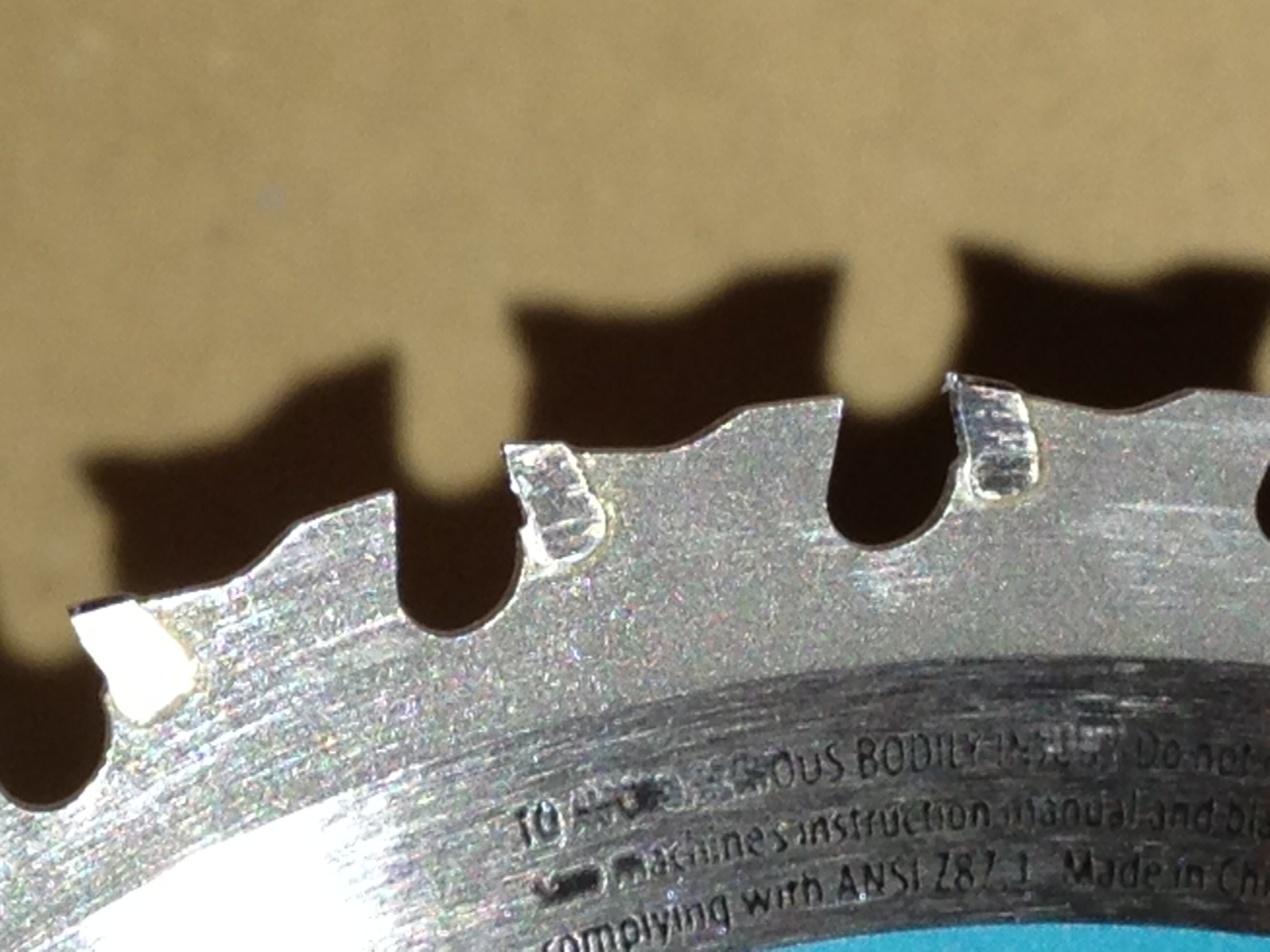

Here is a closeup of blade. lots of negative hook and a controlled feed design. rotation is normal.
