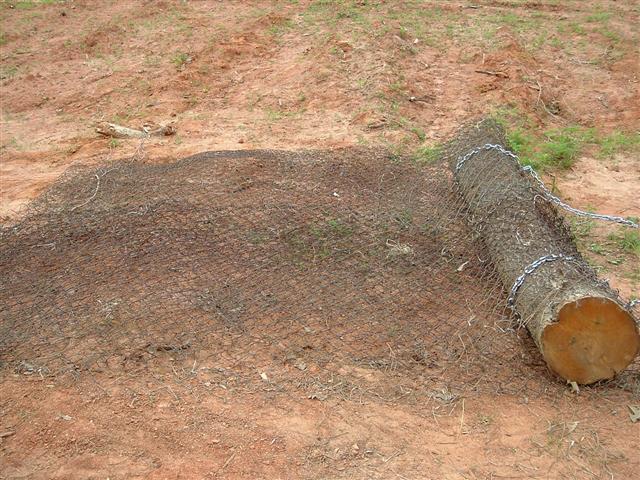

Here's a picture of my log and fence drag. I cut a section of an Oak tree I took out to 8 feet. It's around 18 inches thick. The fence was from a neighbor when I lived in town. He took it down and was going to through it away.
I did buy the chain, so that's my total investment.
It works really good as smoothing out the rough edges in a field and blending it all together.
It doesn't work very well at filling holes or taking down high spots.
I really like to use it on a field before I plant seed in it. After I get all my stump holes filled and take out the high points to where I like it, than I just drag this around for awhile until it looks nice and pretty. I also like to drag it along my dirt roads to smooth them out a little.

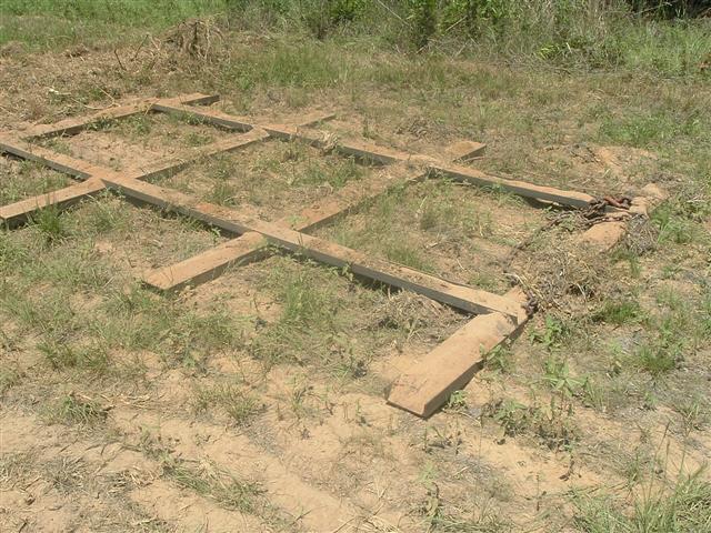

My neighbor had this built to deal his land. When the pines were planted, the land was cut into these valleys and ridges about a foot tall. If you drive with them, they are nice and smooth, but driving over them is a nightmare.
He used C Channel and drags it behind his tractor. First few passes were very hard because of the constant bouncing, but it quickly smoothed things out.
After I took this picture, he said he added some more steal to it to make it more aggressive and now it works even better.
The advantage to this over the log and fence method is this thing cuts high spots and fills slow spots really well.
After seeing this, I hooked a chain onto my pallet forks and draged them around on their sides. They are almost too heavey for my 35 hp tractor, but do a better job of cutting down the high spots than the log does.

We used this type of 'grader'to maintain out gravel/dirt roads pulling iy with an old willis jeep.
To grade we mounted the middle cross pieces at about 25 deg angle to the long pullers with one angled to the right and the other angled to the left.
The angled crosses were also about 12" shorter so that the material would travel from left to right followed by right to left.
The end spillover would be caught by the rear for a final finish.
Generally we'd make only one pass and all the highs would be chopped and all lows filled.
Also to ease the strain on the pulling vehicle we'd loop the chain through an old tire with a second chain to the vehicle.
The tire made for a great 'shock absorber'.
Also we mounted a box for added weight, usually some rocks.
We used that rig for 10 years until the city took over our road but it worked so well that they continued using if for 4 more years.
