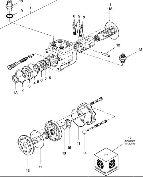

Well; I removed the steering control valve and it is leaking on top where input ( 12 spline) shaft is. Thought I would just pick up another control valve and swap it out and see that New Holland wants $1400.00 + for a new one. It is an Eaton UAS100B08A2d valve. Had no luck trying to cross it to a generic eaton valve. Anyone had any luck?
Dave
   / steering box leaking- what to do? #5
Dave, the steering motor has a seal kit for $146 and you can replace many of the internal parts. Did you miss this on the parts diagrams?

Gerry, the chances of your Kioti Steering Control Box and the one for the New Holland being the same are pretty slim. Are you sure yours is the same? If you are sure, then the part number of the kit I mentioned is SBA334293128 SEAL KIT and can be ordered from a New Holland or Case/Farmall dealer.
   / steering box leaking- what to do? #9
Jim;
I am doing more research but that drawing you provided is exactly the same as the pump I have here.
Will let you know what I find.
Gerry
   / steering box leaking- what to do? #10
Jim;
I removed the pump from the Kioti and indeed it is an Eton manufactured pump per the dwg you provided but when I gave them the Char-Lynn/Eton model number, they say that it is actually manufactured by a Japanese company and the information is proprietary. Man oh man, what a run around. That is the same answer I get from the Canadian Kioto dealer. The service manual contains the strip down and rebuild of the steering unit but they will not provide p/ns. Makes you wonder why you buy this crap in the first place.
