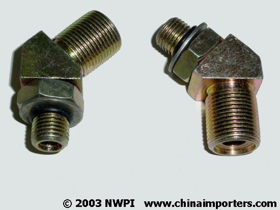

I busted a hydraulic fitting on my steering cylinder. Attached is a photo of the fitting. This is a Jinma 284. Does anyone know where I can order this fitting or can you tell me what it is called other then a steering fitting?

Tommy from Affordable Tractor Sales lists them. I had same thing happen. What happens I believe is when on rough terrian the edge of frame hits fitting and breaks it. Make sure it faces (rotate it)so that maximum clearance is achieved. I've had no problems since I installed new one.
Here is Tommy' link.
Tommys Tractor
