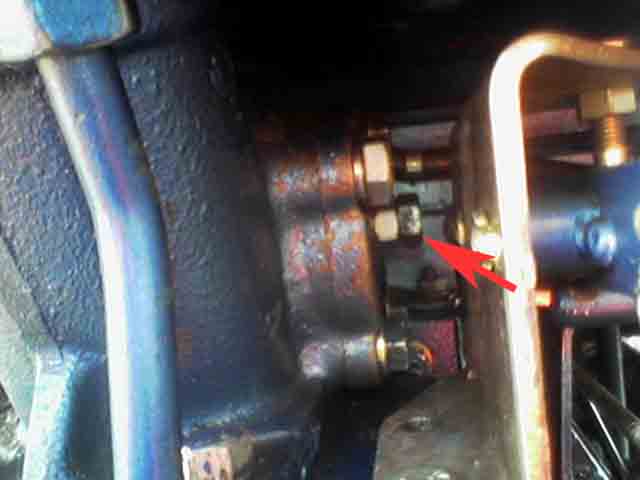

Ive got a kioti LK 3054 XS and the steering column is leaking fluid from the center adjusting screw on the right side.
After one trip around the farm, the screw backs off and the yoke eventually works itself out, from the left of the column.
I've tightened it several times and tried to recenter the yoke only to have it do the same, over and over.
Has this happened to anyone?

the fluid leaks from here. I was able to double nut the adjuster screw so it doesn't back off anymore, and it seems to control the leak some.
is it possible there might be a clog in the hydrolic system.
Also, my dealer won't sell me a parts manual. Is there anywhere I can buy one or see just a sheet of the said parts.

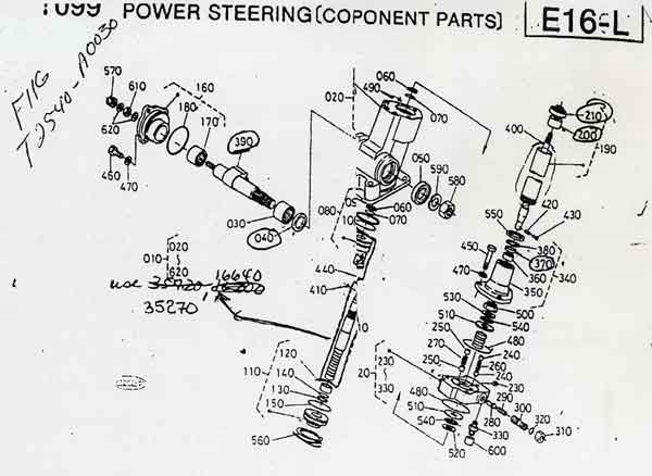

Your tractor is a LK3054 but not the XS. That was what was throwing me off.
That should have been double nutted from the factory. Quite possible that one of them backed off without you knowing? Its been a while since I have worked on one of these, and im trying to rememeber. I do remember if you don't get it tight it will leak. Ok just looked at a used LK3054, there is a washer, then a nut, then another washer, then a capped nut.
I won't hold it against your dealer on the parts maunal. On this breakdown it is not in any part book. I just happened to come across one at one point. The breakdown I have is not 100% complete, and doesn't scan good, but hope this helps.

thanks for all the support. I'm going to try adding another washer and a capped nut to see if that will alleviate the problem.
The diagram was excellent.
