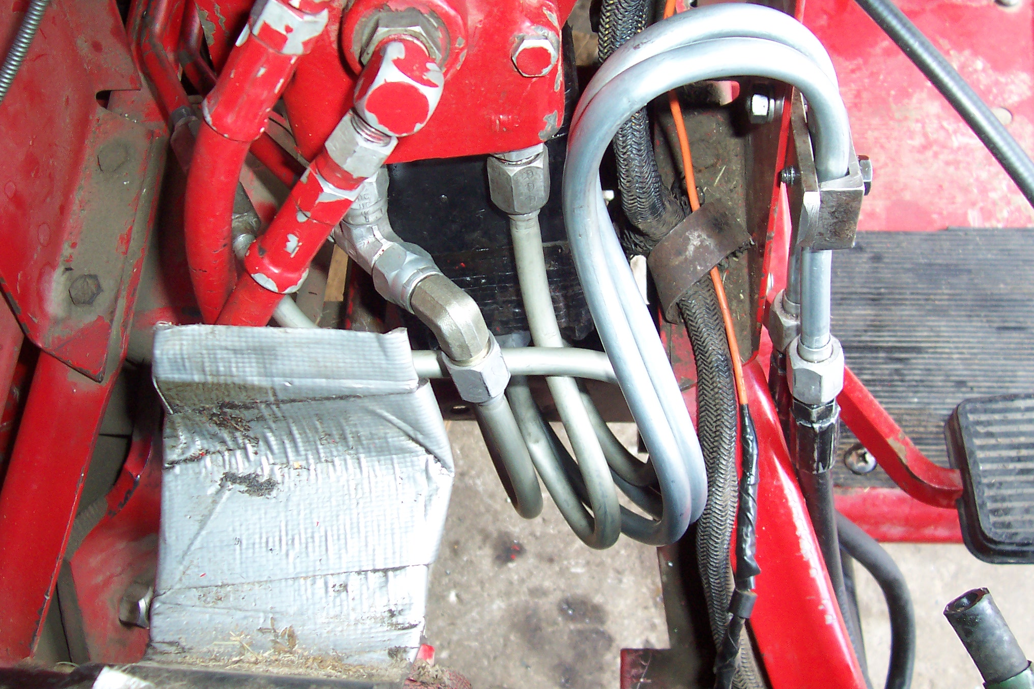

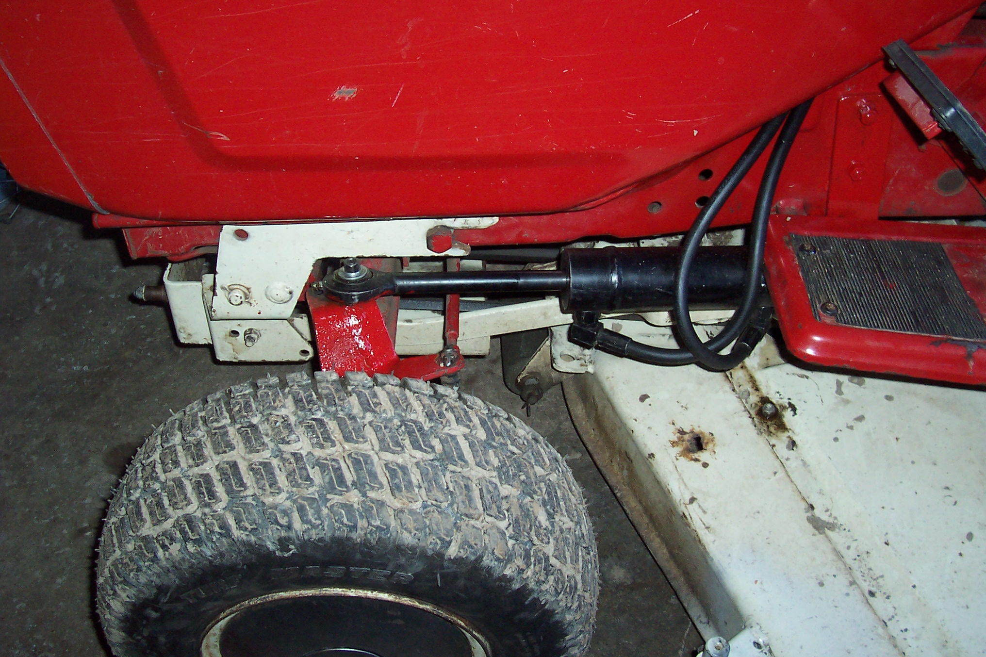

   / Steering logic. #104
yep,
I just was in one of them 3 weeks ago,
trying to figger out if I can get it to have less operator effort.
I snagged it from a 30 yr old J.D. lawn tractor, and put it on an old cub cadet.
But that isn't a priority valve, just a Ross steering control/pump.
I was looking to use lighter springs on the valve plates. But was hoping someone else already did the R&D on that, no sense reinventing the wheel.
It is powered by the charge pump from the Sundstrand hydrostat. just like J.D and everybody else does.
It works well, I just wanted to dial it in a little "sweeter" as I'm kind of picky @ times
