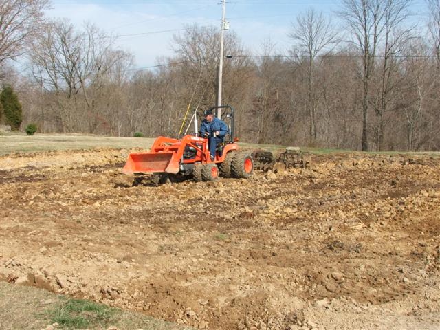

Just got off the phone to the dealer, he said 90% of the time it IS the cylinder, the O ring has probably got a flat spot and I can take it apart and replace the O ring and it is as good as new. That's GOOD NEWS. Since I really do baby this thing :rolleyes: :D I can't imagine something like this happening in just 500 hrs.
   / Steering wanders #8
No kidding Milkman, I don't see ANY extra load on the steering. :)
